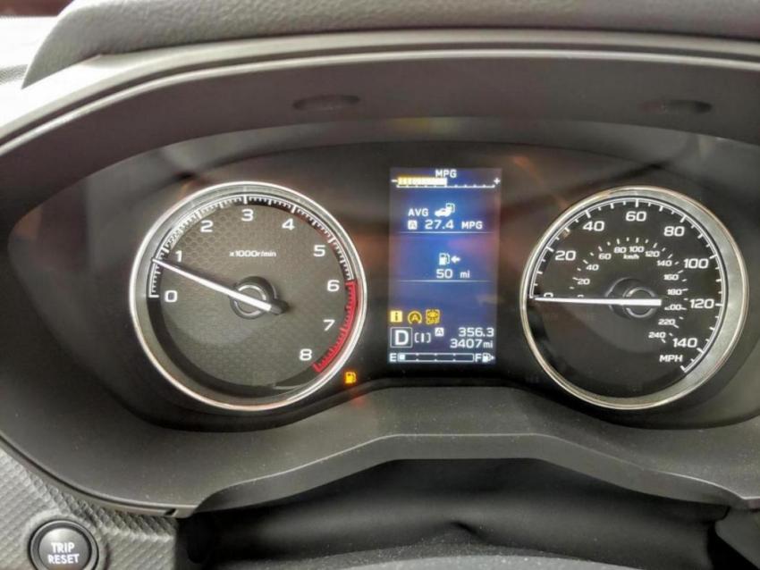

THAT'S NOT TRUE AT ALL (I can also type in all caps to make myself sound more authoritative, but in this case I can present evidence). Every other modern vehicle I've owned (since the dawn of fuel injection) has had a reserve of ~2 gallons after dte=0 or E. Subaru, Ford, Jeep, you name it. It's what I'd call "common knowledge," but like common sense I guess it ain't all that common.
