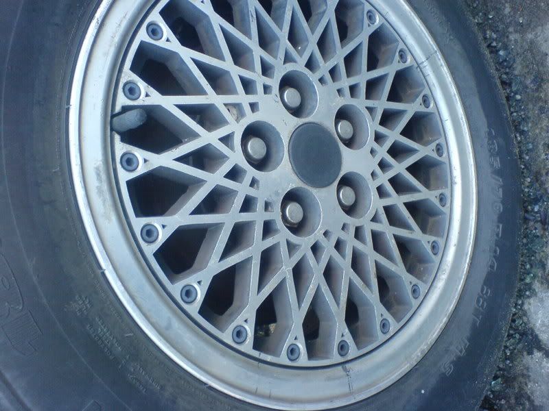

HomeGrown, are there two versions of the basketweaves? I went to the yard today and saw three that still has the honeycomb pattern except with some little black lugnut-looking things on the face of it for decoration? Any clue? Those three were going for $75...I woulda went for them but the fourth wheel would have been very hard to find since I havent seen those around. Besides, it's three wheels!

Here we go guys, sorry for the big pics, they were taken on my phone

They were asking 25 per wheel, saying that they get 22 for scrapping it. What do you guys think, is it a good deal?
7
Number one, they don't get $22 for shredding a 14" aluminum rim. We have a shredder onsite where I work, and a rim of this size is worth roughly $15 (tops).
Secondly, those basketweaves look like the Buick/Olds rims because that's what they are. They're not Camry basketweaves--look at the allen bolt features. I'm guessing the centre caps are blacked-out because someone wanted to cover the emblem.
