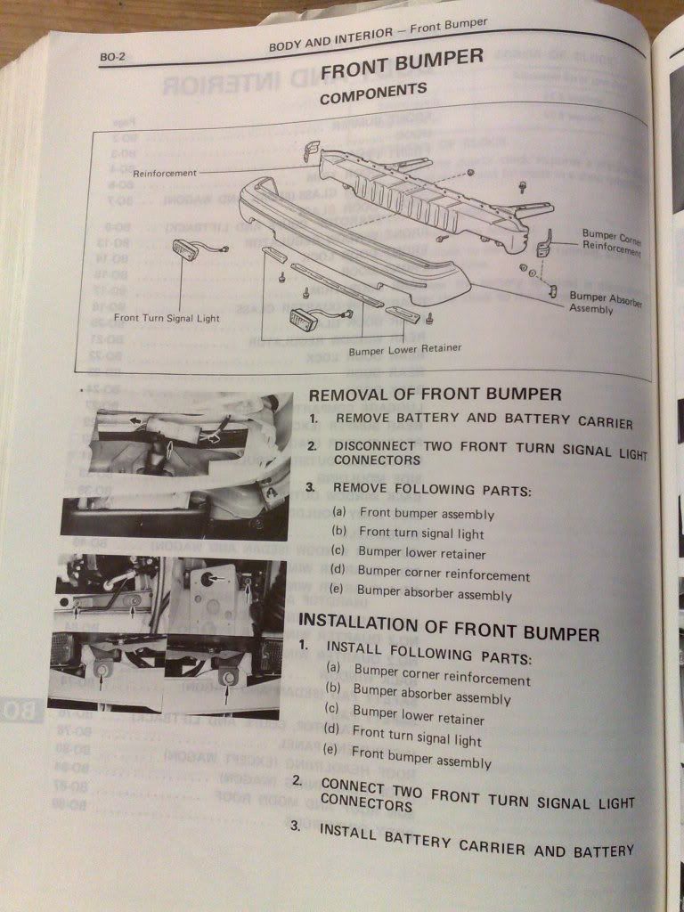

well you can start by taking off the grill, im pretty sure its just 6 bolts that hold the front one on, unplug the signal lights and stuff, you really need to get down with doing it and itll all be obvious to you
thank you ineed to buy A MANUEL
