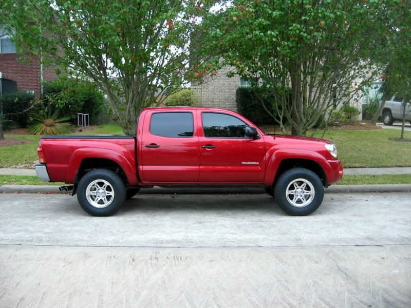

in the wheel well. I am running about 3.3 degrees and my tire still needs to move forward almost an inch to be centered. Not only is it kinda ugly like this, but my tire rubs on the fender due to it. If I could just move the tires forward a little it would be cured. I know some people on here claim that the wheel is centered with TC UCAs, how many degrees of caster are you running to do this? What are the adverse affects to this? I figure I will need about 5 degrees of caster to move my tire enough to clear with no rubbing, do I have this much adjustment with 2.5 of lift. I know the arms are supposed to be good up to 3 inches so I would assume I can go that high with caster? Will I get vibration doing this?
