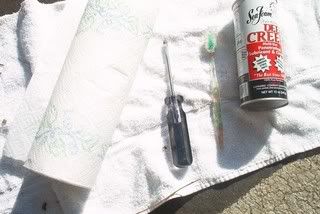

1. All you need to clean your throttle body, old toothbrush is nice to have here but not essential, you can do it with rags or paper towels if that's all you have. The Sea Foam Deep Creep is a good product and said to be safe for the I.A.C.
NOTE: I've read posts from other people that killed their IAC valve using other products such as throttle body cleaner, so use a comparable TBI cleaner or carb cleaner only if that's all you can get at the moment.
