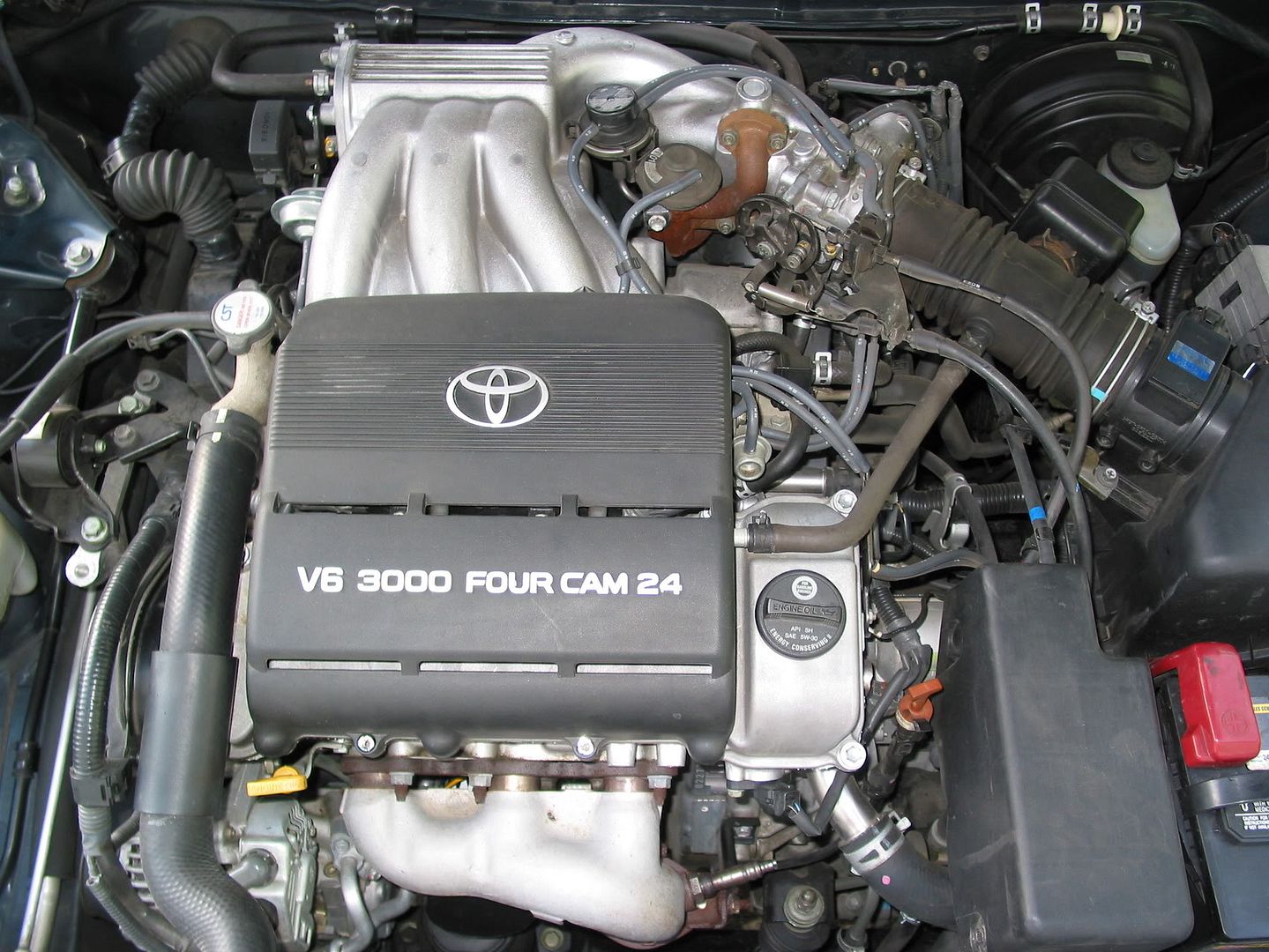

Perhaps there's a misunderstanding here. . .
The plastic V-bank cover vs the valve cover? The V-bank cover comes off after removal of the two hex cap nuts and pull towards you and up. The Valve cover need not be removed.
As you pull the cover towards you two spring clips will disengage. You'll see once off.
V-bank On. . .
V-bank Off. . .
V-bank On. . .
V-bank Off. . .
Thank you for the picture and the detail.
Mine is not the same as yours. It is the same as the link as I gave in the first post.
But I think they should be the same to remove it. I will try yours.
