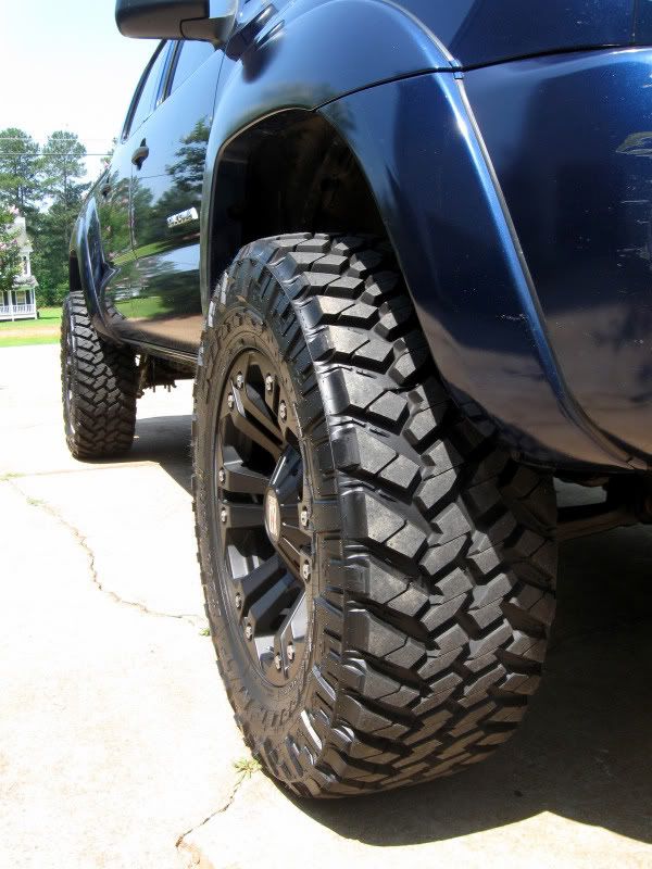

Idk if this helps, but here are my Monsters 18x9's 4.5 backspacing -12 offset. They also come in a 5.5" backspacing which wouldn't stick out so far.

What tire and size are you running?

They're 285/65's

Couldn't help but notice you have the Trail Grapplers! I've been looking at these for a while. What do you think about them so far as far as wear, road noise, on road/ off road performance? Not tryin to hijack the thread, so maybe just PM me if you get a chance :thumbsup:
