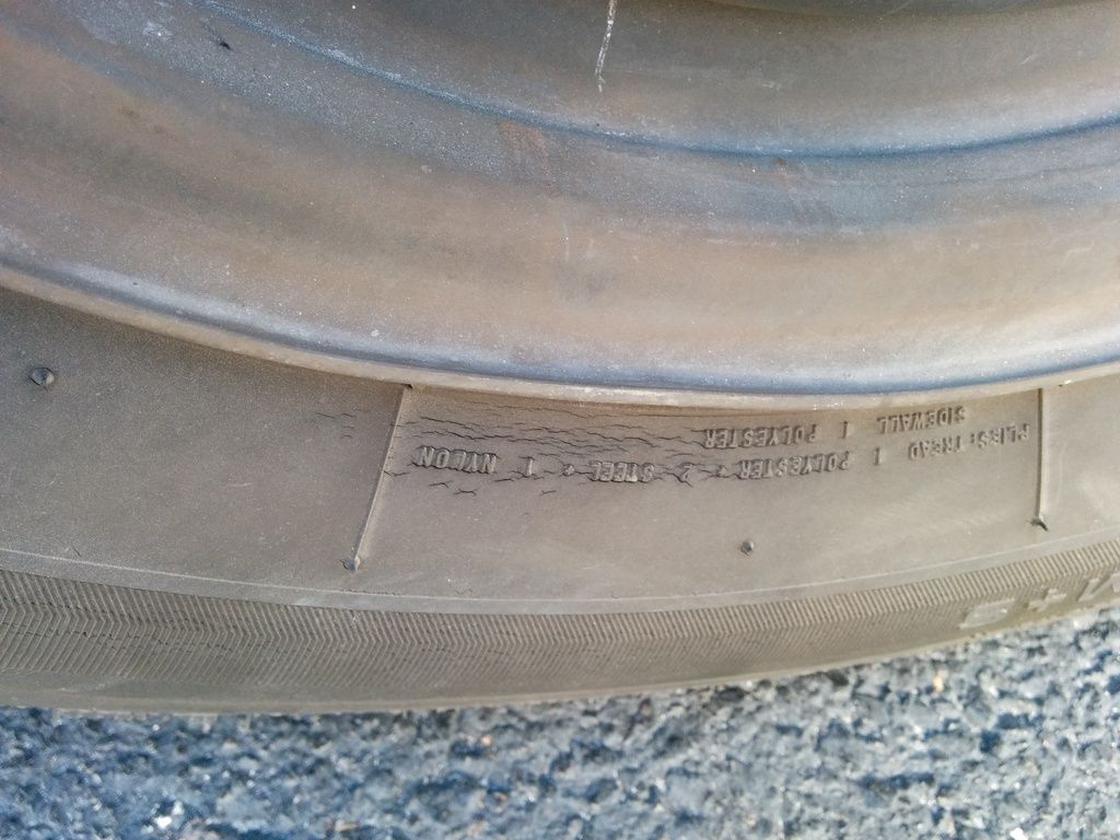

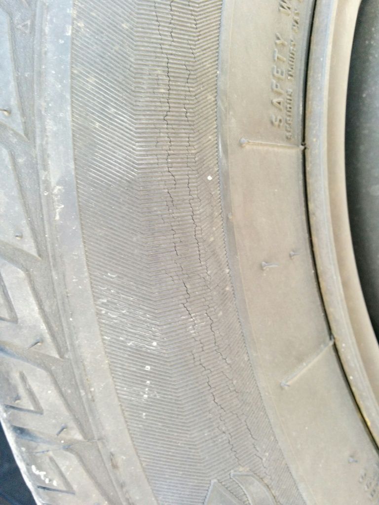

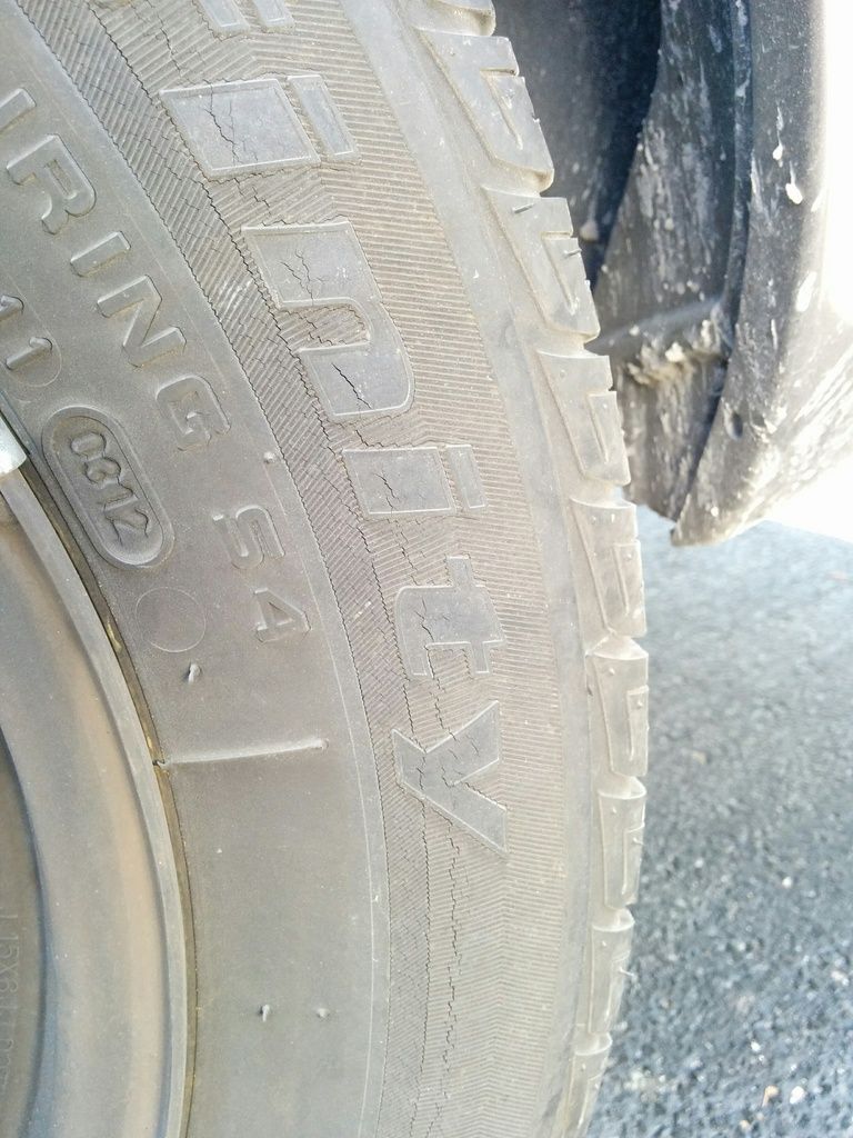

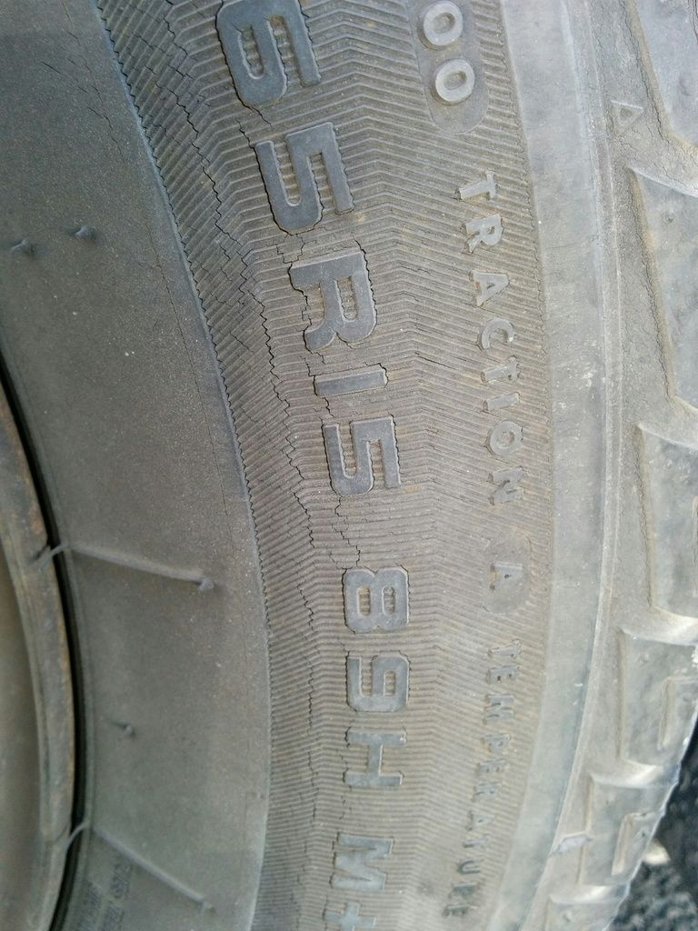

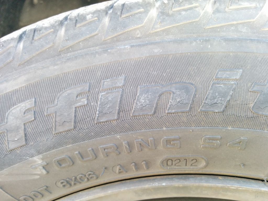

Attached pics would convey all my concerns about the current set of tires. All tires are quite similar except for the one pic with the cracks near the rim (on only one tire). Tread depth is about 4-5/32 have a mileage of about 40K miles on them. Date of manufacture on tires is 0212 / 0312.

5 years and a zillion heat cycles is pretty much the life of tires. Cracks in the sidewall rubber always concern me. It means the elasticity is gone in the rubber, plus, 4/32 isn't much tread in wet winter weather.
I would not hit the highway on those, but around town they would probably make it through winter... If you can swing it, I'd recommend going new.
