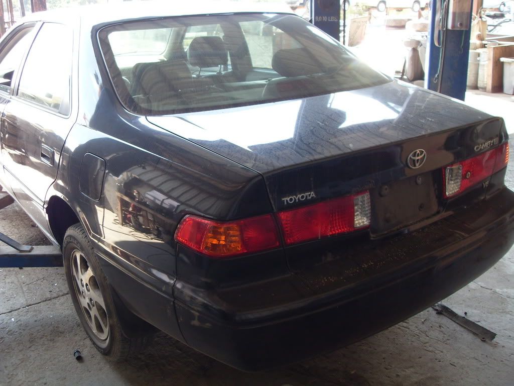

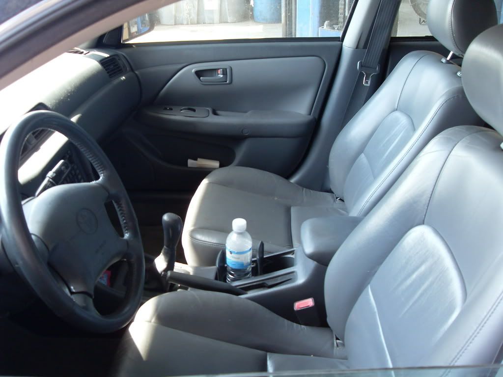

Picked it up two days ago. 2000 Camry V6 5-Spd LE. All the amenities, JBL CDs, Cruise, Power Leather, Runs Super Nice with Ice Cold A/C. With the V6 and the manual gearbox this thing really moves.

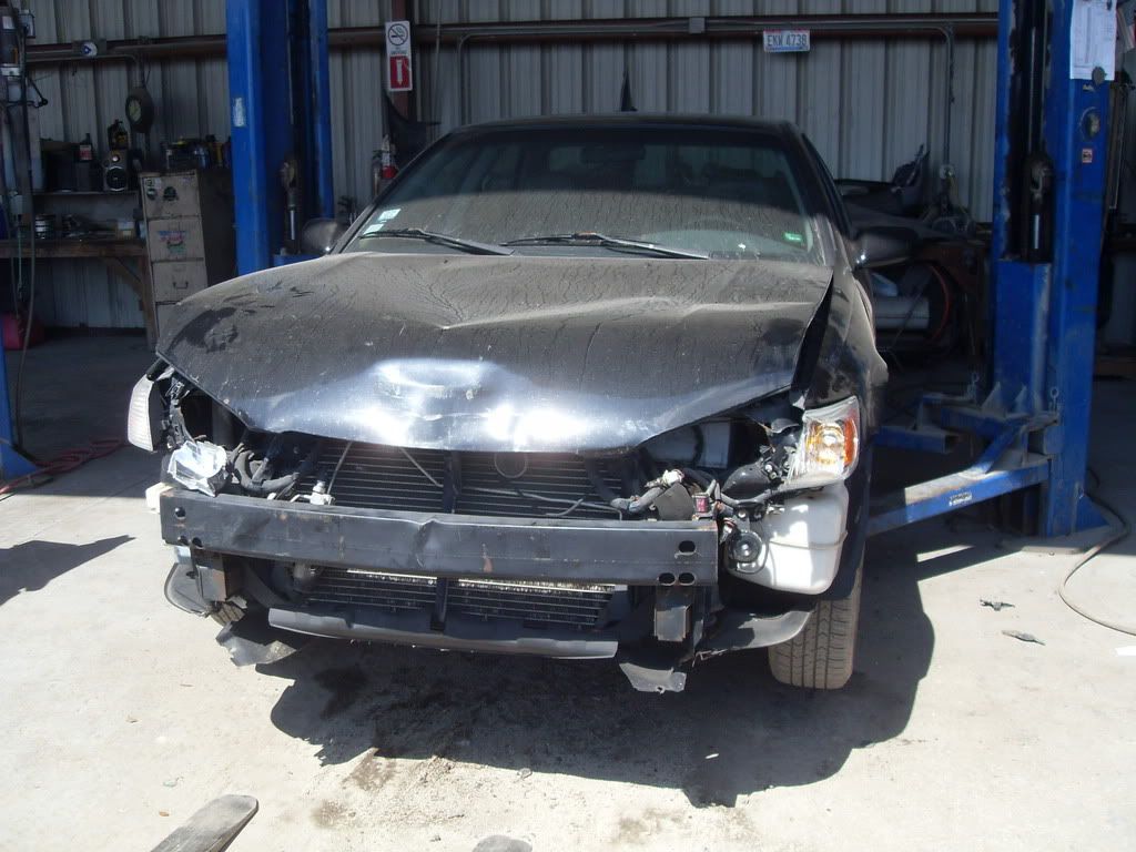

Light front end damage. Nothing really broke besides swappable sheet metal. Rad and condenser are clean. I ordered new hood, fender, headlights, parklamp, bumper and grille. I have to pull the core support out a bit, only about 1.5"-2" though. Straighten what's not, and bolt the new stuff on. I couldn't pass up on it, the deal was too good.

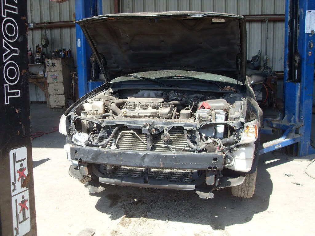

Bad fender off, new hood on, along with all the clips, washer nozzles, under hood blanket and washer hoses.
As of this afternoon, I got the core support 75% completely where it needs to be. After that I will hang the new sheet metal and lights.

Finished.
Cores Support stretched and back in place.
Headlights mounted.
Park Lights mounted.
Hood mounted and lined up.
Bumper Cover, Reinforcement and Support mounted.
Fender lined up and mounted.
Valvoline 5w-30 Synthetic Blend with OE Toyota Filter
K&N Air Filter
9005 Mod for Highs and Lows.
All I need to do is get the sheet metal painted and I'm set.

Yes, I did the core straightening. I used my Toyota forklift as an anchor and ratcheted it back in place little by little. The hardest part was getting the hood to line up. I still am a little displeased with the way it sits. I will still try to get that aligned by the end of the weekend.
