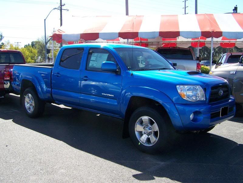

I'm picking up an '08 SWB DC LB 4x4 in the very near future, got to sell my '88 Porsche 911 first though :sosad: at any rate I can't live with Grandtreks and want to replace w/ BFG All Terrains ASAP. What size can I go with that won't rub or cause damage? I had 285/ 70 / 17 BFG All Terrains on my '05 Dodge 2500 Cummins Diesel and like the look of those tires but don't think they would work on a DC Tacoma without a lift or spacer kit?
Truck I'm working with right now :D

On the sport, a 265/70/17 tire is the largest that will fit without rubbing (stock is 265/65/17). I just made an appointment to get my Bridgestone Revos in that size for Friday in replace of my Bridgestone Dueler H/Ts that are worthless on snow. I can't wait to see my truck with new shoes!

Wasn't the news I wanted to hear, but thanks for the heads up. Can 285/ 70/ fit without rubbing via a level kit or slight lift?
