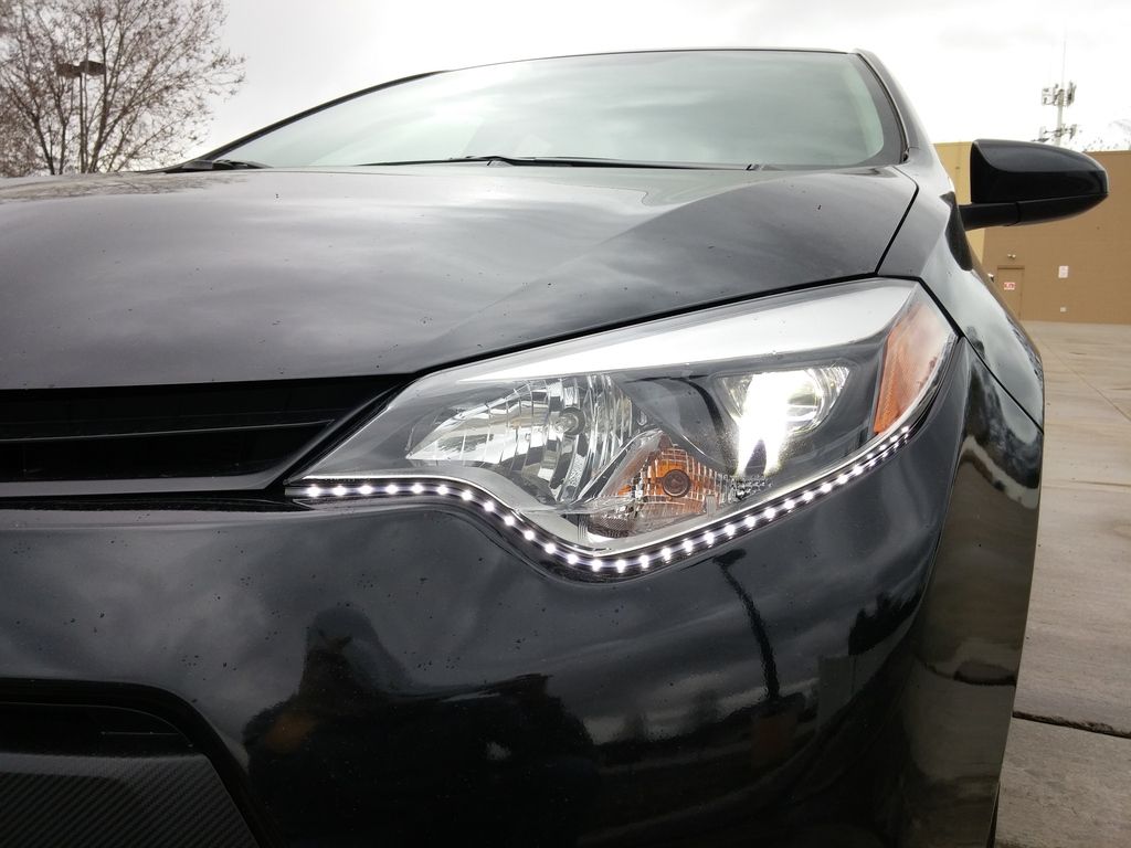

The LED strips will look like this when you stick them on.
Daytime ( Much Brighter In Person) Headlights on full "ON" position.
Night. ( Hard To Capture )
When off you can barely see them.
