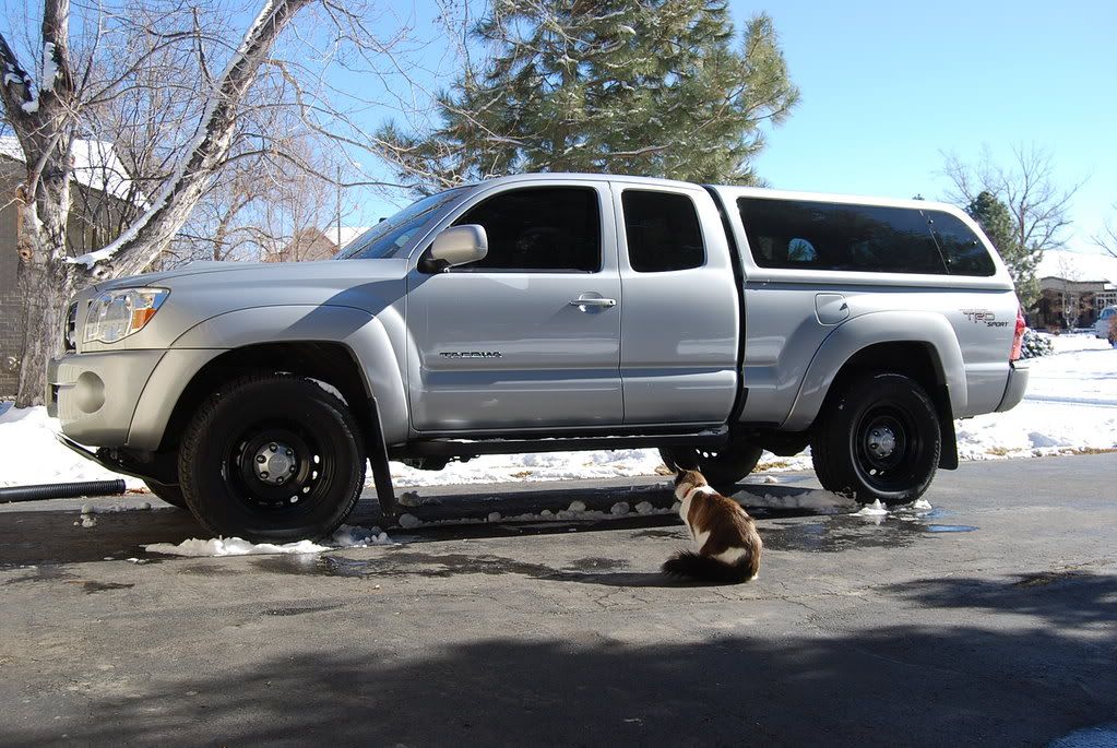

and... i provided a picture of the so called uglyness... so it kinda speaks for it self eh?

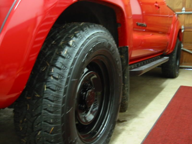

The FJ 17"steelies are offset about 3/4" to the outside compared to the stock Taco wheels both alloy and steel. So there is a lot more clearance than stock to the uca's.
I put them on my 07' with 245/70-17" snows. I'll try and post a pic. They look good with the current 16" steel wheel centers. The FJ centers suck, very poor design for fitting and don't look as good IMO.http://i213.photobucket.com/albums/cc62/dan

I've got revos on FJ steelies for the winter months. Great fit and they look good IMO.
