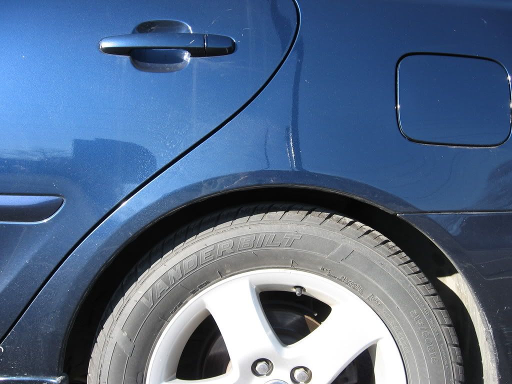

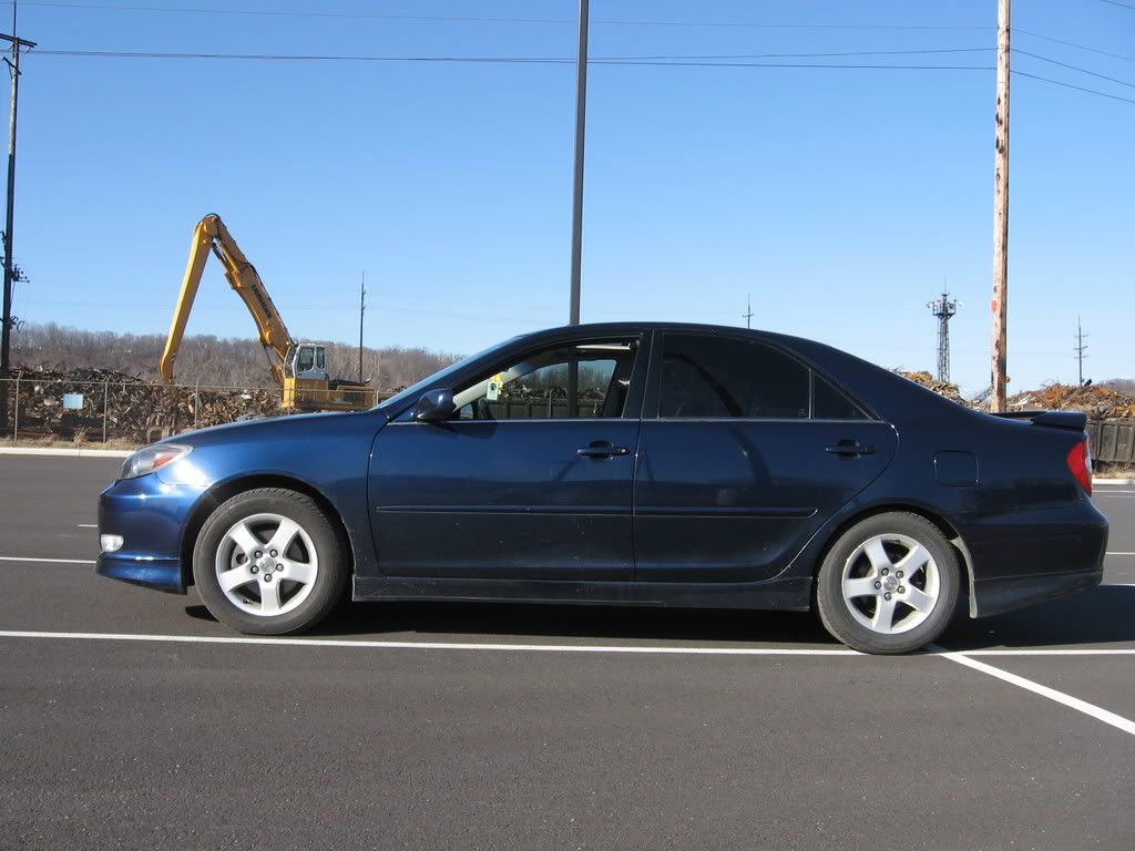

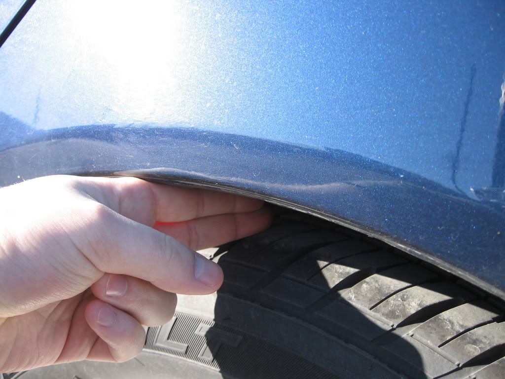

So, I was going to go buy my Eibach springs for my 2002 Camry se v6 today, but I started worrying. My car sits lower than any other Camry I've seen, and I'm woried that when I lower it, it'll be TOO low, and I won't be able to fix any rubbing issues. I really want to go low, but i don't want to go too low.......I had told myself that maybe the stock rear springs were sagging, and the new ones would be fine.....but I'm worried..
Here are some pics.....let me know what you guys think....I need all the opinions/advice/help I can get!!!!
1,003 Posts
if it sits lower than any other camry, it means your existing stock springs are sagging, the point here is that you are replacing the springs.
Once you put new lowering springs in there, it will give you the proper, corrected, desired height, as springs are the components of suspension that will determine your height.
I'm lowered on eibachs as well, the pro kit (which i would recommend for you), and you will be fine.

Yea your rear end is sagging some..but the lowering springs shouldn't bring it down too much more, if any..with the way it's sitting now..the front will come down. Depending if it's a 4 or a 6...will depend on how much
I'm lowered on Eibachs as well...no problems and not super low

yeah, if your springs are sagging now the lowering springs wont bring it lower theyll just reset it to the way it should stand.. looks like youve got to replace the springs anyways, might as well get aftermarket ones
but you could just look at it like you got your car lowered for free:whatwhat:

thanks a lot guys.....i was thinking/hoping it was the springs...the car does have just over 101k on it!!!!but i just wanted some other opinions.....
and yeah...the back i think looks pretty good now, but the front = shite...
so...i'll be purchasing springs tomorrow then(and a fender roller sometime next week)..thanks for your input guys...this is why i love this site....i've been here for over a year....and its great to be with some people who actually like the camry, and actually know a little bit about it....
