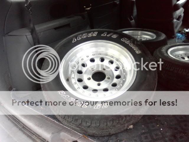

Ok I have an interesting problem and yes I did hit up the search button to no avail. A family member of mine gave me a perfect set of alloy truck wheels.
Anyway the bolt pattern is right but my lug studs are about 5-10mm too short. :headbang: I have no idea what to do, I'm assuming that I can get longer studs but I have no idea where.
EDIT: I forgot, It is going on a 89 Pickup 2wd 5 lug obviously

I put ARP studs on my 1994 2WD. Not cheap at $160 for a set of 20. I found this link during my search but for $3 per slightly longer stud I felt safer just buying the ARP's off EBAY. I cross referenced all of the part numbers with several sources and the part numbers / sizes are the same for the 1989-1995 as it is for the Tacomas.
http://www.hunt4steve.com/05TacoExtLn.html

Nice wheels, I got a couple sets for my truck. Seem to be a dime a dozen around here.
Make sure you get the right lug nuts with the proper shank for your wheels.

You need to get the correct lug nuts to go with those rims.

That link is a godsend thanks :D
What lug nuts do you all recommend for these guys, I have some off a lexus SC400 that seem like a pretty solid match.

Thats what I was going to do was throw my stock lugs on and run it up to the tire shop and find out. On a side note I cannot for the life of me figure out what brand or model of wheel those are, and there are no markings. They seem solidly built but thats all i know.
