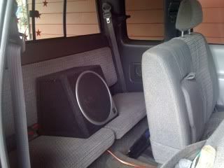

-Maybe come up with something more clever to do with my sub....

I decided to replace the back speakers with some 6X9s
I picked up some infinities from best buy
Decided to use the stock boxes from the SR5 package that I found in the truck. Looking back, It probably would have been easier to just cut out some boards... but I thought that since Toyota put the speakers in boxes, maybe there was a reason so I should just keep them....
After the box removal, I put some Dyamat around where the speakers sit. I didn't have a plan really, just try to cover as much as possible (especially on the outer part) and not cover any important holes.... The foil on that stuff is sharp.. who would've thought.... cut my hands up on it :(. You can really hear the difference where I put the Dynamat on the areas where it contacts the body sheet metal when I knock on it from the outside. I hope it muffles the sound as well from the inside :)
Then I went to work on the boxes. Used a rotary tool to cut out the holes bigger so the new speakers would fit.
Then I cut off all the random protrusions I found on the inside of the box that were blocking the speakers from fitting in properly
I then covered the inside in Dynamat
Then Dynamat on the outside...
Then speaker install! And again the mini washers came in handy... The box is not smooth and is shaped kind of oddly and the hols happened to fall at a low spot... so I just put some washers on to make sure everything was tight :)
Im hoping to actually get the speakers in my truck tomorrow, get the side panels back on in the back, get more sound matting down, and get the new carpet in tomorrow :)
