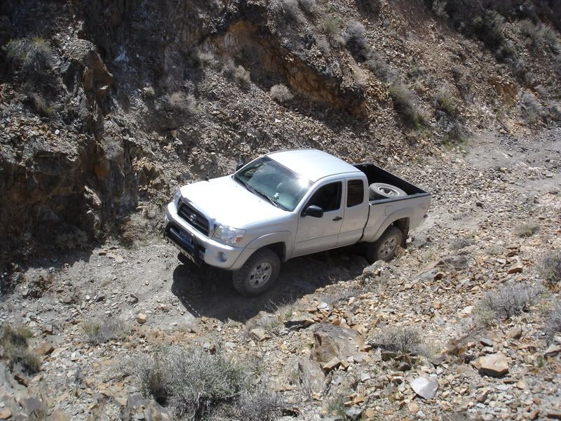

I wasn't able to make it before, but someone shifted some rocks around and I got the lift and I made it with no scraping at all.

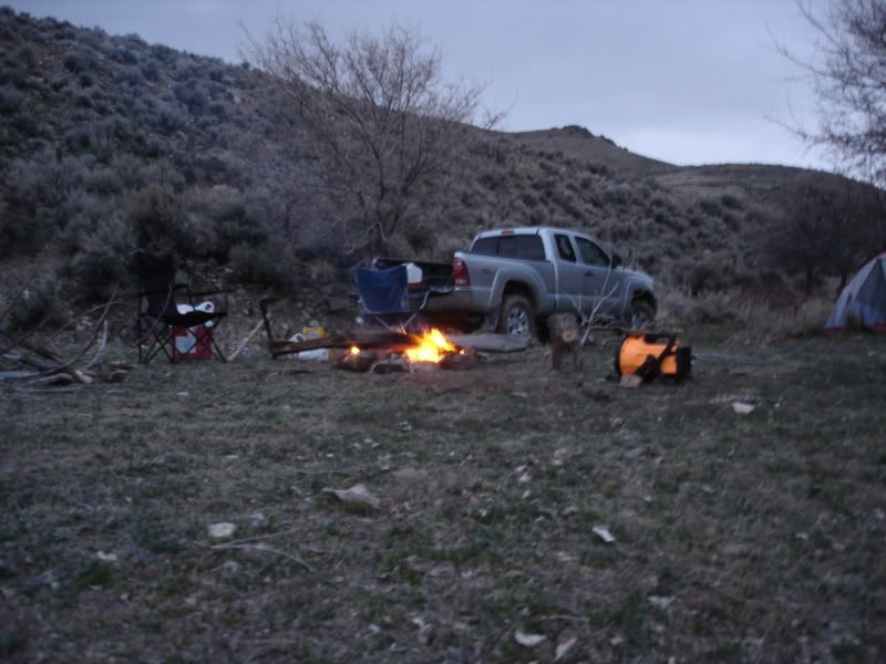

Camping trip this weekend, on the way home ran into about 100 of these sitting on the train tracks.
I never realized how massive they are. Much bigger in person.
