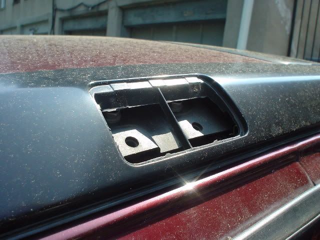

Could you do a photo close up of where these racks actually interface with the roof? That'd be cool-

A'right, here's a sequence for that roofrack. The aluminum leg (2nd pic) was machined by a friend and i did my best, amateur way to label it w/ this here pc program. I then shaped it a bit to my liking and painted it black. Finally, I fabricated a rubber piece ( lifted by hand on pic 3) to cover the screws. I used the bolts and other mounting pieces that came w/ the cross bar to bolt secure it on the leg. It should be straight forward and easy to figure out. Also attached, is a pic of the stock roofrack (silver previa) for dual sunroof model that I've been trying to find on-line. A collective search might give us better luck. Please let me know if anyone of you find one for sale.

I love the photos of the rack especially the brackets. HOWEVER, I cannot find the bolts that attach the rack into the roof. Toyota has them discontinued. As best as I can tell they are metric 5 mm x .75 pitch by 10 mm long. Where did you find those cap screws???
