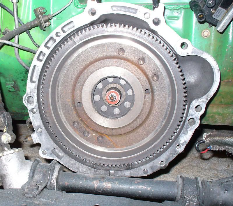

Had just finished the tuning and on the last run it lost all drive to the rear.
Thought it had buggered the clutch, as it was the same clutch that had been built for the 1600 motor, but when we stopped the motor and tried to re-start it found it wouldn't turn the motor over, just spun the flywheel.
and here was the reason why,
They were brand new flywheel bolts and had been torqued up.
So I had extra dowels fitted and installed ARP bolts along with a new flywheel.

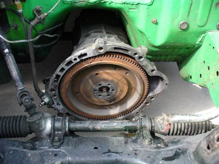

but first race this season, after it had done a few events and had a retune to now run 325kw/440hp atw, there was another flywheel problem.
This one was a bit different though,
The flywheel was a std toyota unmodified flywheel, so this is still a bit of a mystery,
but I like using the excuse of too much power, lol.

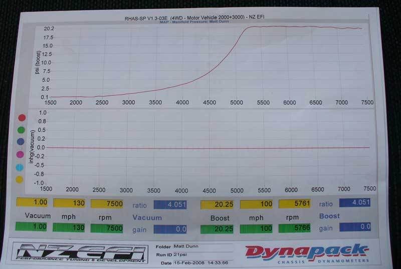

Here are some copies of the dyno sheets for the final tune anyway.

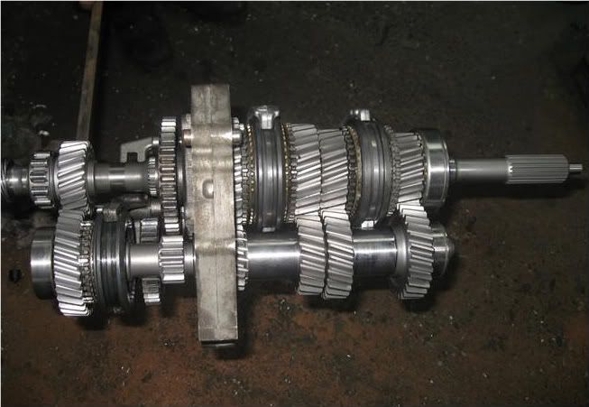

Well with 500hp and bigger wheels and tyres for more grip,
it's at the stage where W series gearbox's are just not lasting the distance.
When run hard at full power they seem to last less than one race weekend,
so after needing 3 boxes in 3 weekends I have been searching for something more to hold the power, without have it feel like a truck gearbox, or costing 3 x the value of the car.
I have come up with an aftermarket gearset for the W series box that should fix all the problems, and have the advantage of being a really close ratio box.

Also R154 gearboxes change gear like a truck, and weight too much,
so have stayed with what we have,
and have come up with a gearkit to suit.
Here is a picture.
It's a lot stronger, and close ratio, and not a lot more than converting to R154.
