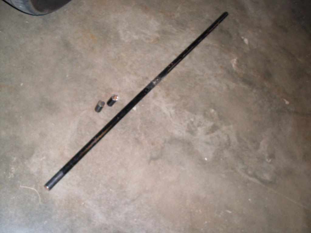

Here’s my custom made strut brace for my 2001 Camry I want to shared with TN.
I spotted a strut brace from an early MR2 at the salvage year. (Hard to tell when half the car is gone) It's might be an aftermarket. The bar was too short but the mounts were very close to the Camry gen 3/4 strut towers but the left mount had to be on the right and vice-versa. I got both mounts for $5.
Next I have to elongate the holes and grind down and bend the mounts to prevent it from touching the hood. I would run a piece of chalk on the top of the mounts and gently close the hood. If it touches the hood, it’ll leave a chalk line on the heat shield under the hood. Also, the kick-down cable had to be lower slightly to clear the bar. (You can see the zip-tie of the mock-up brace, the "R" stamp on the left side, and it was paint silver at first)
Next I got some thick steel tubing $4 and cut them to length. Tack welded them on the car. Don’t forget to unhook the battery. I took it off the car and fully weld it and grind the weld down to get a cleaner look.

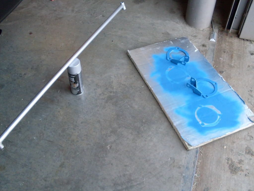

I then got some engine enamel paint and paint the mounts blue and the bar silver, they dry fast. I inserted some metal sleeves inside the bar ends to get it a tight fit with the 1/2" bolts.
I went to the slavage yard and go some Solora strut mount nuts and washers because the camry nuts were too tall. (btw, the solora bar would work but it's too tall and would bend the hood up slightly, I checked on TN already) I torque down the mounts on the strut towers to spec, 59 lb. ft. and crank down on the two strut bar bolts and nuts $2.
You can see it clears the throttle, kick down cable, pcv, and oil cap. Clear the hood too, bearly. The spark plugs might be a bit hard to get to. You can see how straight the bar is.
Appearance: The blue and silver paint looks good not too out of place thans to the NKG wires. It was also my first welding job so there are some small pin holes in the bar but it's a strong weld. the bar was two piece weld together in the middle so it's not perfectly smooth but it's straight. The mounts had "L" and "R" stamp onto them and my attempt to use JB welds to fill it in failed. I can see them through the blue paint. Overall, I'll give a B- on this project.
