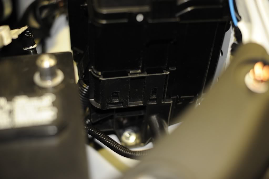

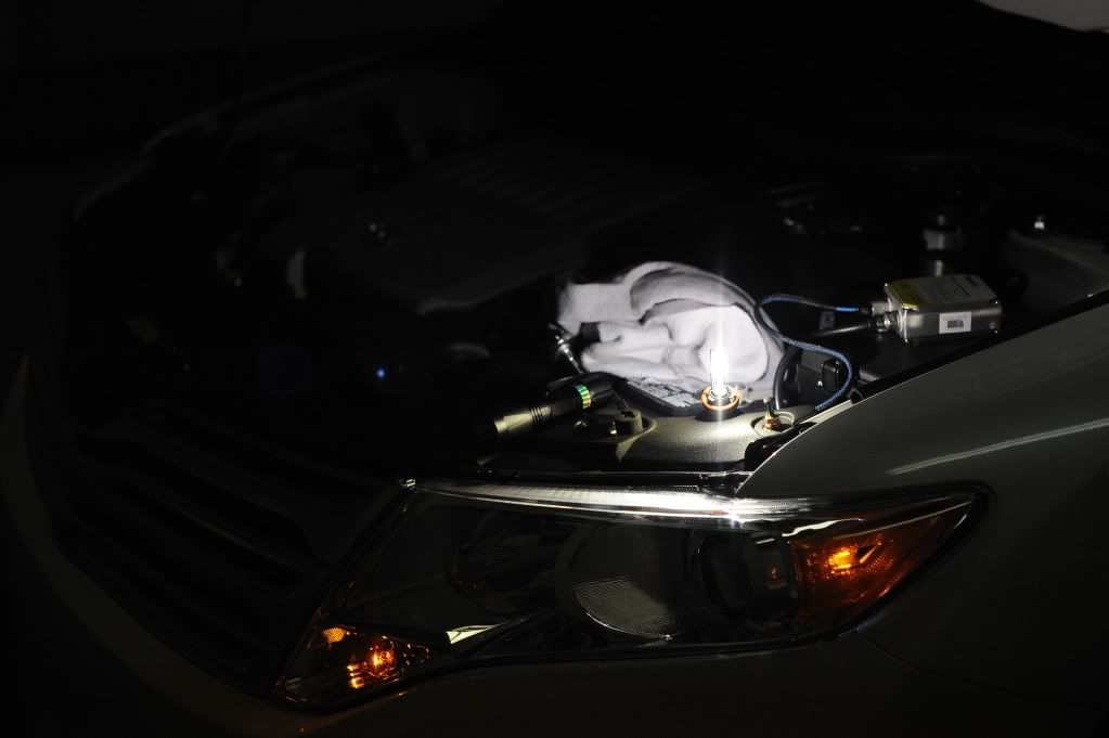

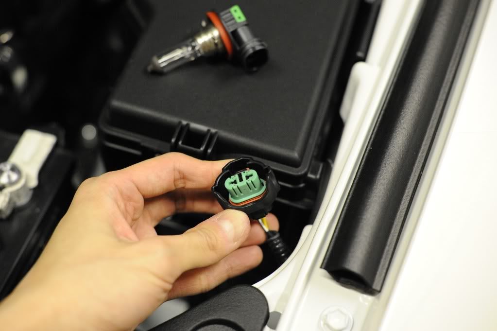

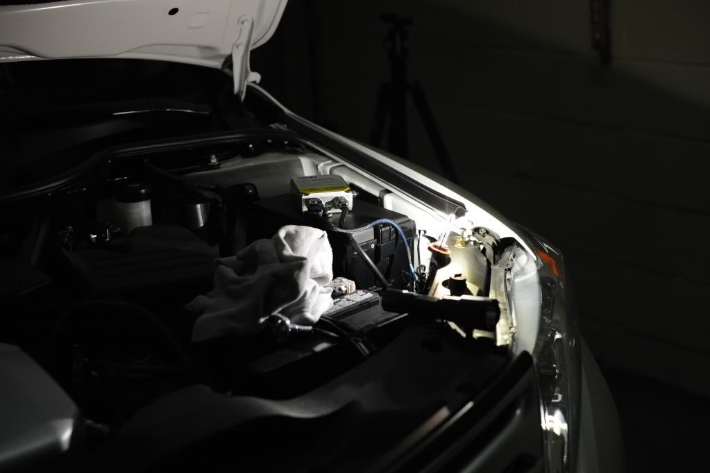

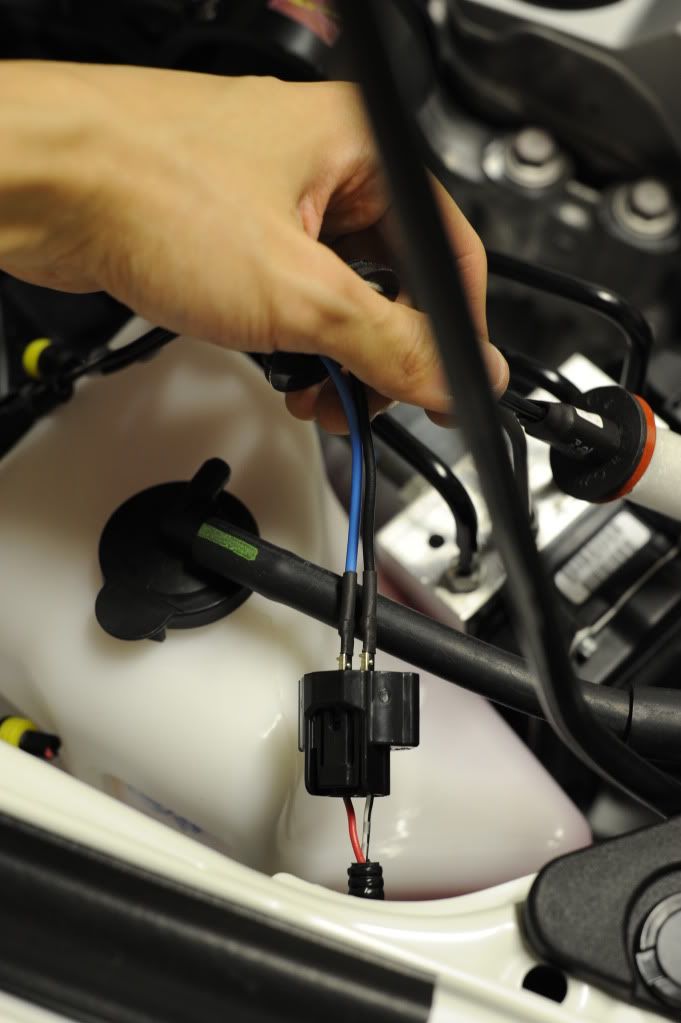

The original plug and light bulb detached. Noticed that there are yellow wire and black/whit wires on the driver's side. On the passenger side, it is red and black/whit wires on my Venza Later on it is going to be connected with the HID kit

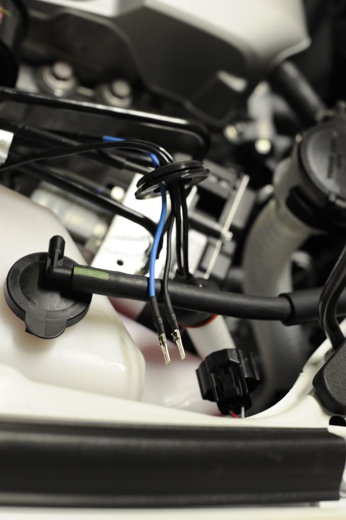

The blue and black wires are from the HID kit. They are going to be pluge into the green socket.
Notice that the blue wire should align with the color wire of the green socket. In this case on the passenger side, it is a red wire. The black one goes with the black/white wire. I use black wire to secure this from detach apart. For other wires, they all have specific shapes, just plug and play, you can't go wrong.

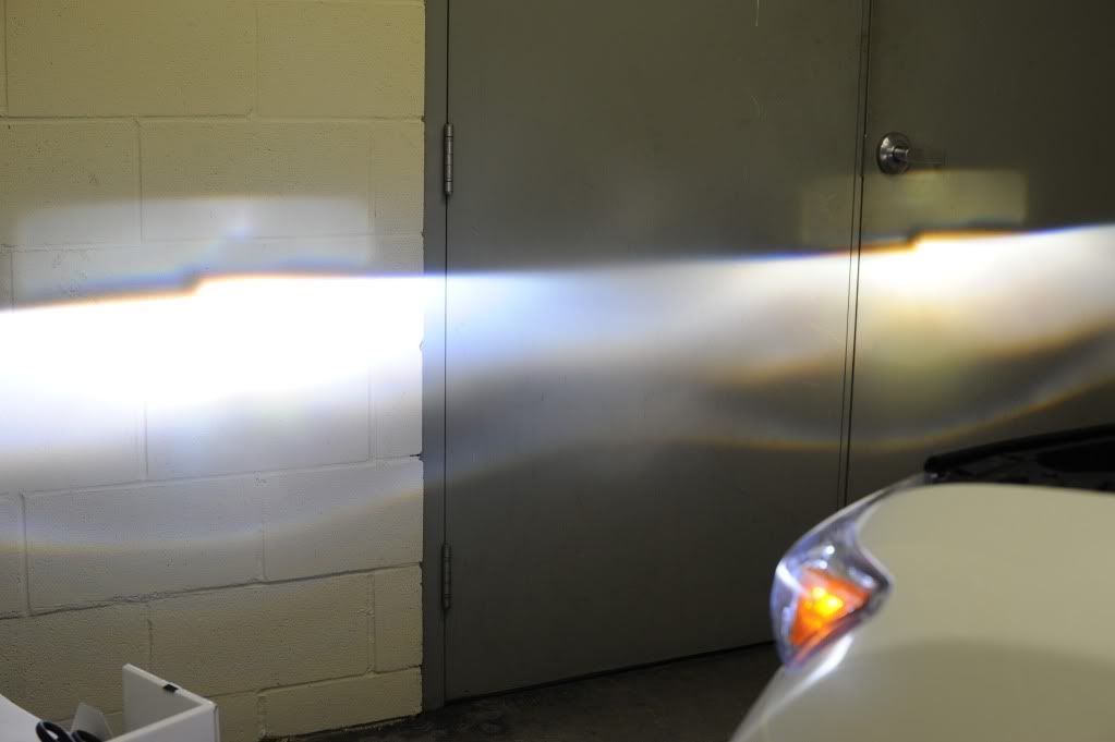

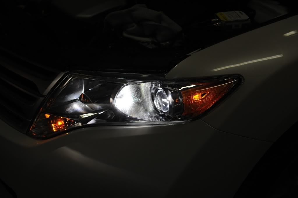

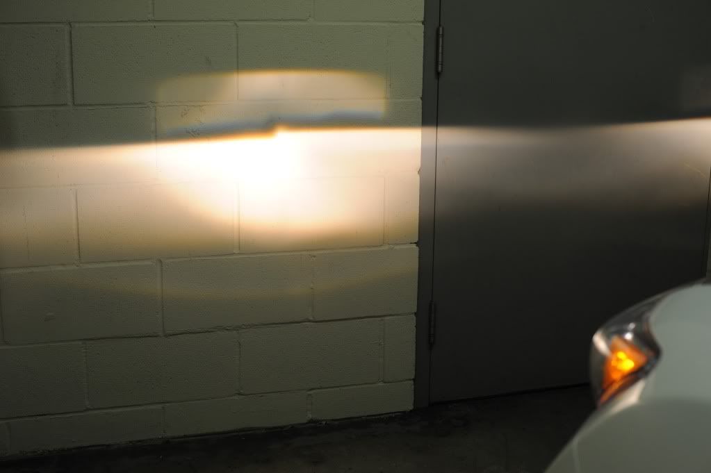

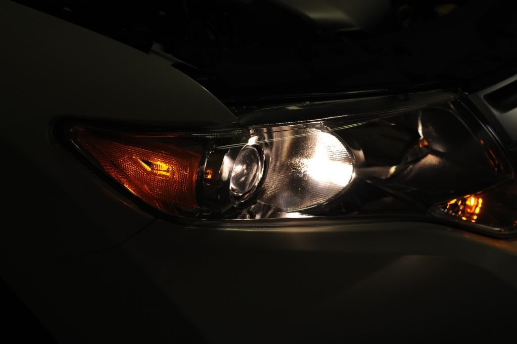

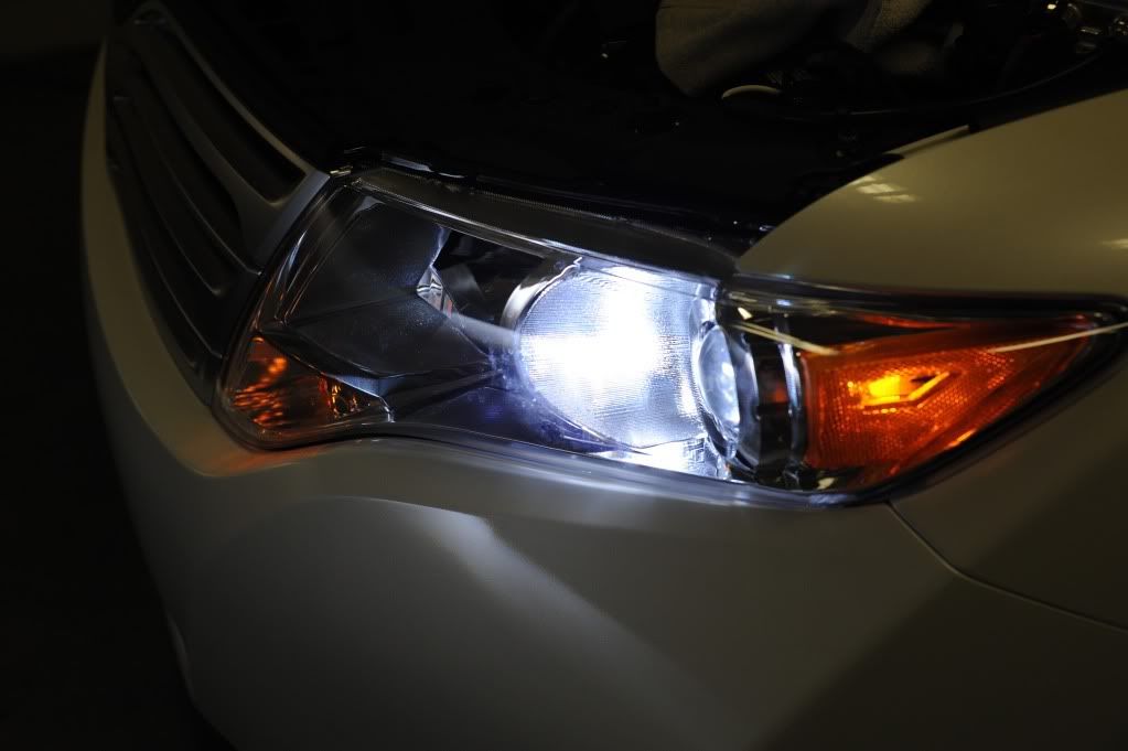

After all the connections, lets fire it up and see how it look.
It is the 4300K here in the picture.
This is the original bulb, yellowish and not bright.

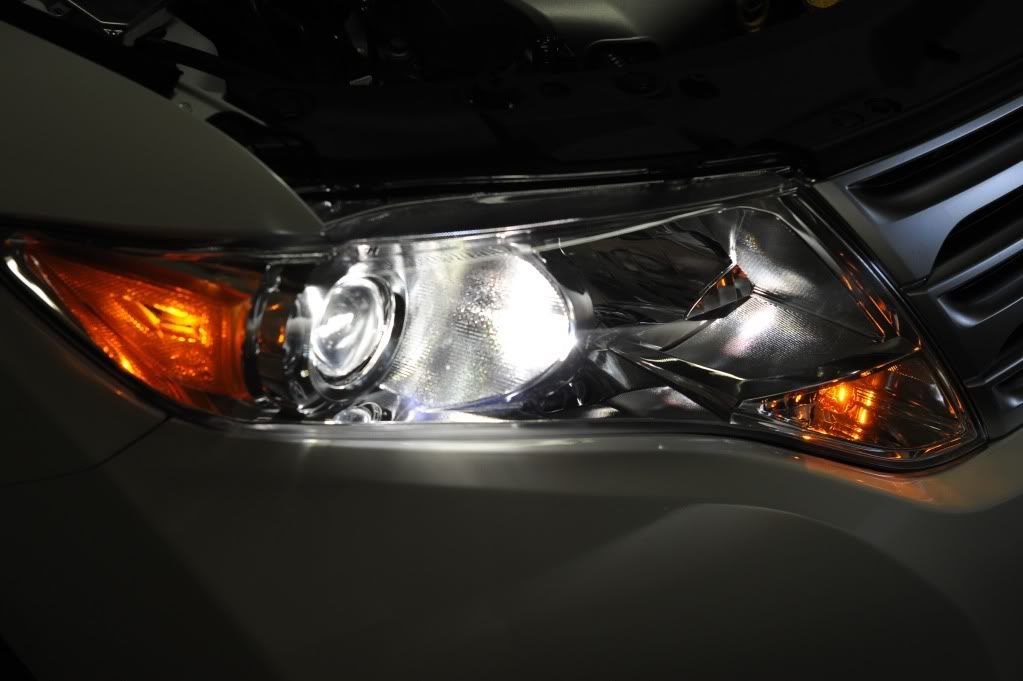

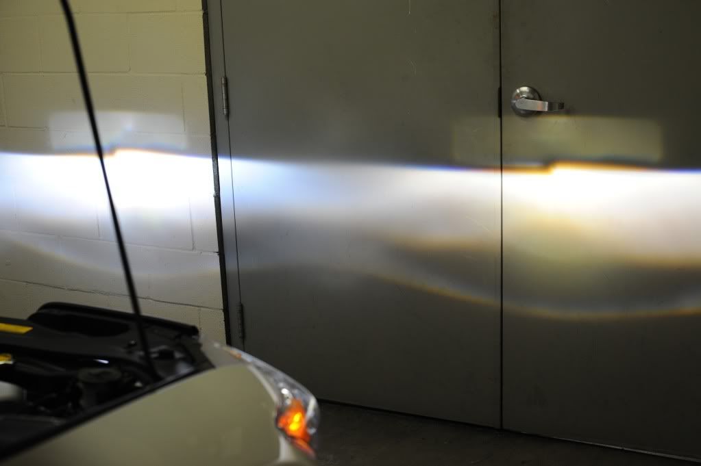

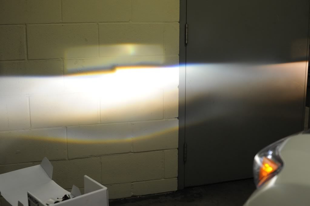

Here is the Philips 4300K. I have set the camera in manual mode, so the shutter speed and aperture are all the same.
See it is white on left side and yellow on the right side.
Right side original
Now right side 4300K
Left side 4300k
Left side 6000k
Left side 6000k, Right side 4300k
Another angle, left side 6000k, right side 4300k

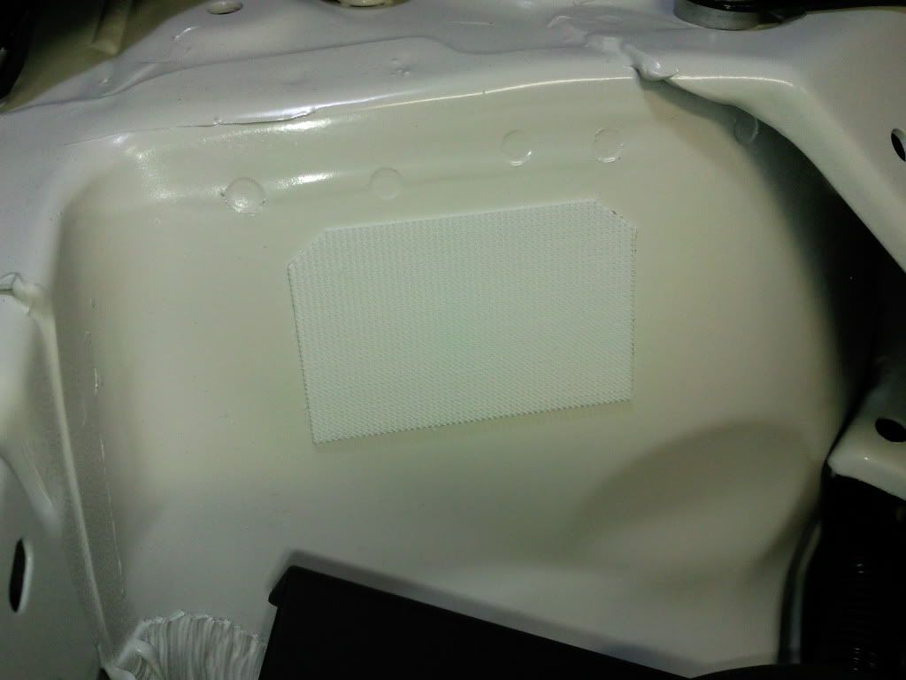

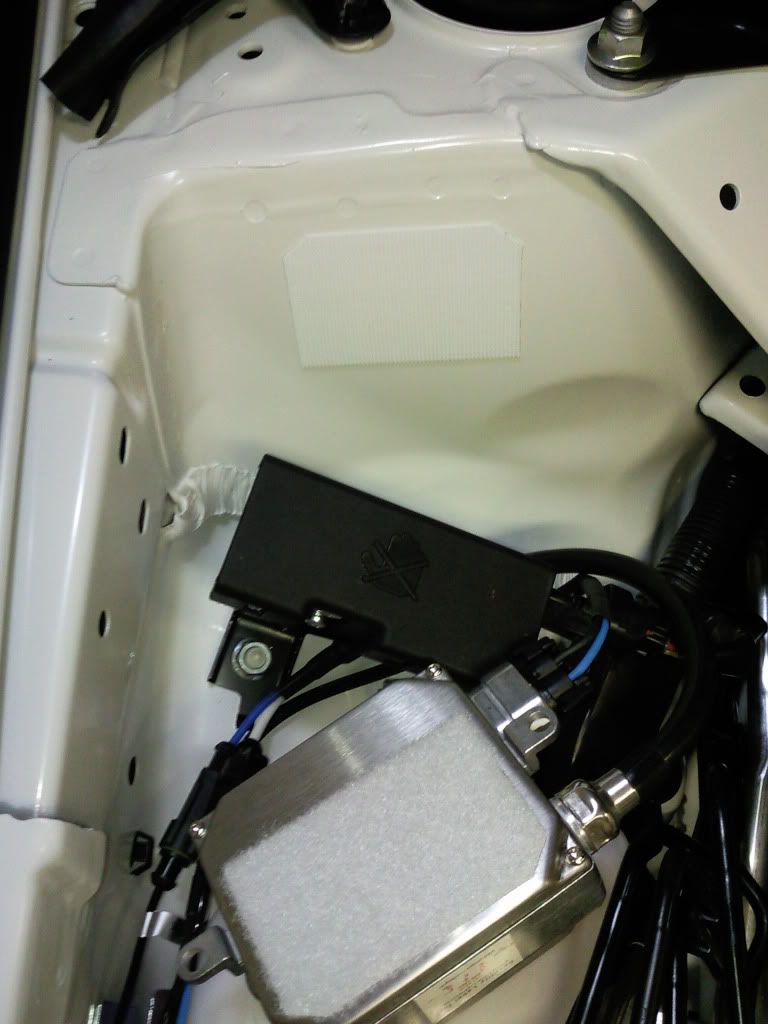

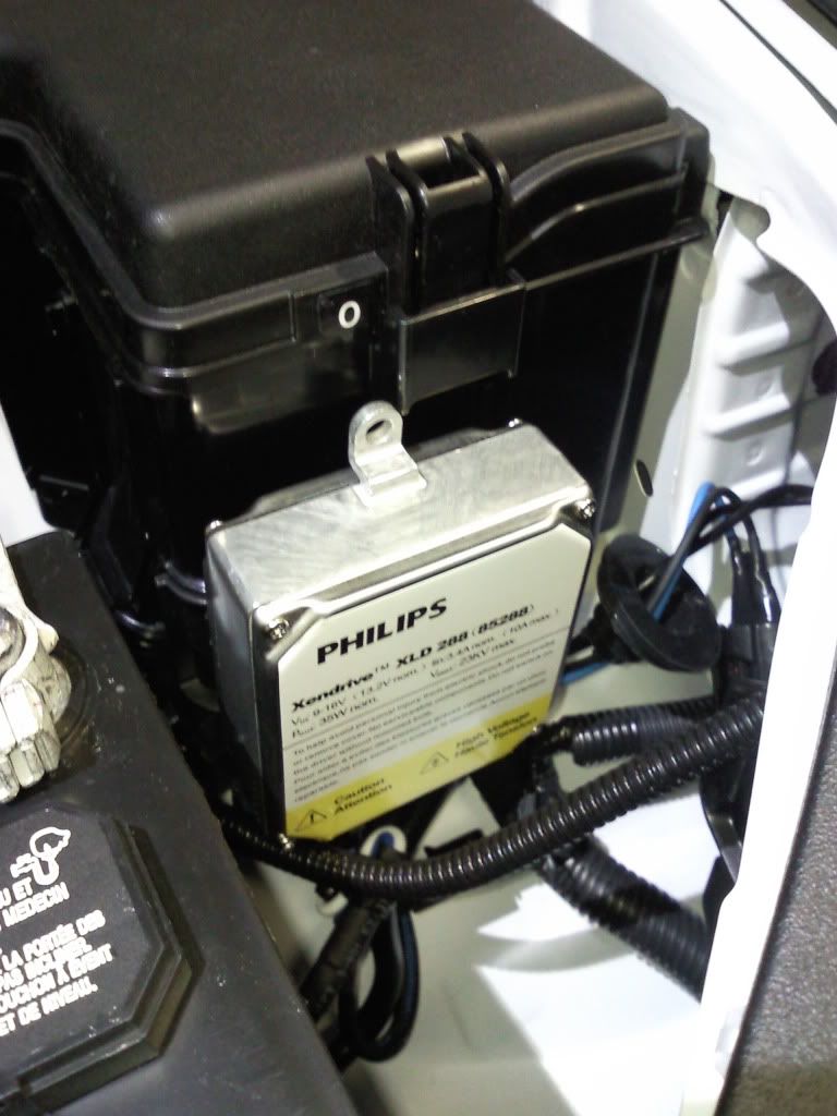

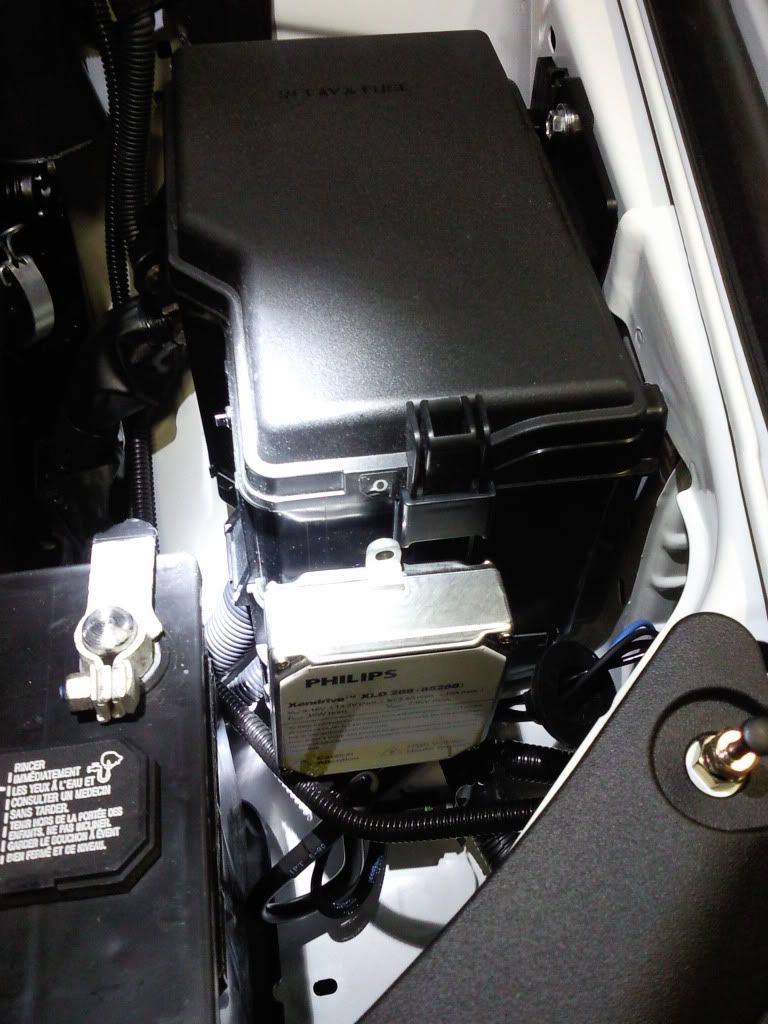

I use industrial grade velcro to secure the ballasts
Here is one of the places to put the ballast for right side.
I cut the velcro so it shap nicer
Here is the place I put(hang) the ballast on the driver side. Clean the plastic a bit and put the sticky velcro on.

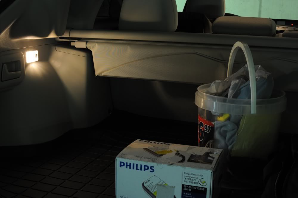

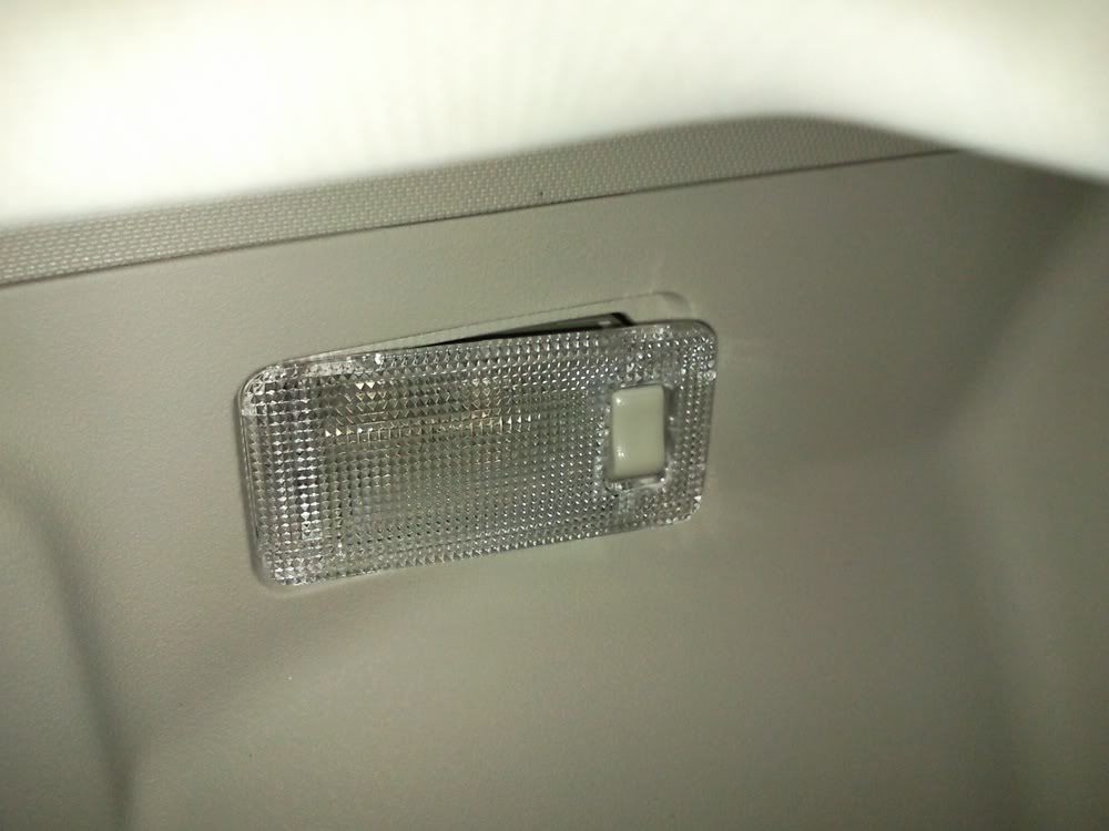

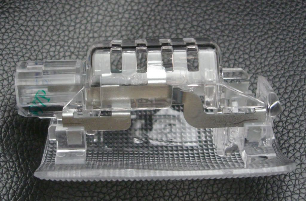

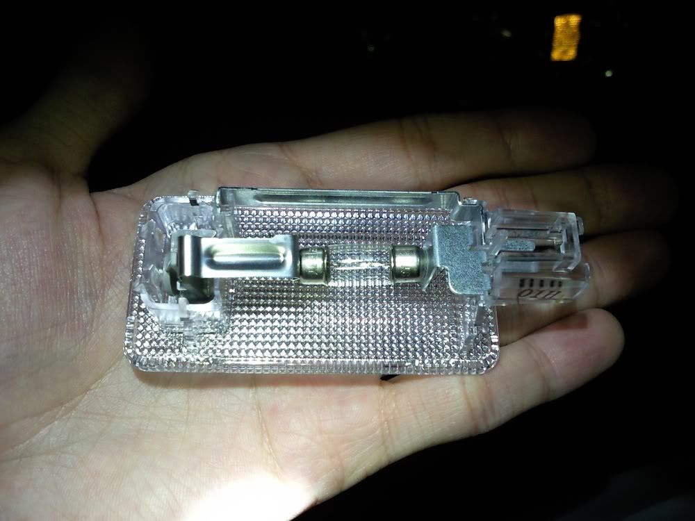

Trunk Light
Pop it off with a (-)screw driver on the right side

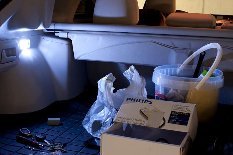

With original bulb. Planty of space. I should get the LED board type instead of the small one.

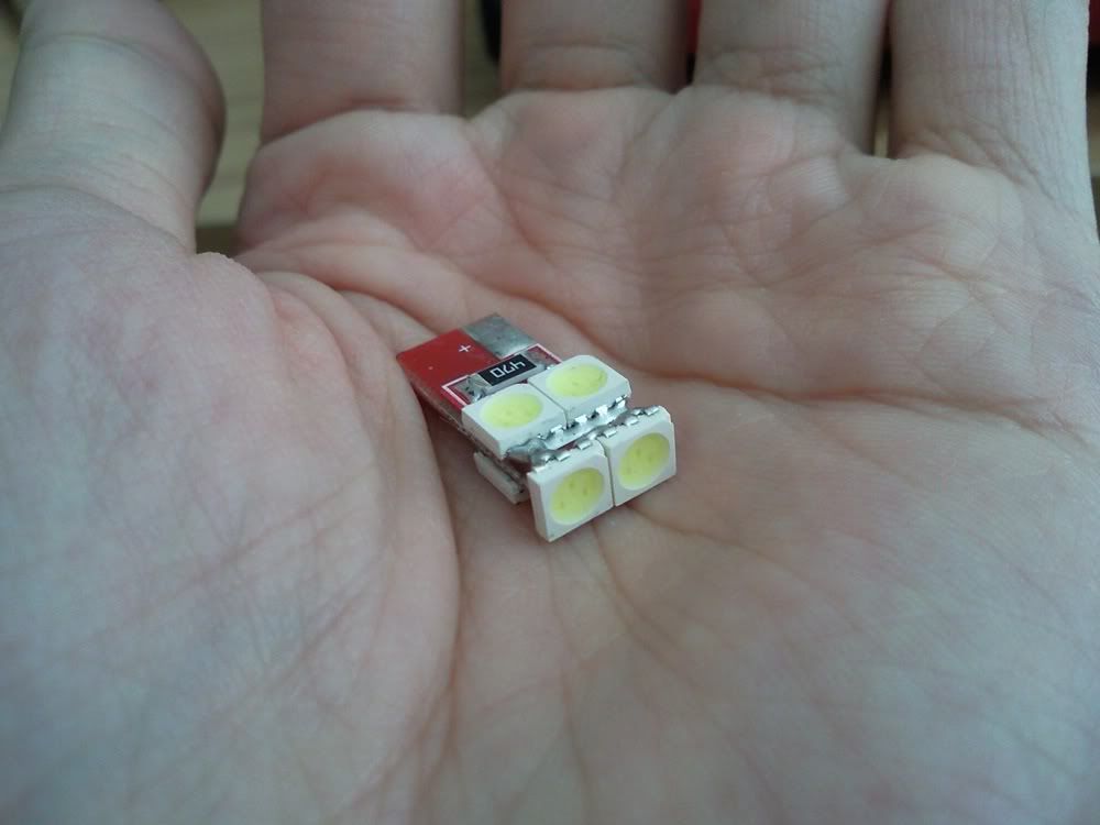

The one with 4 LED is the one I use.

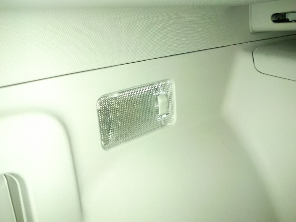

Original bulb
LED (color is a bit purpleish, sorry, I took the picture using my cellphone.)

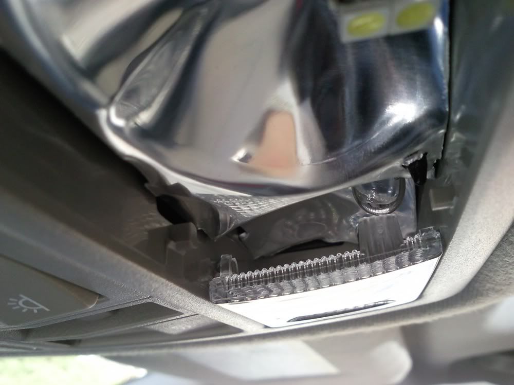

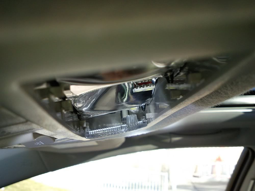

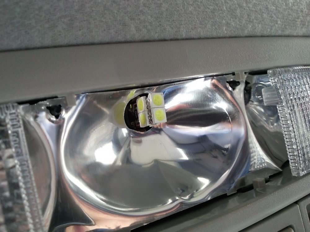

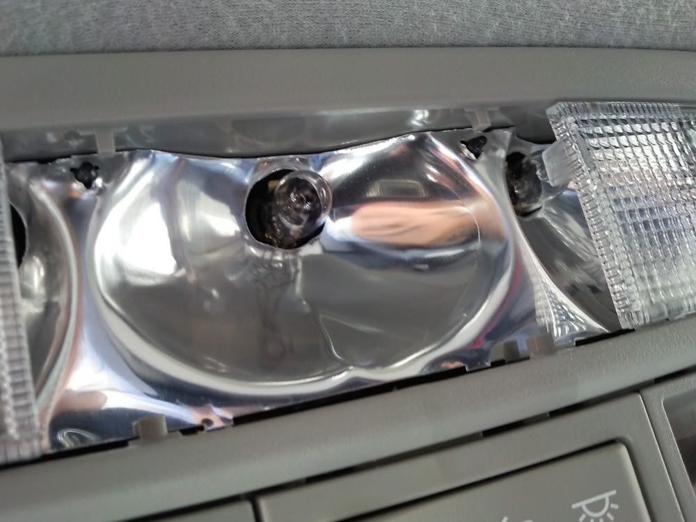

Center Lights

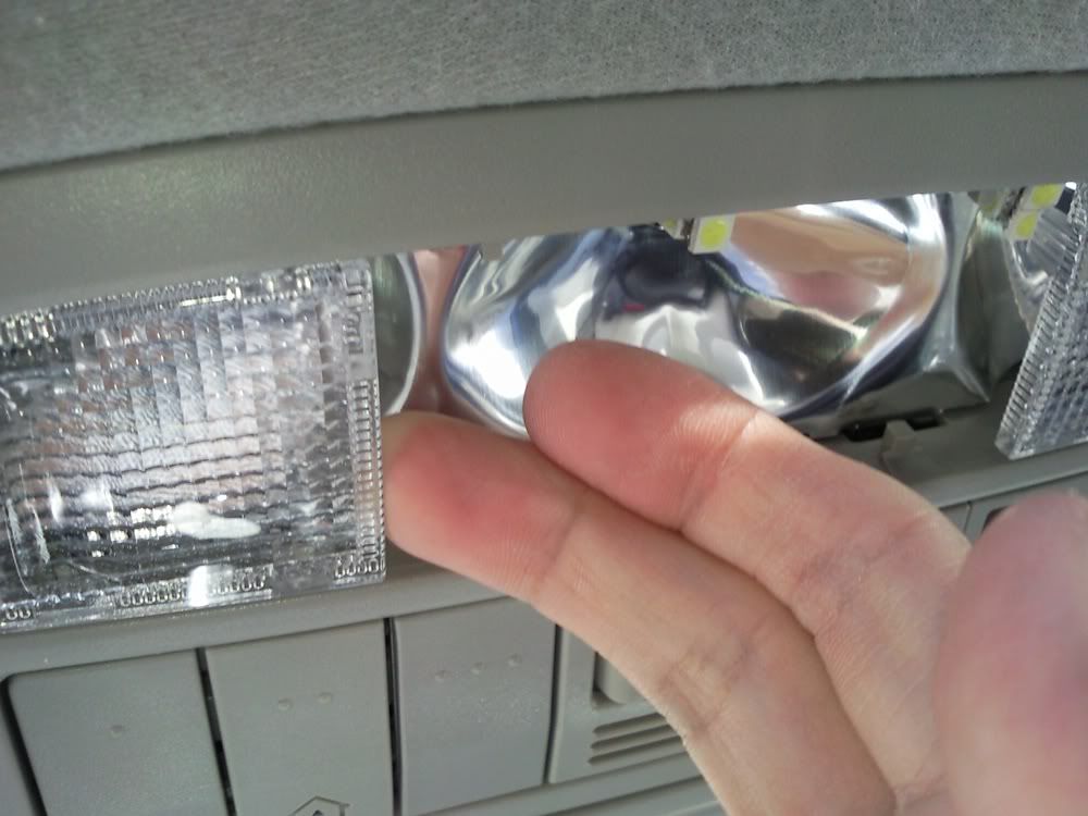

Again, pop one side of the center piece open first.
You will see the center bulb

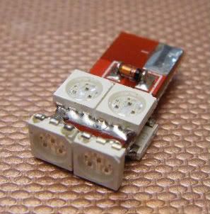

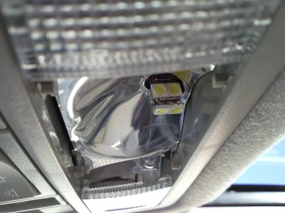

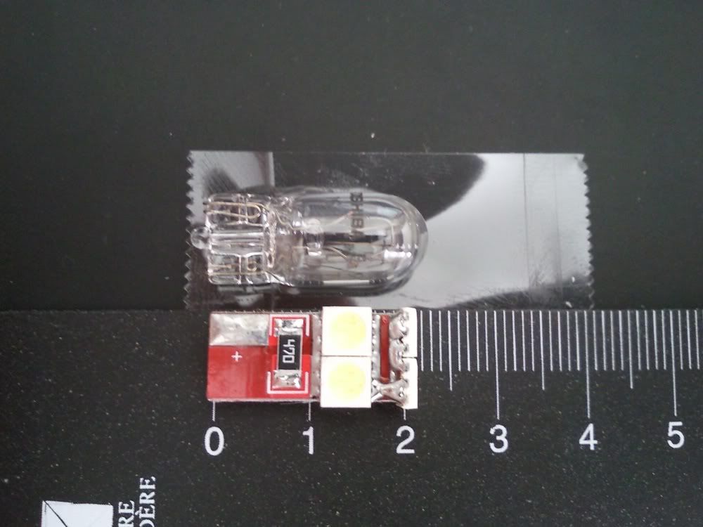

Here is the T10 LED I use. it has 6 white squares and each square contains 3 led, so there are total of 18 light emitting source from this tiny LED.
Size comparison (unit is cm)
Put it in
Lights from 3 directions

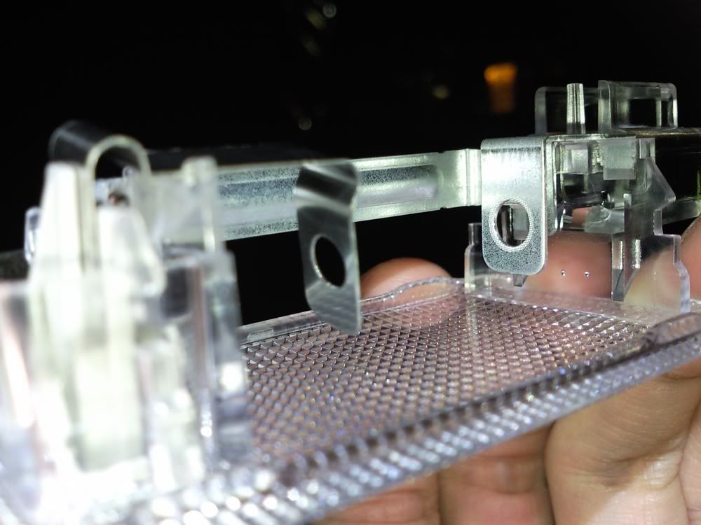

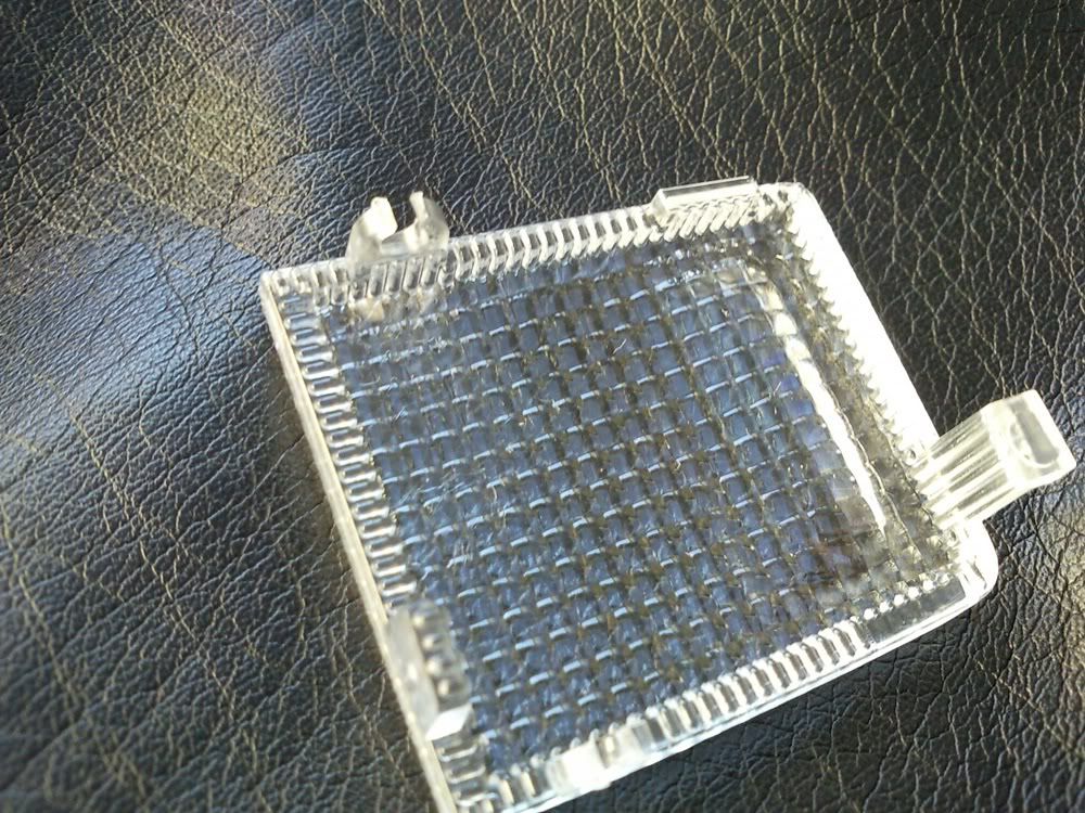

Just pull gentally and it should come off.
Watch out not to break it when you put it back in
You can see the hinge here. There are 2 hings for the right and left light covers. The center piece has 4.
The LED is so small that there is still lots of room if you consider a longer LED. Just remember to take away the center light cover first when you are doing this area, and put it back the last when you are done.
The LED still have the gradual dimming effect when you open and close doors.

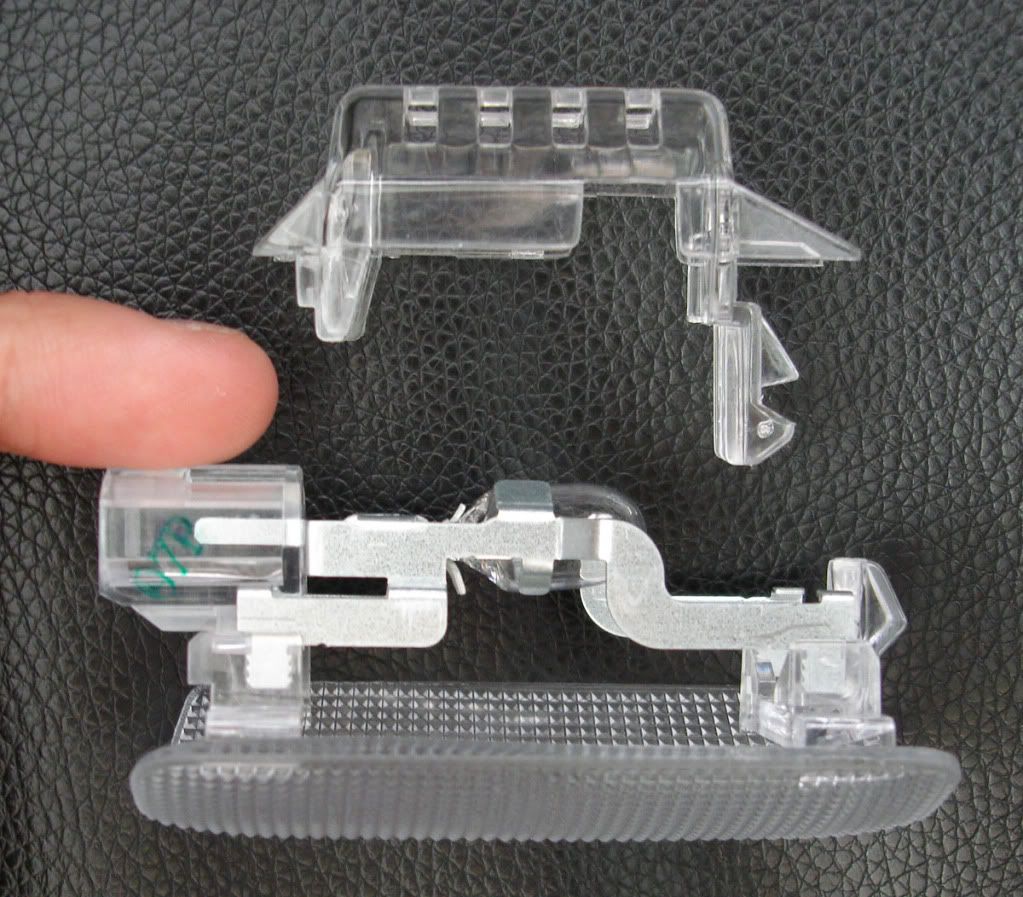

Door Lights

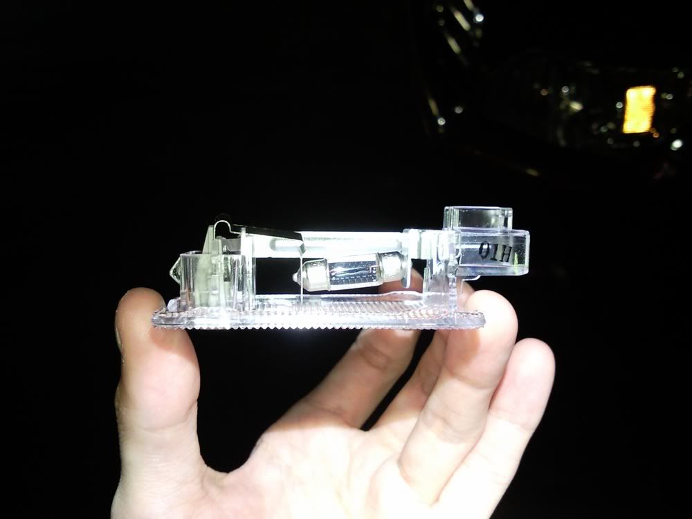

After detached from door

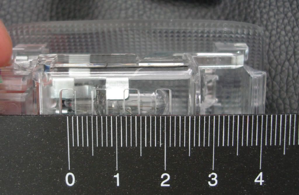

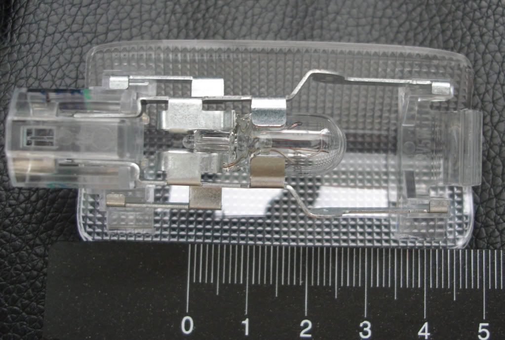

The size of the cover limits the size of the LED you can use, unless you plan not to put the cover back.
Detach the cover
Without the cover

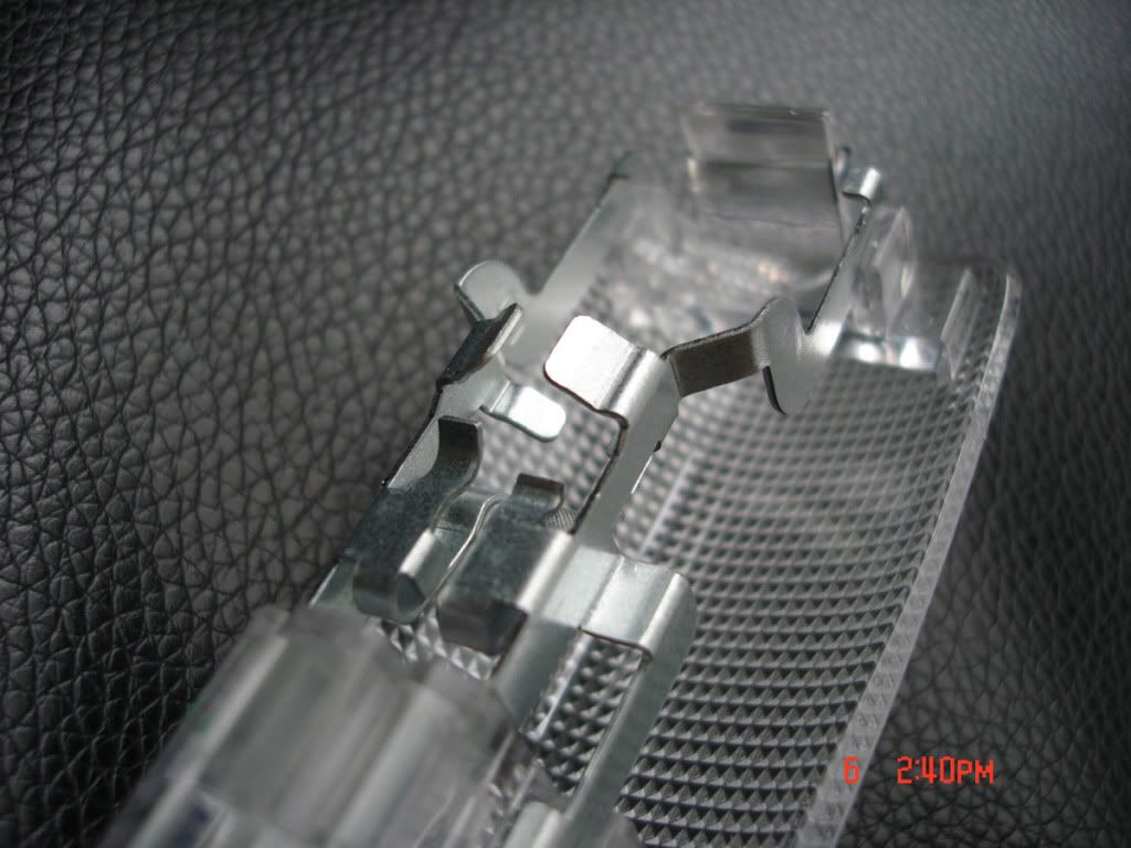

There are 4 metal bar that holds the original bulb, which also limits the LED selection, unless you bent it straight.

Thanks for the great write-up! Are the LEDs in the cargo area brighter than the old light bulb? Or do they look that way because the camera adjusted to the lighting?
Is the color of the light that blueish?

They are all T10 type of LED. Jus get the longest bulb that can be fitted in its own case.
For me, I got the LED before I got the car, so I played safe and find the brightest/ smallest one to make sure they fit.

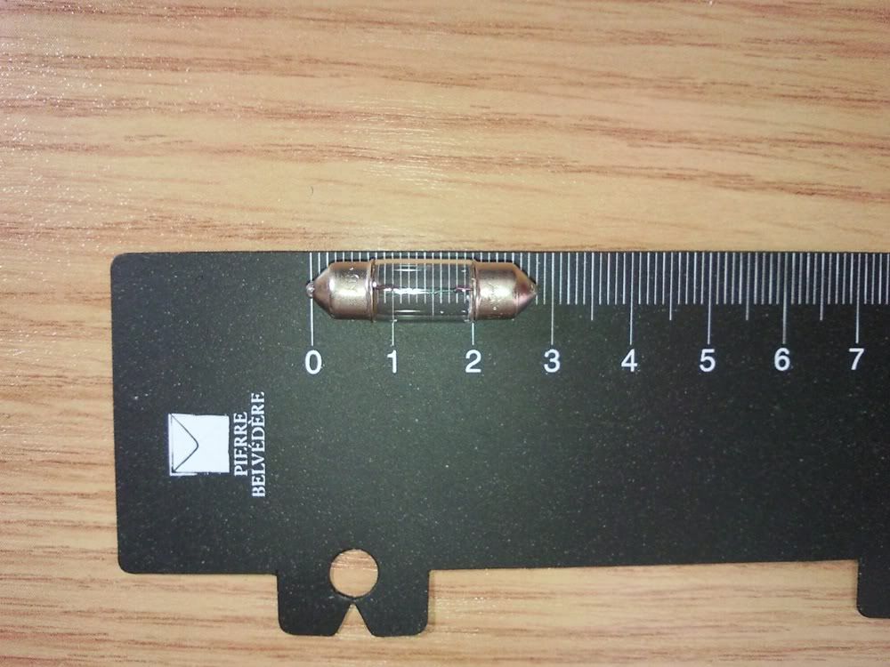

The only different one is the trunk light, which uses a 3022 bulb.
From the photos, you can see that there are planty of room. If I do it again, I would take out the trunk light (should take only 5 secs) and measure the space, and then order the largest board type LED that fit. I found that the LED I use for the trunk is just a little brighter than the original one.
It looks bright if you starr at it. But if you look at the cargo area where it shines, I think only a little brighter. You will notice it has just a tiny blue hue if you satrr at it a long time and compare/imaging the flourecent desk lamp at home.
I think something like this is better. it will be brighter for sure.
