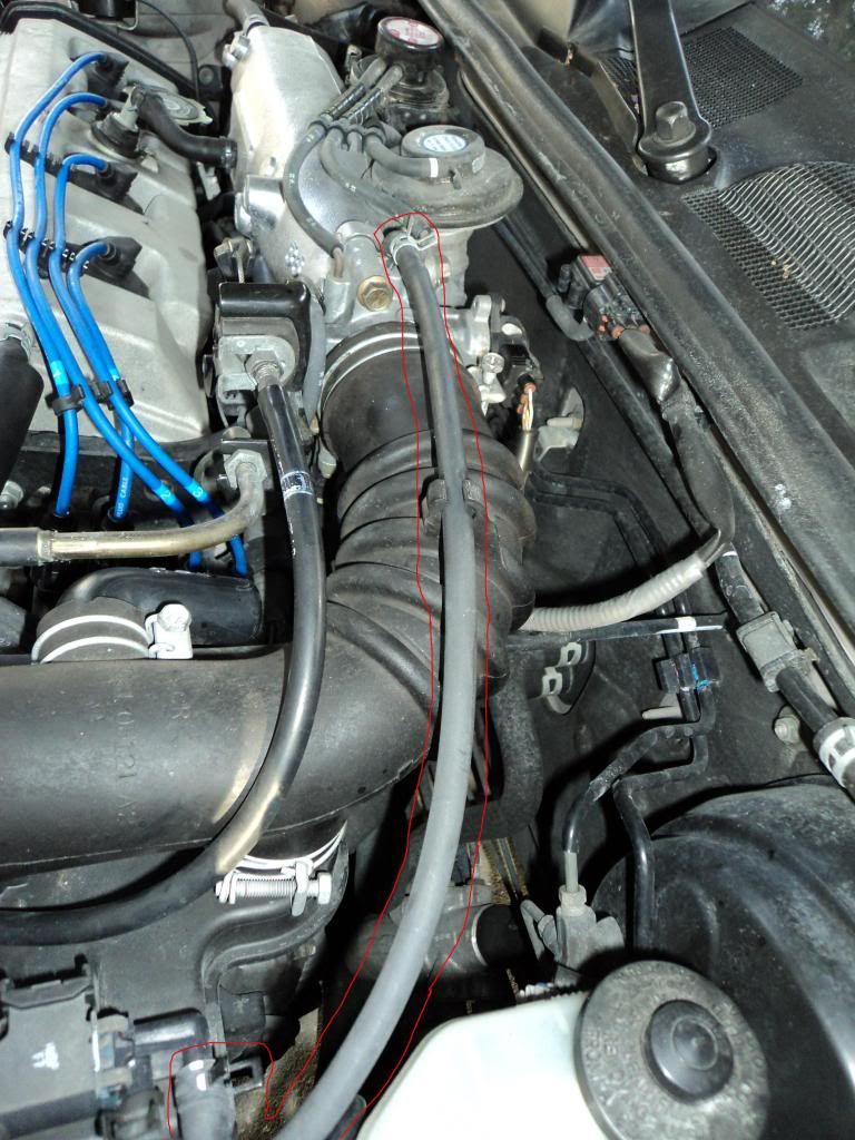

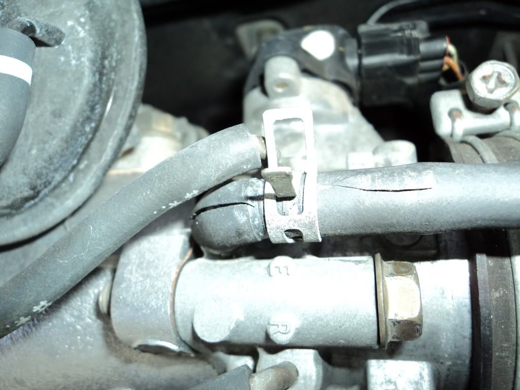

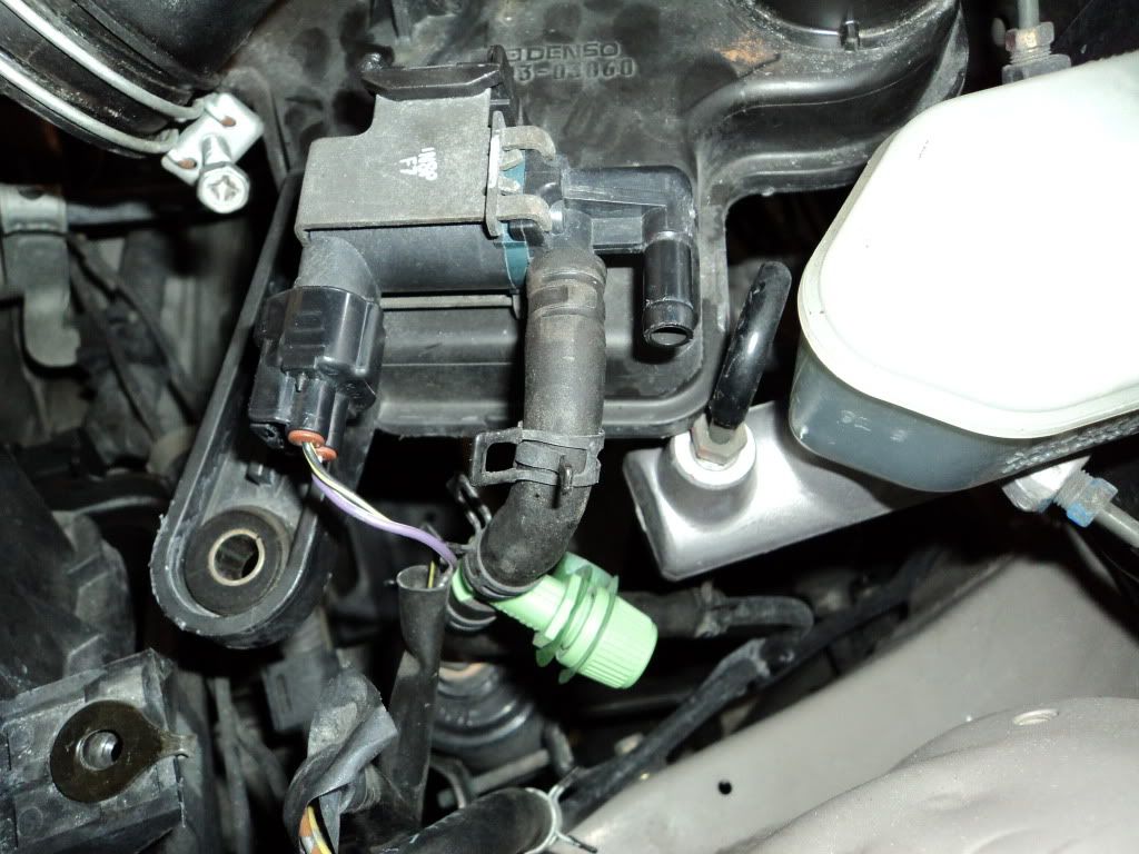

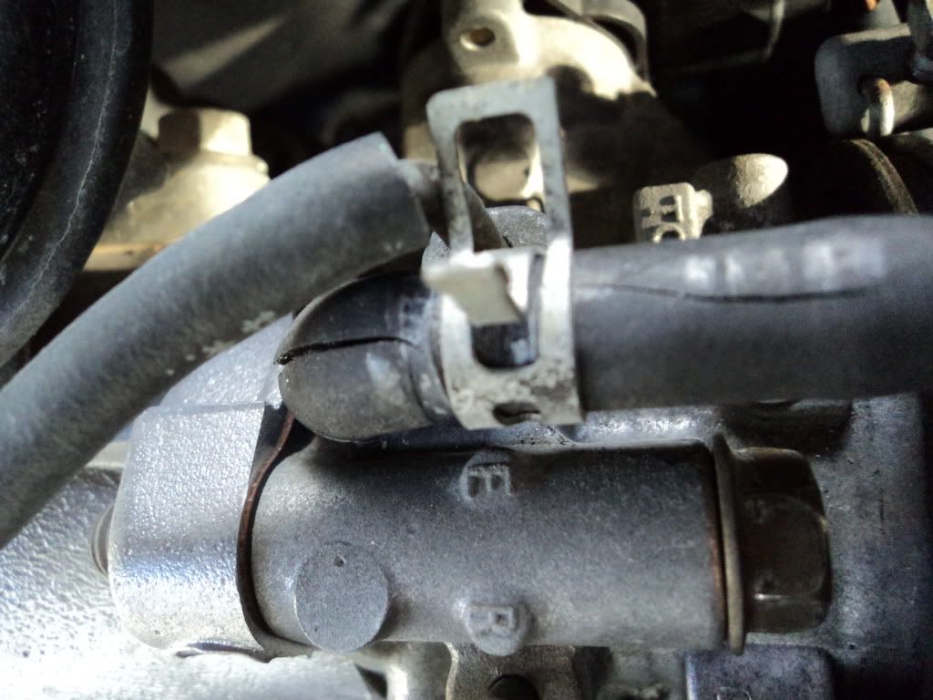

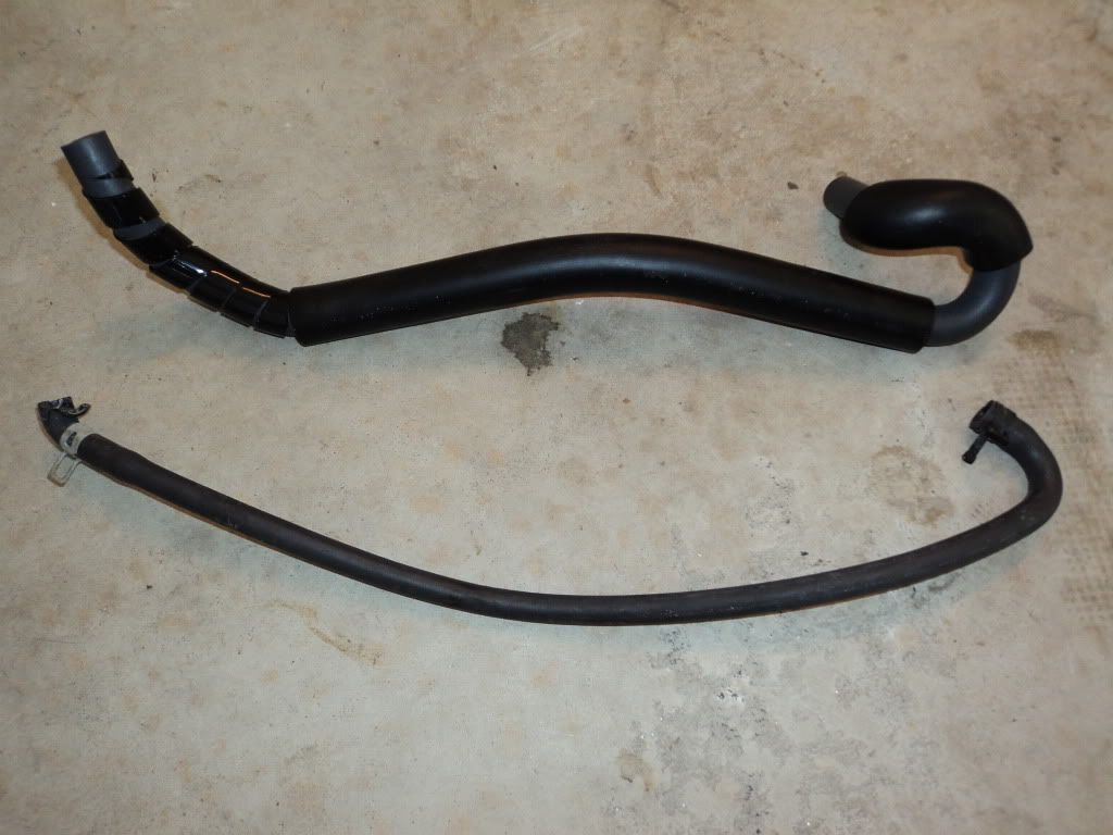

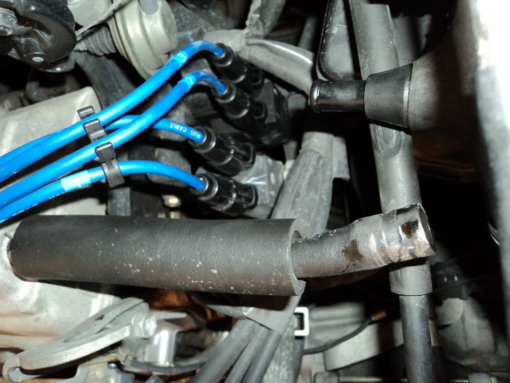

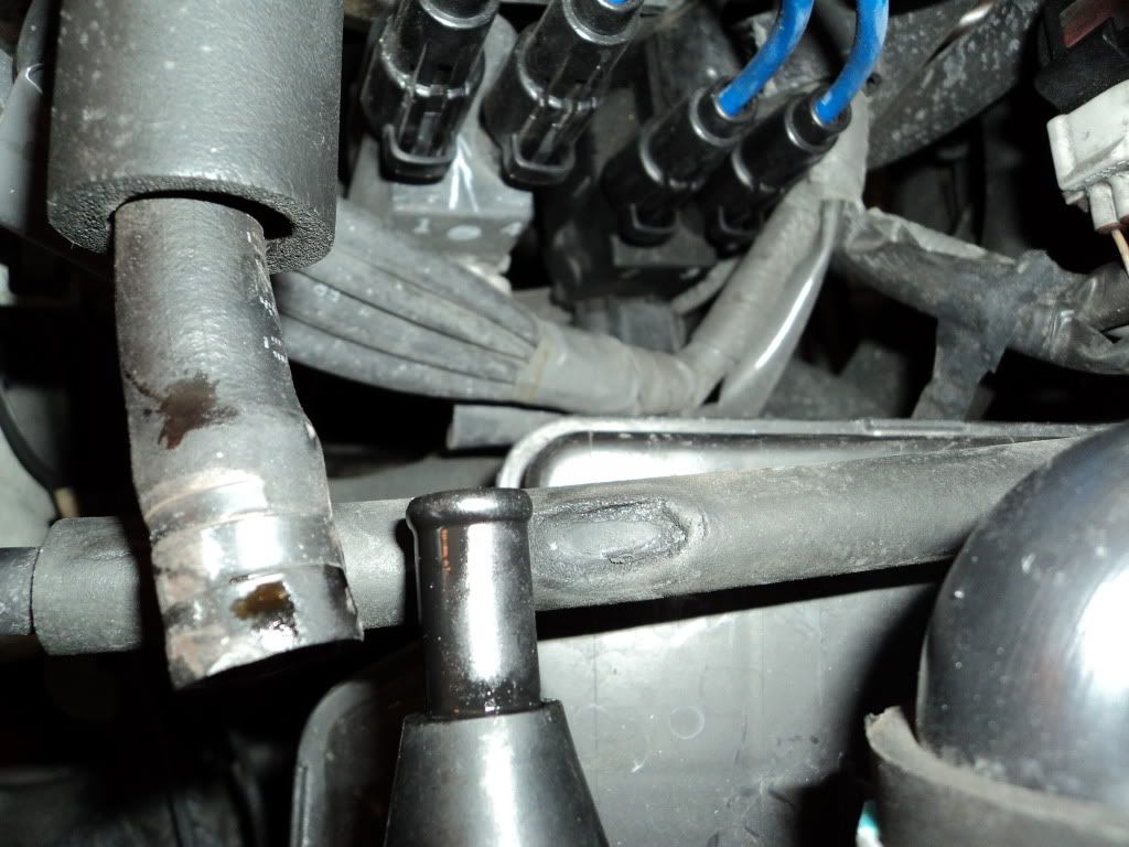

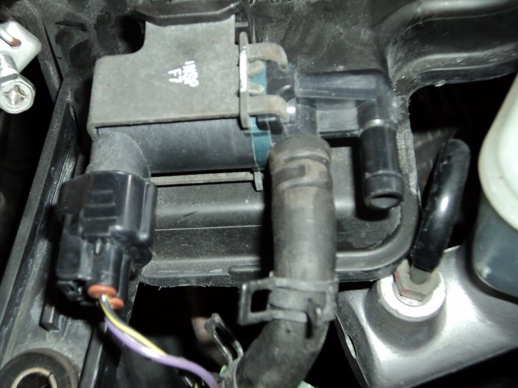

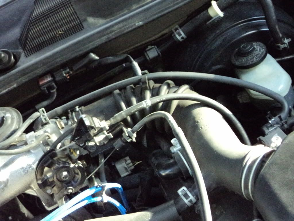

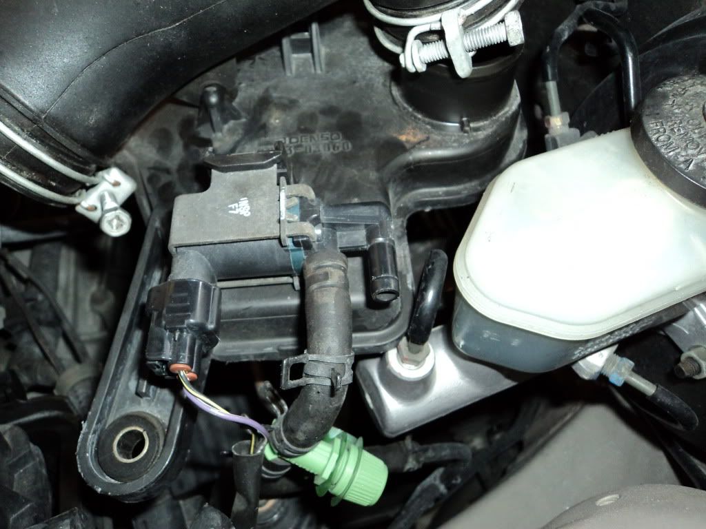

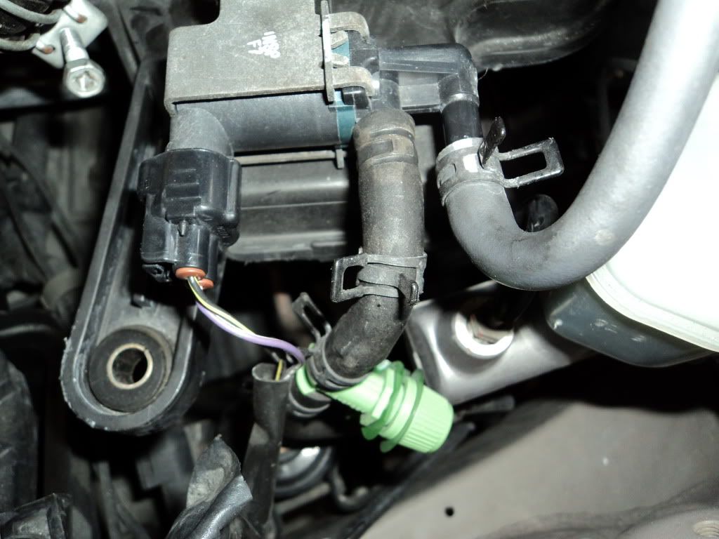

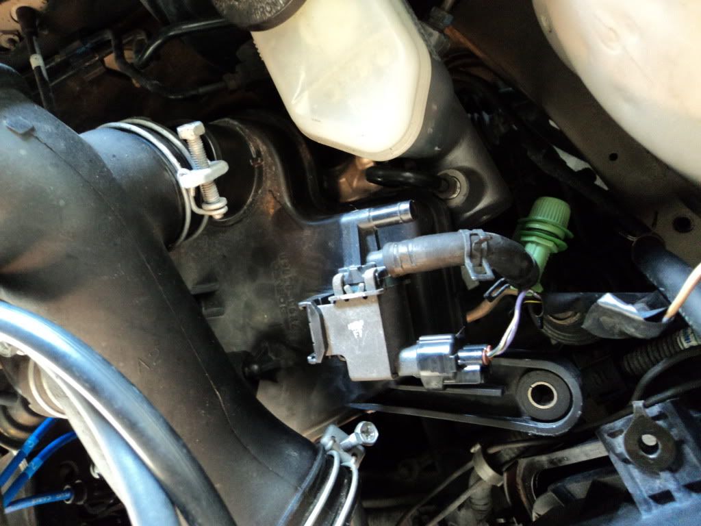

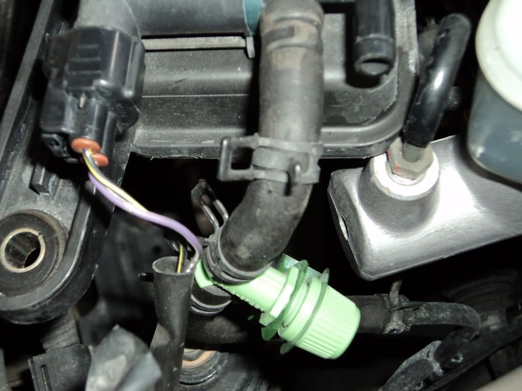

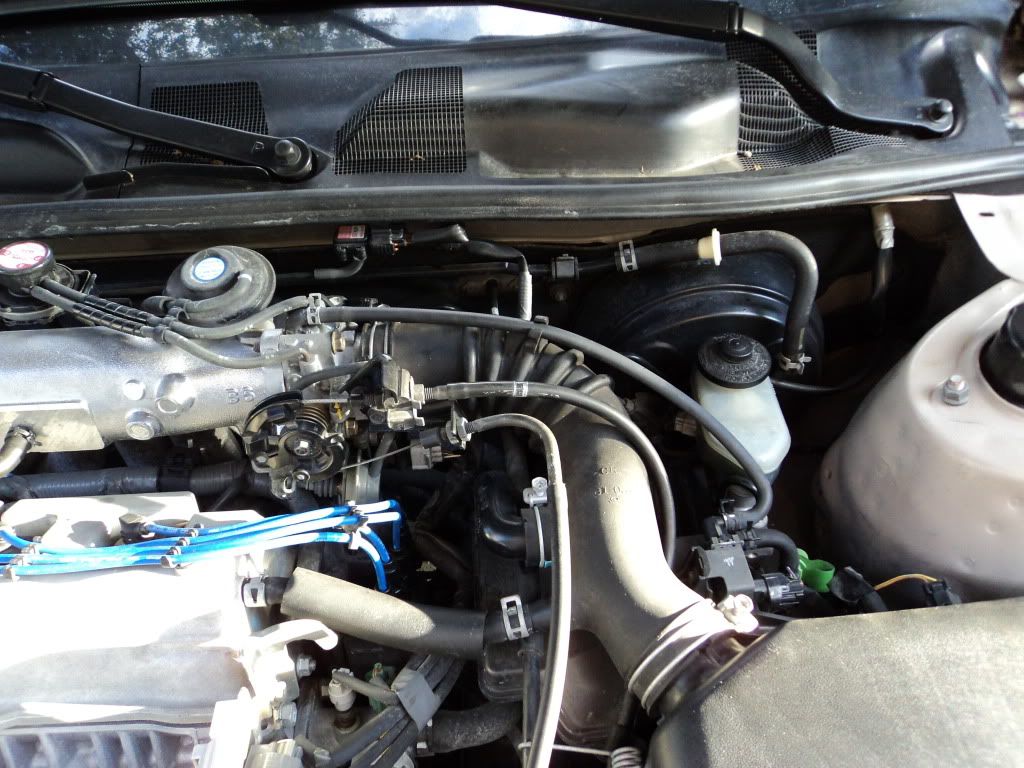

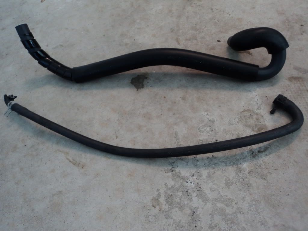

thr hose you marked in red in first pic is the vacuum line going from TB to VSV for EVAP.
you can easily (and cheap) replace it with a metric silicone hose 6mm ID / 2mm wall.
from here you can get 3ft of such hose at like $5.80 shipped from Taiwan, that's what i did:
http://cgi.ebay.com/ebaymotors/6mm-...ptZMotorsQ5fCarQ5fTruckQ5fPartsQ5fAccessories

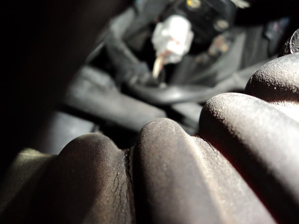

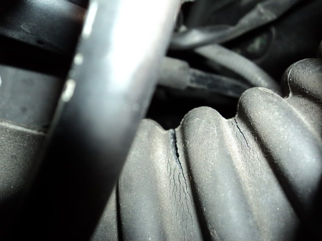

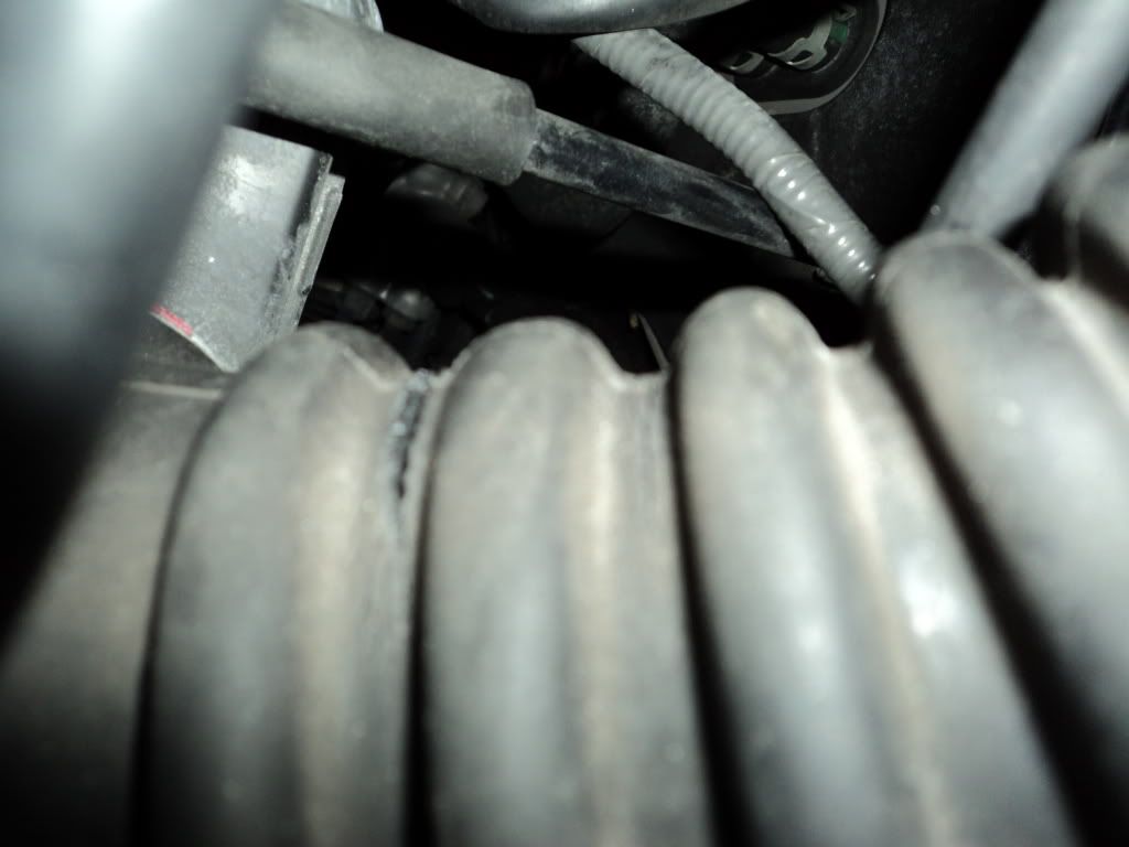

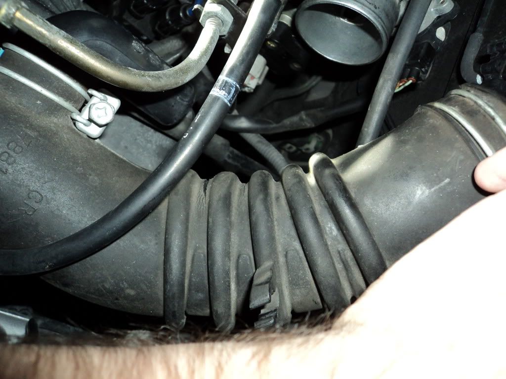

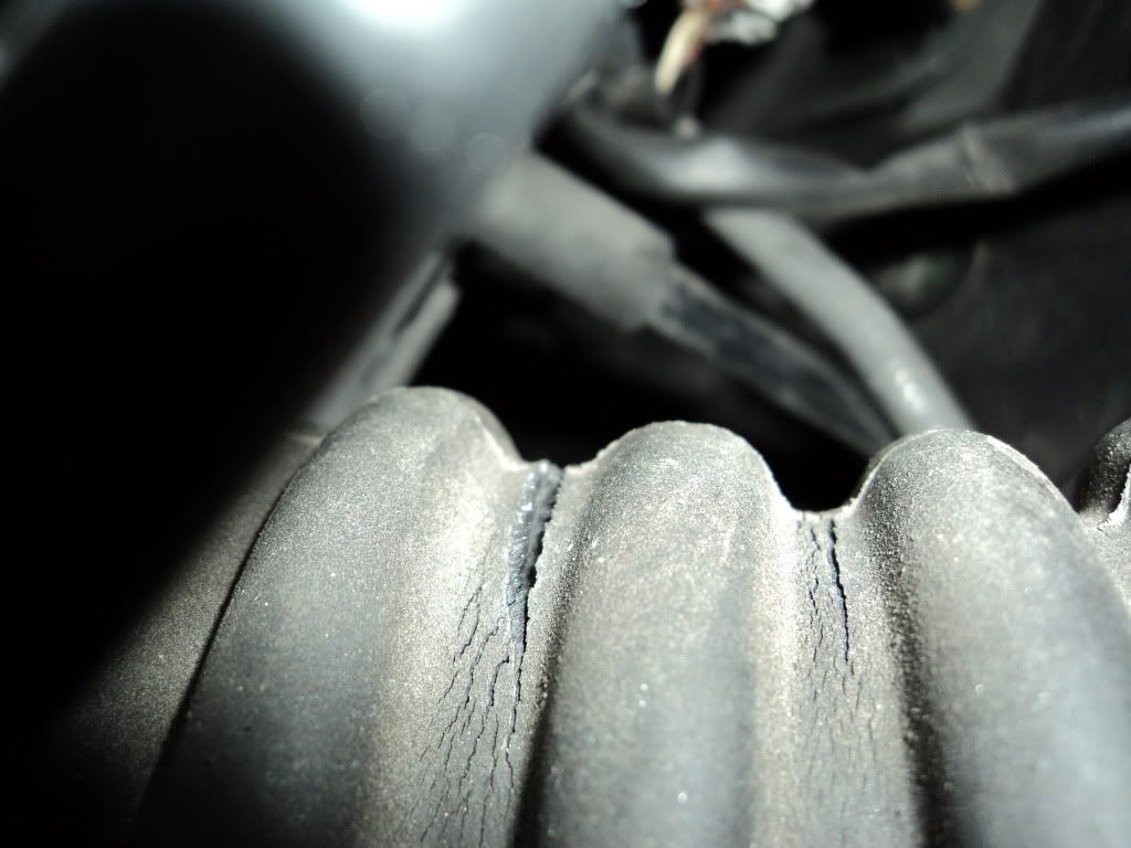

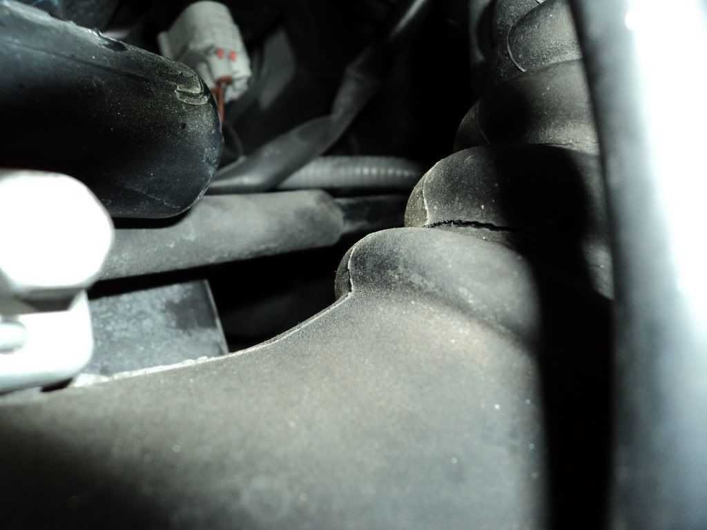

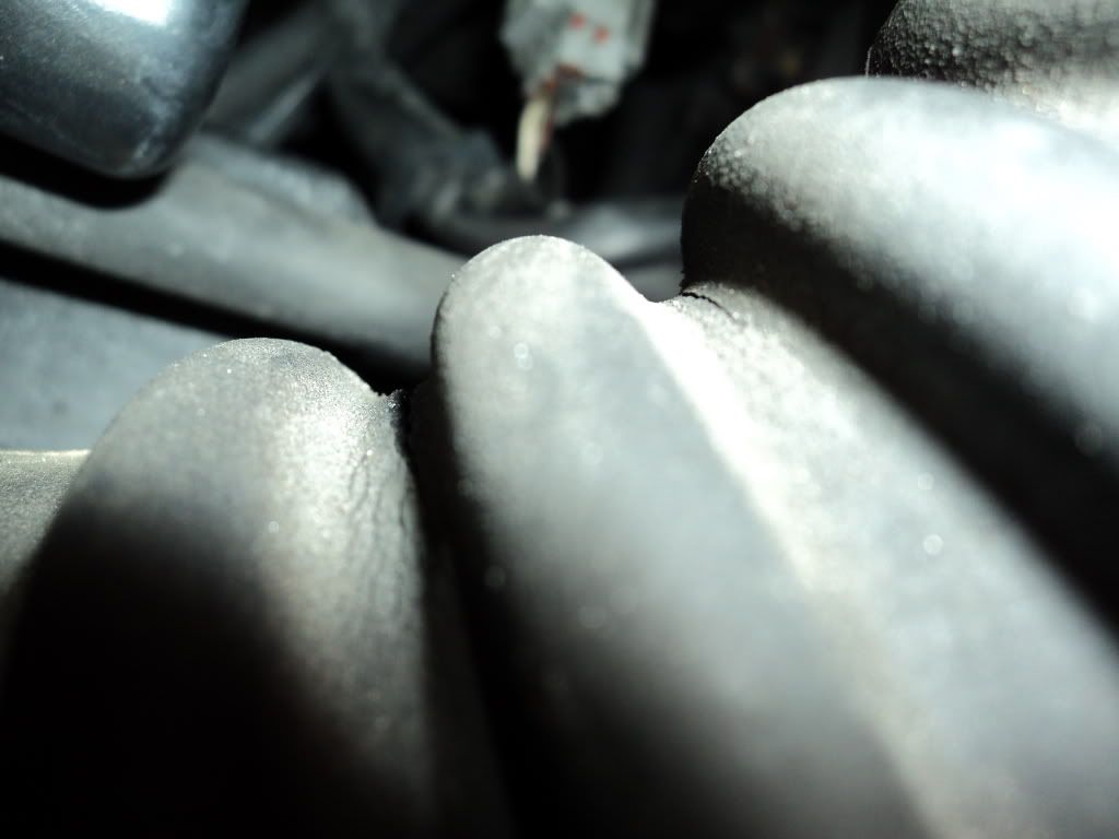

as per cracked intake air hose (the large one) it sucks, i suspect mine is in same condition ... I guess getting new OEM is the way to go - junk yard replacements would be same or worse ...
here is p/n for that 17881-03110 (based on '00 5s-fe), thought it's pricey ($70.28 from toyotapartsoutlet.com)
let know if you need anything more (which pics)
