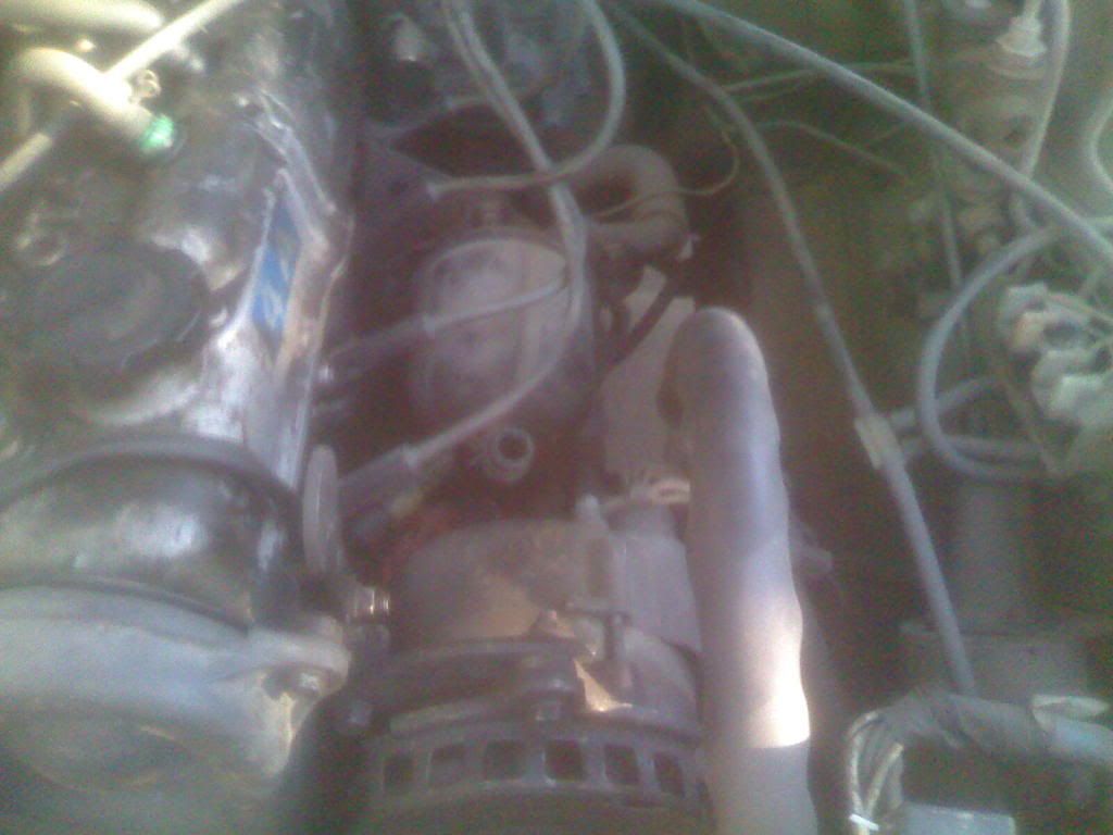

The other thing i have a hose on the center of the pic that i cant figure out where it goes to?

The huge hose that goes over the alternator is one of your A/C lines. On a side note that bell looking thing is your Air Suction System/emission control device.
