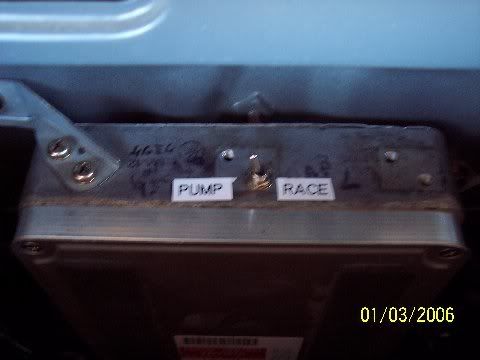

i can swap maps in megasquirt pretty quickly (fuel req. maps) even when the car is running..... however swapping ignition maps is a bit tougher.....
yeah i dont know if its possible to do, or more importantly what it would cost,.. but I would love to go from corolla gas mileage to funny car drag speed with a minor switch or a few buttons on the laptop... even if i had to cut the car off for a second and restart it to reset the EMS or whatever,... that would be fine.
like this kind of?
320rwhp @ 17psi on pump gas
360rwhp @ 21psi on race gas
http://www.mr2oc.com/showthread.php?t=154958
yes something extremely similar to that.... im not even above having a separate gas tank full of 100 octane,... although that wasnt exactly waht i had in mind... wanted to do it all from 1 gas tank.
but it would have to change everything over... fuel maps, ignition maps, timing, boost, afr, eveyrthing so that i go from 35mpg to 18psi and 350whp.
if you have that setup, please tell me what i need to do to make it happen.
