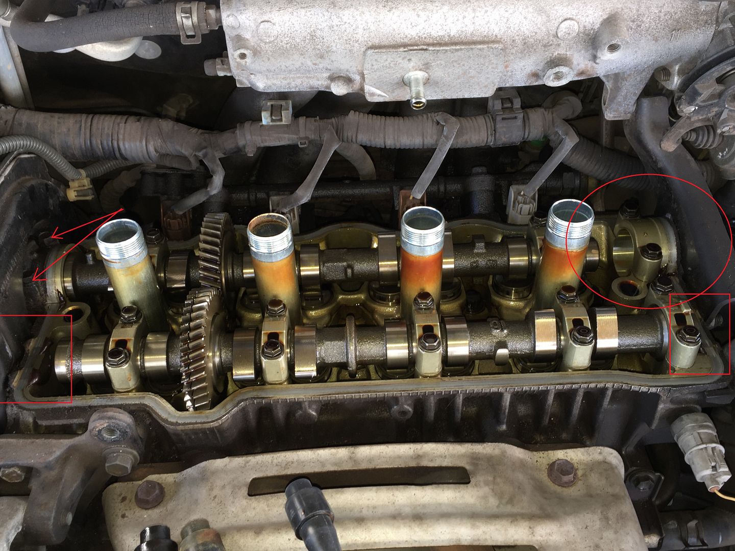

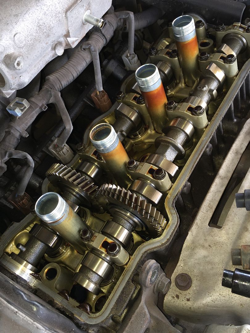

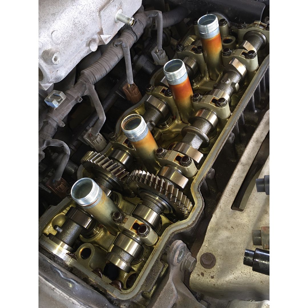

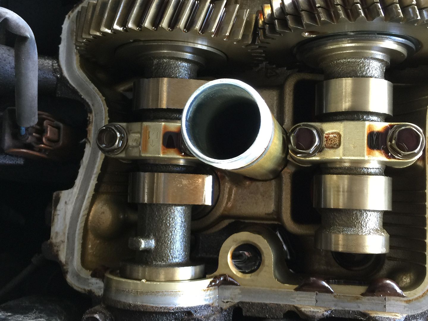

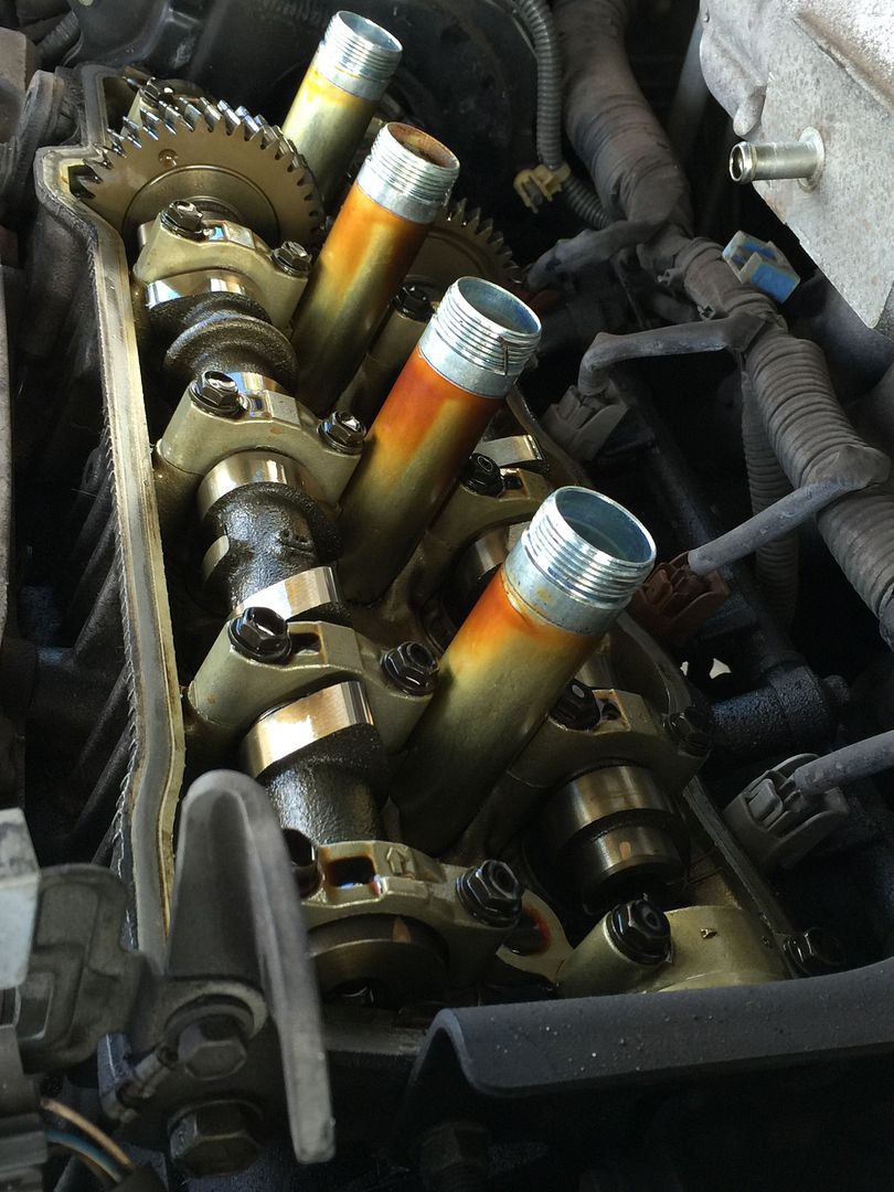

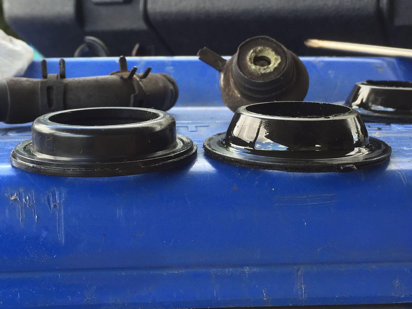

The one I have in circle is the half cap 'full moon'(?). I would loosen the two bolts, remove the top cap and the plastic cover. It's probably leaking because of the engine angle and oil tends to just chill in the cap area. Just RTV it (black RTV) and let it set. I used a torque wrench....I don't recall the torque...may I just hand tighten to 'tight'. Can't remember.

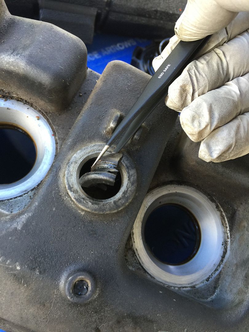

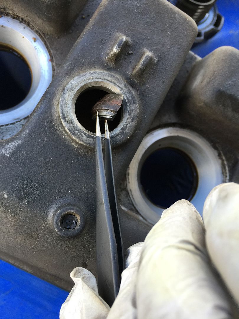

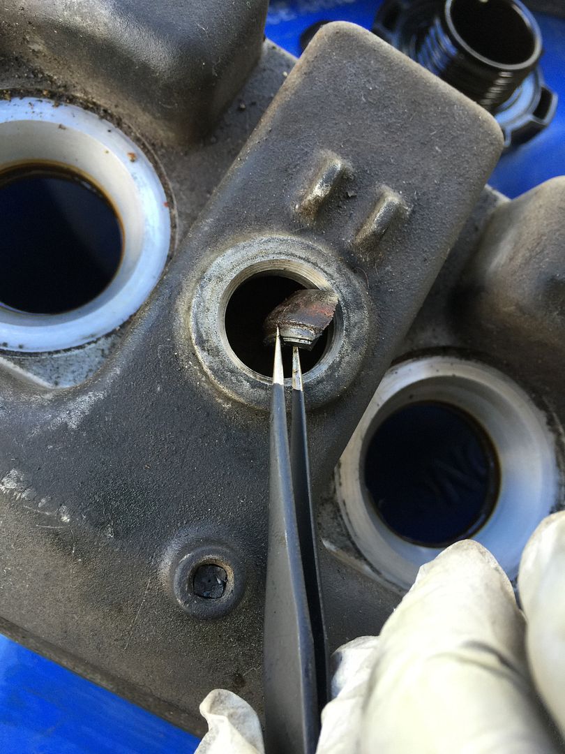

Now the two other pictures with the squares, I think this is the half moons. Not sure how your suppose to remove them but the cars I've worked on they were not leaking. I think if they are stuck on good, you should be okay but try check the surround areas for leaks.
http://www.toyotanation.com/forum/1...6-1997-2001/353035-97-2-2l-oil-leak-pics.html
http://www.toyotanation.com/forum/1...8777-only-bought-2-out-4-half-moon-plugs.html
http://www.toyotanation.com/forum/1...mshaft-end-plug-cap-black-round-plug-cap.html
some other links for this.

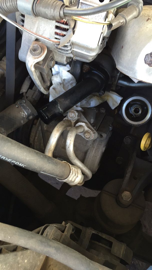

The two arrows points to a cap on the timing belt side. Not sure how you can reseal that with the timing belt back plate on. Maybe someone can chime in on this.

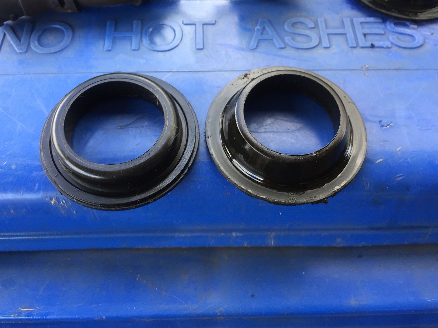

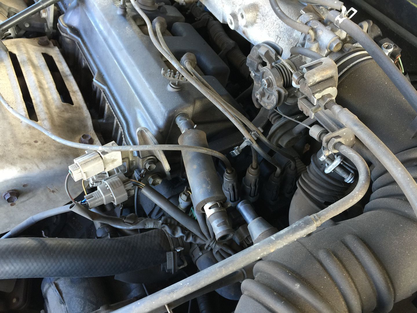

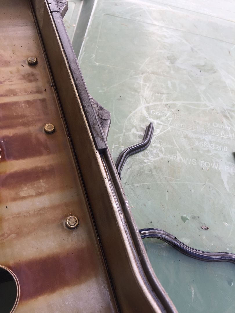

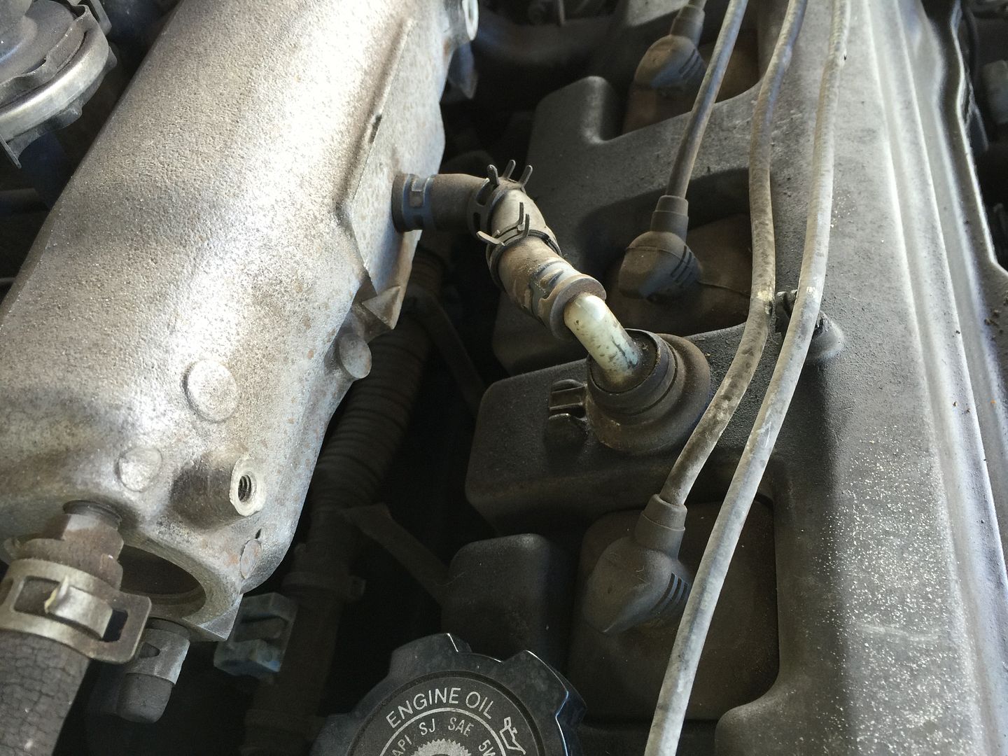

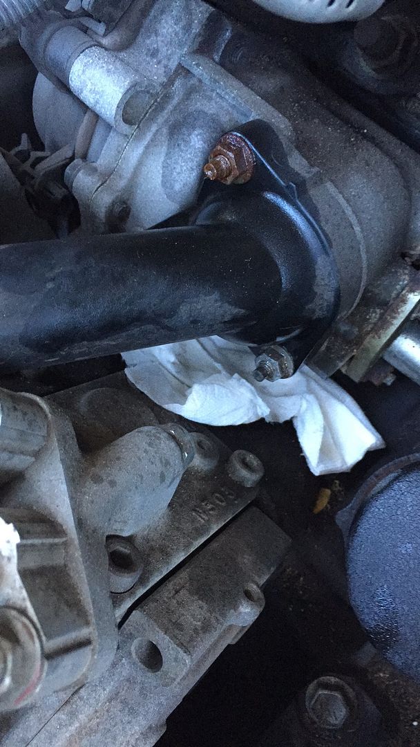

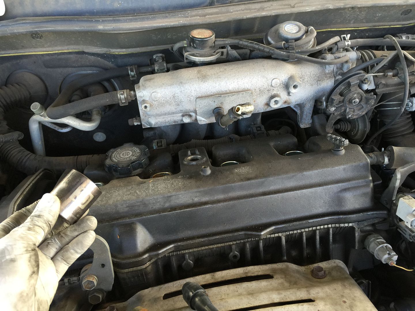

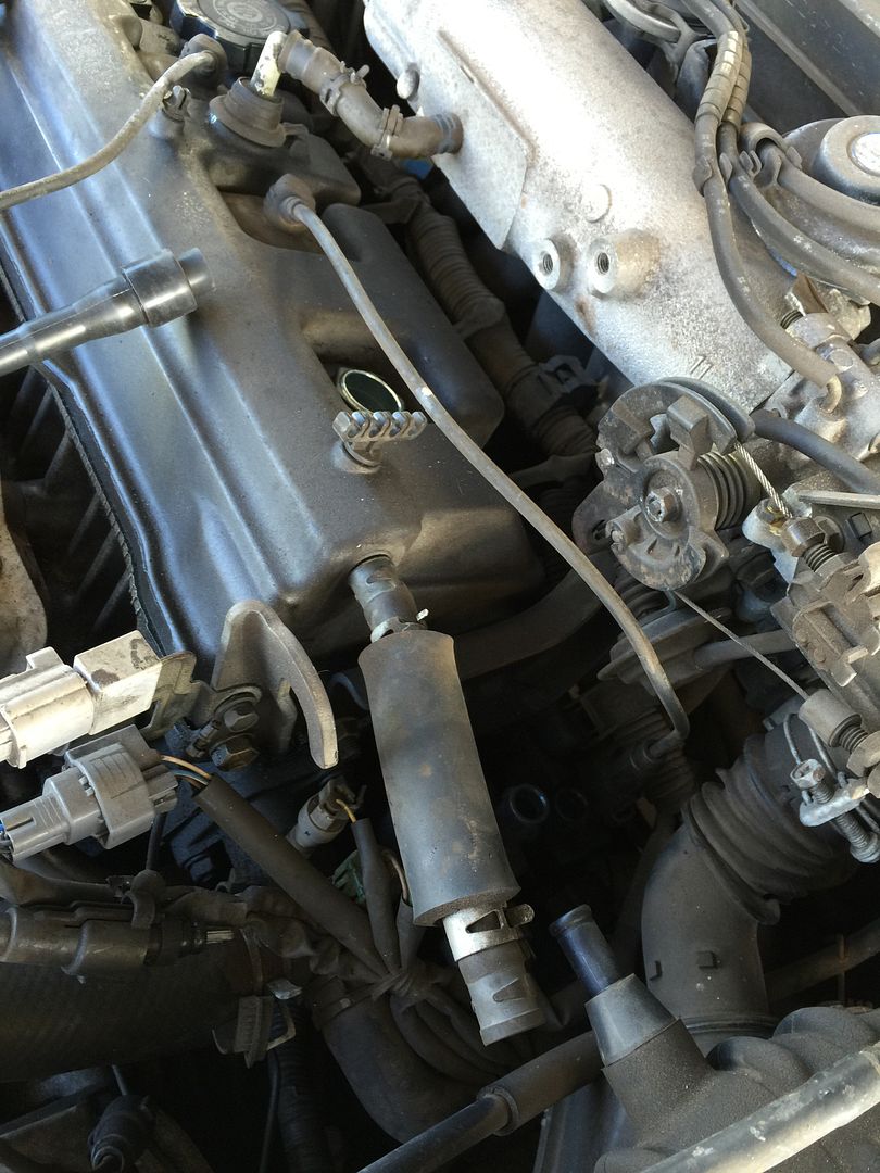

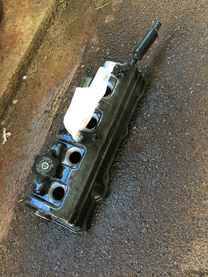

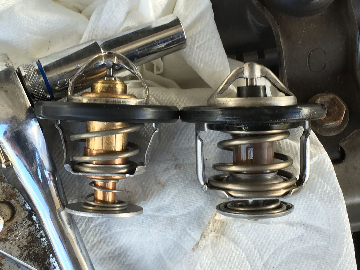

Some pictures when I did my dad's 2000 Camry thermostat and valve cover (not in order, I don't like photobucket lol)
**I'd highly recommend to also do the PCV valve and the hose. It's probably going to break when you take it off.

Those half moon plugs usually come out pretty easy. Just grab 'em with a pliers or vise grip and lift while giving them a little side to side wiggle. They're held in with just a bit of sealant. If they don't come out easily, they probably don't need resealing.
