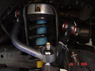

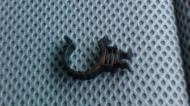

was poking around on my dirt bike today and noticed this little guy that i thought would work well to hold that wire on my UCA's.
seems to work well. i ordered a couple from my local Kawasaki dealer but forgot to get the part number. i'll post it up when they come in in a few days. they seem to hold well.
updated : the Kawasaki part # is : 92171-1437

they were like $1.60 something each i think..
looks pretty neat. but yeah like u said, the true test is to see how they hold up over time. its either those or those chrome ones that one guy posted on here. those looked pretty clean too.
let us know when u get the part number on those. there's a kawasaki dealership 10 minutes away from my house :D
but yeah like u said, the true test is to see how they hold up over time./quote]
This is exactly what I was thinking. I'd like to see it made out of metal, plastic gets brittle far to quickly. But it's still a slick idea, and a cheap fix too so you could but a ton of them and just replace them as they need it.

Well, if that part came of a dirtbike, I'd imagine it was made to last in outside weather. Looks good, get that partnumber, I'll go pick some of those up.

This is what I used,spare chopper parts,also available at motorcycle shops & web sites.Like here.
