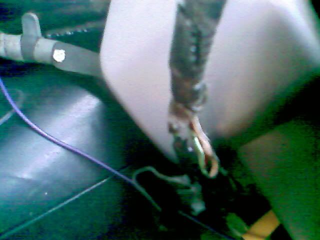

Like you said, there was a frayed wire by the trunk hinge so I wrapped electrical tape around it--crappy pic:
can a problem come from flattened wires? All of them at that bend are flat.
What is this for? There's nothing connected to it...

Some of those flattened wires could be broken inside. If this doesn't fix your problem you may have to open up a couple of them. Look at the tail light sockets themselves and notice the color of the wires there. Now go back to the flattened wires in the loom and peel off the insulation of those colored wires and check for breaks. Repair the breaks as you find them and then wrap them with electrical tape.
I'm not sure what that connector is for. If there is nothing back there to connect it to, then my best guess is that it's wiring for a power antenna that your car probably doesn't have.
