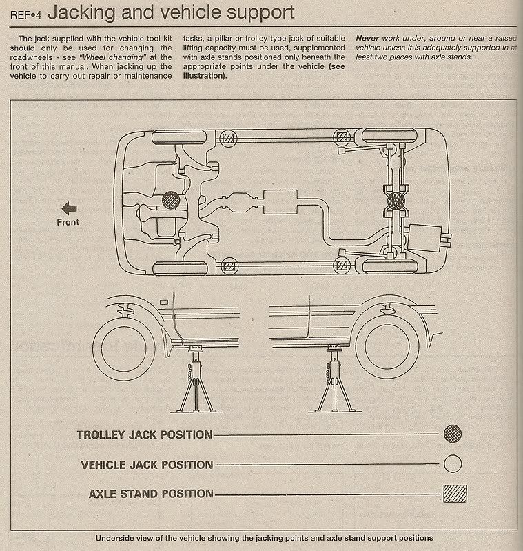

And now I have to get the obvious, noob questions out of the way. I have never jacked up my car, and didn't even know I had a spare tire and jack in my trunk until a few weeks ago, lol. Are there any key spots on the frame I should look for the jack to "hook" into, or does it just set on the jack anywhere on the frame? I don't have any car stands either. I image if I am looking to do my own CV joint and strut work myself I will need those? Any idea on acquiring the most basic cheap car stands? Can I get by with only 2 of them?
You can pick up some decent quality jack stands for a great price these days. As long as you have two of them (one on each side) you'll be fine. You could use ramps instead if you wanted to. There are certain spots on the frame where you should always jack from. Rather than explain them, here's an illustration I just photocopied from my Haynes manual (if you'd like a clearer picture let me know and I'll send you the full resolution un-resized version) -

Great to hear that you bought a Haynes manual. You won't need jack stands to change the oil but they could come in handy. Since your car is at factory ride height, it'd be easy to get under there to undo the sump nut. They'll come in useful for changing your brake pads though, as they're a lot safer than using a trolley jack or the factory scissor jack.
