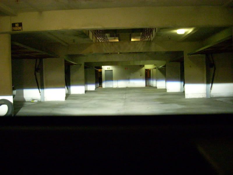

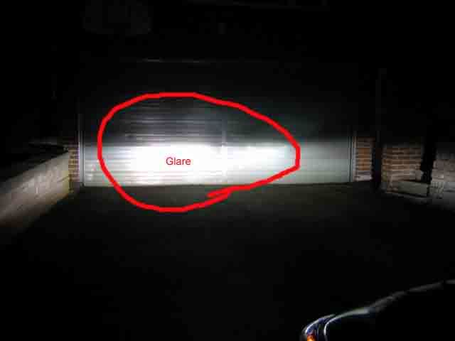

Retrofit. Perfect cutoff lines.
Halogen housing...a lot of glare

Take a picture directly of your car head on and one against a flat wall, and I will guarantee you that they will produce massive amounts of glare and hot-spotting.
I have done that to my old mazda with stock halogen housing. It looks cool in color but the light output is everywhere, it is bright but they don't focus at a point, you will see whole bunch of light going on in front of you car. And It did have alot of glare.
