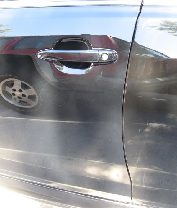

Hey guys, long story short, I had to have my front driver side door replaced and the body shop had to repaint it to match my car's existing color. I have already come to realization that the results will never be perfect or like factory condition. However, looking at this picture, do you think I have a legitimate grip or do I have to temper my expectations?
In direct sunlight (as seen in this picture), the door looks almost gray to me. I have to admit, its not as noticeable in the shade or when it is not in direct sunlight. I am bringing my car back to the shop after the long weekend, do I complain and demand a better job or are the results to be expected? I have little experience in color matching, any opinion or insight is much appreciated.

Is it hazy or is it literally grayish? Sorta hard to see in the pictures. If you are around Mission Viejo or Fullerton I can take a look at it and give you my opinion.
I am pretty picky since my closest friend is a painter, but that is just horrible even to the average person... Wow, I can't believe they let it leave the shop looking like that... I would have been highly pissed...

I took the car back to the body shop to complain about the poor color match. They apologized and said the reason for the color difference is because they did not polish/buff the surrounding door/fender/pillar. Apparently, because the new door was polished/buffed, it reflected light differently under the sun. I was skeptical, but I wanted to let them try to resolve the issue before I escalated my complaint. (They also commented that my original paint had orange peel).
Regardless, I gave them my car and picked it up the next day. They buffed/polished the entire car and sure enough the color is now a match. I have looked at it with a critical eye and from every angle under the sun and so far I'm satisfied with the results.
