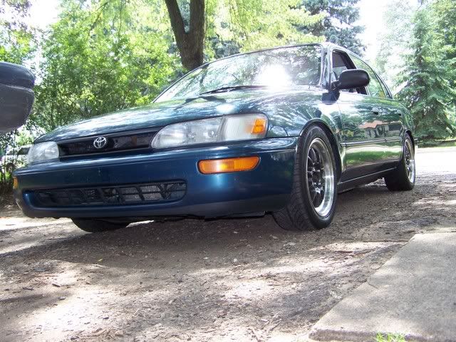

what I recommended beforeIn that case, you would be better off with a 16" wheel...7" wide, and run 205/45/16 tires.
In terms of offset, you would be looking at a +40 or +42, you should be able to get away with that sizing without rolling your fenders.
Even at stock height? Any pics I can look at? Thanks for all the help and patience Phat!!!!what I recommended before
