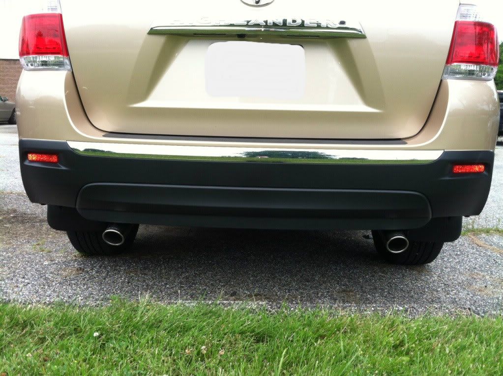

Just had custom dual exhaust put on my 2012 HL. Had my custom muffler shop do the work. They cut off the factory resonator at front pipe coming out of the big muffler (looking from the rear of vehicle). Then they fabricated a y pipe they welded on the the front of the muffler and welded two pipes out of the y pipe that went on each side of spare tire and out the back of HL with two stainless steel magnaflow tips. I did not like the way the exhaust sounded at wot, it sounded really metalic sounding. So I wanted to put the factory resonator back on between the cat and the muffler but there was not room because of the diameter of the resonator was to fat. So they welded a bottle type resonator right after the cat because that was the location the heat shield was. It sounds a little better at wot but not the way it sounded when it was factory. It sounds a tad louder at idle thru highway speeds. Over all I'm happy with the sound and love the way it looks, because the dual tips out the back is the look I wanted in the first place. It cost me $360 + tax. see pics below.

Thank you for answering my request, they really do look good :thumbsup: and it's one of the items Toyota needs to OEM on the Highlander.
Looks pretty good, but not sure it's worth it to me. Not sure why it's isn't standard on at least a Limited but cut into the bumper to get them off the ground more. Dual exhaust has become standard fare on about every other brand's Crossovers and most cars. I would definetly like them on mine if they were factory installed. I guess my only question would be could such a modification effect the warranty in any way?

I agree Toyota should offer factory duals as most of all suv's and crossovers do. I would like the cut out in the bumper trim to make it look more factory and to bring the tips up a little also. This is the reason I had the tips slightly pointing down so the pipes the tips are welded on to could be tucked up under the frame more as not to see them from the side view. I ask my dealer here in Maryland about any warranty issues and they said as long as from the cat to the engine was not modified there would not be any warranty issues, but they did say the muffler warranty would be void as the pipe between the muffler and the factory resonator was cut to remove the resonator. That is no big deal to me as I will replace the muffler myself when need. By the time it's needed my warranty will be up anyway. The shop that did my truck said that they get brand new vehicles in from the dealer with 5-10 miles on them that they do custom duals on that was requested by a customer thats buying the vehicle with single factory exhaust. Over all I really like the look and I didn't notice any difference in performance and no service engine light.:thumbsup:
