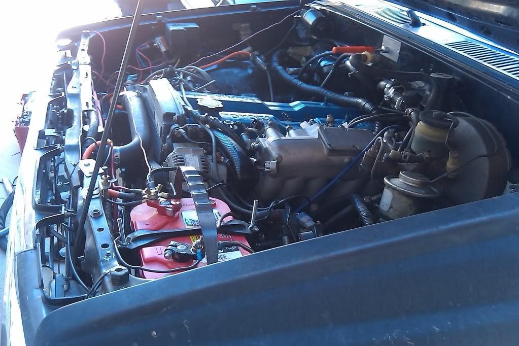

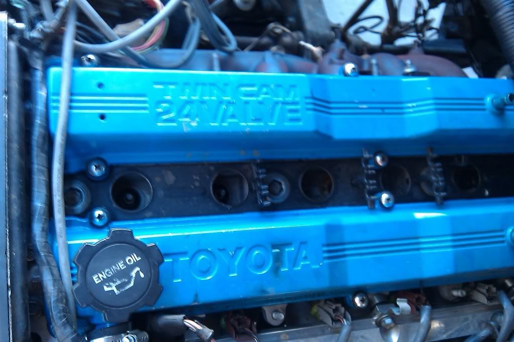

had to cut the radiator support out and move the radio far forward but other than that the motor bolts right in. there is alot of write ups online.
i will tell you this thing is a beast compared to my 22re
