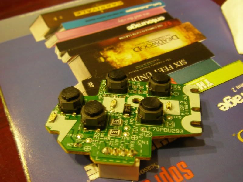

7) Pull the black cover to expose the electronics board. Unscrew one more screw and pull out the electronics board.
You can see the ugly green LEDs
New LEDs... all 50 of them... hahaha
Size of LED compared to a penny
8) I was stumped on how I was going to pull out the LED... If you get a knife an stick it in between the Led and push, the LED will pop right out.
It'll keep the prongs that fit snuggly with the grooves on the new LED's shown above with the penny
9) Solder the new LED's and use reverse steps to put everything back together

nice job! just a suggestion for removing the old leds though... if you can heat both sides/solder pads quickly, you can "flick" off the led with the soldering iron. removing it by popping it off runs the risk of removing the solder pad completely... not easy to fix! i can understand leaving the solder in the original shape to help keep the new leds in place, but its not a good idea. as an alternative, you can put a dab of glue to glue it in place, then solder it. or if you're dexterous enough, leave one pad with solder on it, then use tweezers to place the led while you heat up that pad with the soldering iron.
Camry
10,019 Posts
The way you removed the LED is not ideal because it could potentially take the traces with it. At work, we use heated tweezers, but you could also use desoldering wick or heat and lift method.

thanks for the words of advice guys... hahaha, you can probably guess that it was my first time at soldering, which it was, and I guess i'm lucky that the solder pads did not pop off for all 5 of the LED's... I think I did pretty good for a first timer working with LED's the size of bread crumb
I'll keep the soldering tip in mind when I attack the stereo and HVAC controls
