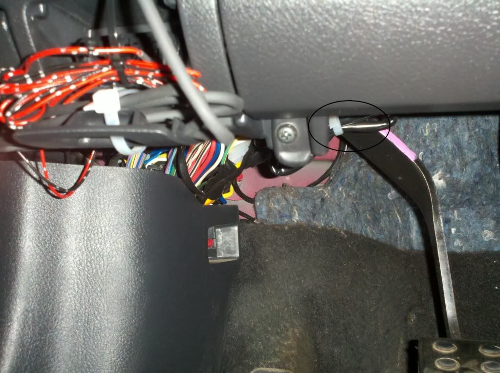

Here are some pics just to show you how and where its mounted. We will have to do something about all those wires, cause we cant close the cover anymore, so everything's just zip tied together, doesnt get in the way or anything but we'll still have to come up with something to cover it completely.
Where you see the drawn circle is the other harness coming from throttle, its ziptied and tucked in front and away from the clutch, so there is no interference. and you can see where the rest of the wires are and why that port cover cant be closed.

ya you are right jim, didnt think of that, then again, we were so excited we just wanted to bolt this on and go drive :lol: so didnt think of alternatives of proper placement. i'll clean that mess up today. Yes its 2ACould you run the wire through one of the blanks that it's covering? Also, did you order harness 2A if I'm reading that chart correctly?
