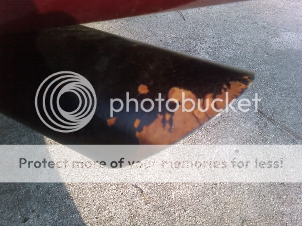

so I got some black powdercoated tips for my truck a while back. lo and behold this is what has happened
so just a heads up. don't get black powdercoated tips. it flakes off and the metal rusts. fortunately, the bodyshop is standing behind their work and is even improving it; instead of just ordering another set of powdercoated tips, they ordered a set of black chrome tips. same size same length. so im ready for tuesday!
Powder coating isn't the problem. It is the prep, quality of coating, and person applying it. Once those tips are exposed to a lift, AT's, or MT's = rocks being thrown = game over tips will look like that. I would have went with the Black Chrome!

+1 on the prep and application of the powder coat.
Powder coating should have no problem taking the heat of the exhaust since it's baked on to begin with.
I work in construction, and every time we see a problem with powder coated balcony railings, the root cause of the problem is improper surface prep, or something has damaged the coating once the railing was put in place. After the coating is damaged, it's all over. It's a PITA to do a repair, and will probably keep pealing.

I doubt the inside of the tips were prepped and coated, so it was just a matter of time before the rust worked it's way to the outside.
