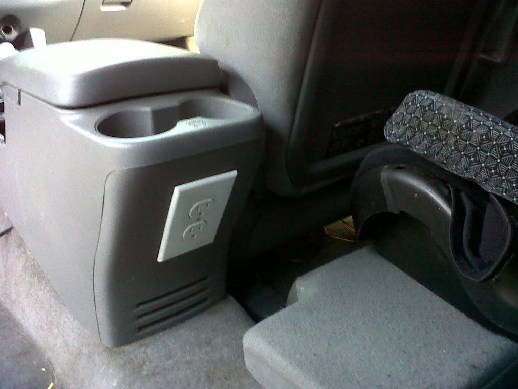

i used a small i think 150 watt inverter that pulgs into the cigarette lighter cut the plug in off wired it to the battery the took the plate off the other side and cut the wires mounted a switch and mounted the regular 110 plug that came with the inverter then got a regular house outlet and mounted it behind center console here is a few pics contact me if you have questions

1. is the wire fused anywhere? I suggest fuse at the battery otherwise if the wire chafes or wears out and finds ground you can flame your truck
2. if direct from the battery then it is on all the time= very short battery life
as it is running all the time and drawing current all the time
