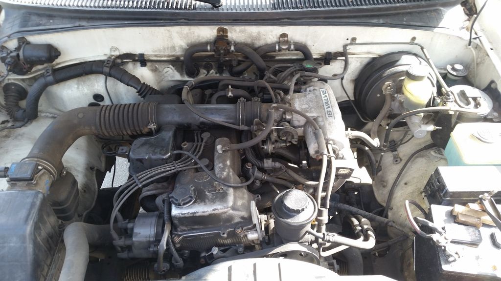

As far as yer engine dying when coming to a stop, it's possible that yer throttle body may be gunked up or the vacuum dash pot may not be hooked up. How is the engine idling (cold and hot)? Any starting issues when the coolant is at operating temp? Snap some piccies of the engine bay and post them. ;)

I'll go take some pics to post next.

Doo you see the vacuum switch on the power steering pump with the two vacuum hoses going to it? That's what controls the variable power in the power steering. When it has high vacuum, the vacuum switch allows more power to the rack. Make sure that neither of those hoses are cracked/hard or that the ports in the throttle body or air plenum are clogged. I doubt the switch is defective but it is possible. When in doubt, you could replace the vacuum hoses to that switch fairly cheaply and see if yer power steering comes back. ;)

I noticed that those vacuum lines are missing the clamps. Here's what mine looks like on my 1996 T-100 with the 3rzfe 4 cylinder engine:

I inspected them, I guess they are a little dry, I'll start by adding clips though. And see what happens. I did notice that the power steering comes back in higher rpms. Like if I sit in the driveway and rev the engine, the wheel becomes easier to turn.
