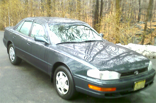

Well I finally picked it up today! Drove it back home today (80 miles). I am very impressed. The car rides very smoothly and has very good pickup / acceleration. The V6 is a nice engine, and the leather interior is a huge plus. All and all I am VERY happy with my decision, and plan on being a Camry owner for years to come. I will post better pictures later or tomorrow.

Nice..how much did it cost you? Looking for one myself!

I picked up the car for $2,000 (it has $2,000 worth of new parts/labor in it)

Luckkyyyyyy (in best Napoleon Dynamite voice possible) :clap:
....pegs, shocks, LUUUUCKY!!!
wow...looks like u got yourself a deal. all the problems u listed are pretty minor and can be taken care of with a trip to the junkyard/you-pull-it and autozone. i recommend doing research on how to correct all your problems only because thats the only way you'd actually learn anything about your car.
for the moment, i would focus on bringing your car back to near-showroom condition before investing in aftermarket products.
its never too late to switch to synthetic oils.
also, if you do go to the you-pull-it, u can learn how to fix things without risking damaging your vehicle.
anyway, congratulations on getting a V6 Camry. I've been in the market for one, preferably a coupe :-D
