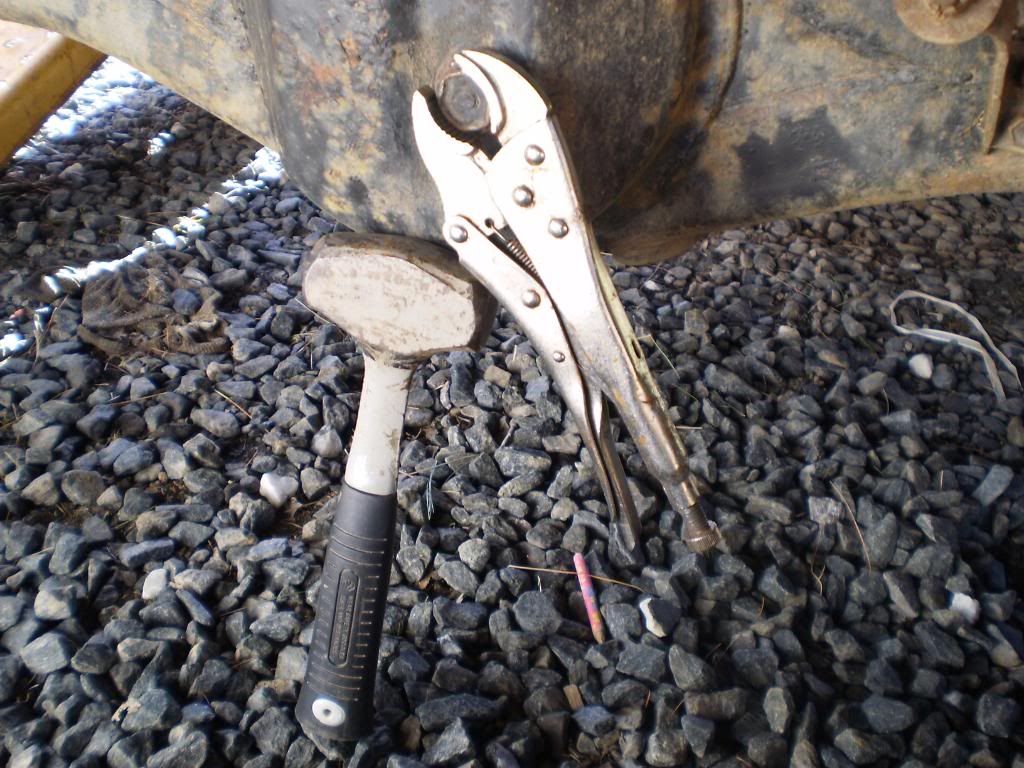

first, i cleaned off any dirt etc from around the bolt.
Tools needed-
old rag
grease remover(greased lightning)
8inch vice grips
a small hammer(i used a 2.5lb mini sledge
ok, so here we go
first off, after you cleaned it off, do the following
then, take the hammer tap the jaws on the bolt fully, make sure you get them really tight, now tap the back handle of the vice grips, and it should come off, it will look like this once you get it off

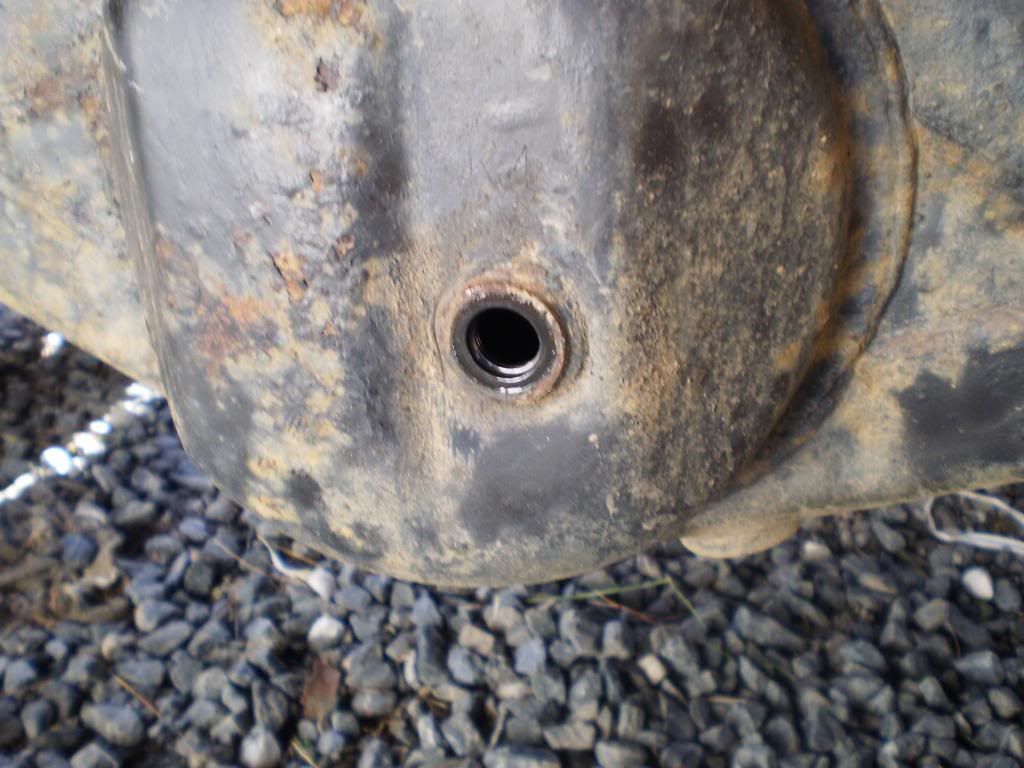

now you can just add the gear oil into the hole, until it is level, MAKE SURE TRUCK IS ON LEVEL SURFACE!
now once you get the gear oil in, just put the bolt back in, tighten it the same way you got it off, and you should be done
like always, i would clean the area once you get the bolt back on, to make sure you have it tight enough and make sure it isnt leaking, if you clean it, and after a while theres grease there, of course, you should figure out fast its leaking, lol
there ya have it

Actually...if yer taking the bolt off...the best way fer the vice grips to do the work without stripping the bolt head is to switch it so the non-adjustable side is on the left and not on the right as you have it pictured.
You shouldn't have to tap the locking mechanism to fully lock the vice grips. It should be really firm to lock them but not to the point where you had to pound it closed. You do have it locked on the flat sides of the bolt which is the correct way vs on the points of the bolt head.
Also...you should use the poor man's creeper fer a surface like that. I bet them rocks didn't feel very well, eh? Poor man's creeper you ask? Cardboard.... :D
no you misunderstood, tap it to get the bolt of, not to close the mechanism!!
IM USED TO THE ROCKYNESS, LOL IT AINT THAT BAD, I HAVE A RUBBER MAT FOR WHEN I HAVETA LAY ON MY BACK
The Top Picture Was The One Where I Was Putting The Bolt Back In, My Apologies, Lol Flip The Vice Grips Around For Removal
You mean until it is level with the hole? I have been wanting to attend to mine but haven't had time. Also, dumb question, what kind of fluid do you put in it? will the stuff actually say "gear fluid" on it? or...?
You want the truck on a level surface so the fluid level isn't biased to the front/back/left/right.
Yes...you want "Gear Oil"...I'd recommend synthetic 75W-90...you'll need just over 1 quart fer the rear axle. :D

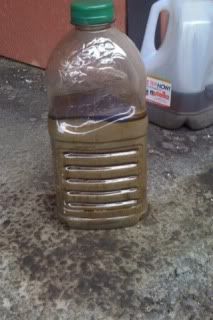

Well I drained and refilled my rear diff gear oil, looks like I needed it :). Thanks for this lovely post that inspired this :)
ew!!
Um...milkshake means you definitely need to do the remote differential breather mod. ;)

It's always a good idea to change your axle lubricant if you dip the axle in water. Such as with a boat trailer launching duty. The fluid above has water in it, that's why it looks ugly. Depnding upon your climate, you can use 75W-90 or 85W-140 (that's in mine.)
