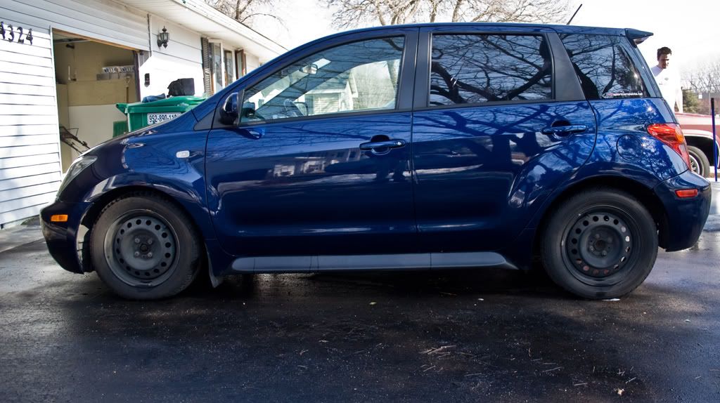

Here is my car with the eibach sportlines (lowers it more than the prokit)

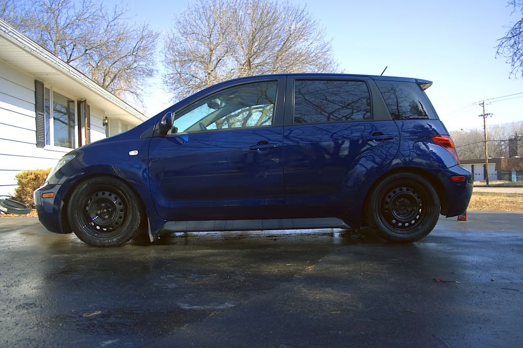

^That was the first night I put my Tanabe DF210's on, a nice 2.2" drop all around. I am on 215 40 R17's as well and it got rid of my wheel gap. I love it.
I only put the springs on and Hotchkis Front Sway Bar.
This is a few months ago but it gives you a better look at the drop. Mine is the one in the front of the line.
