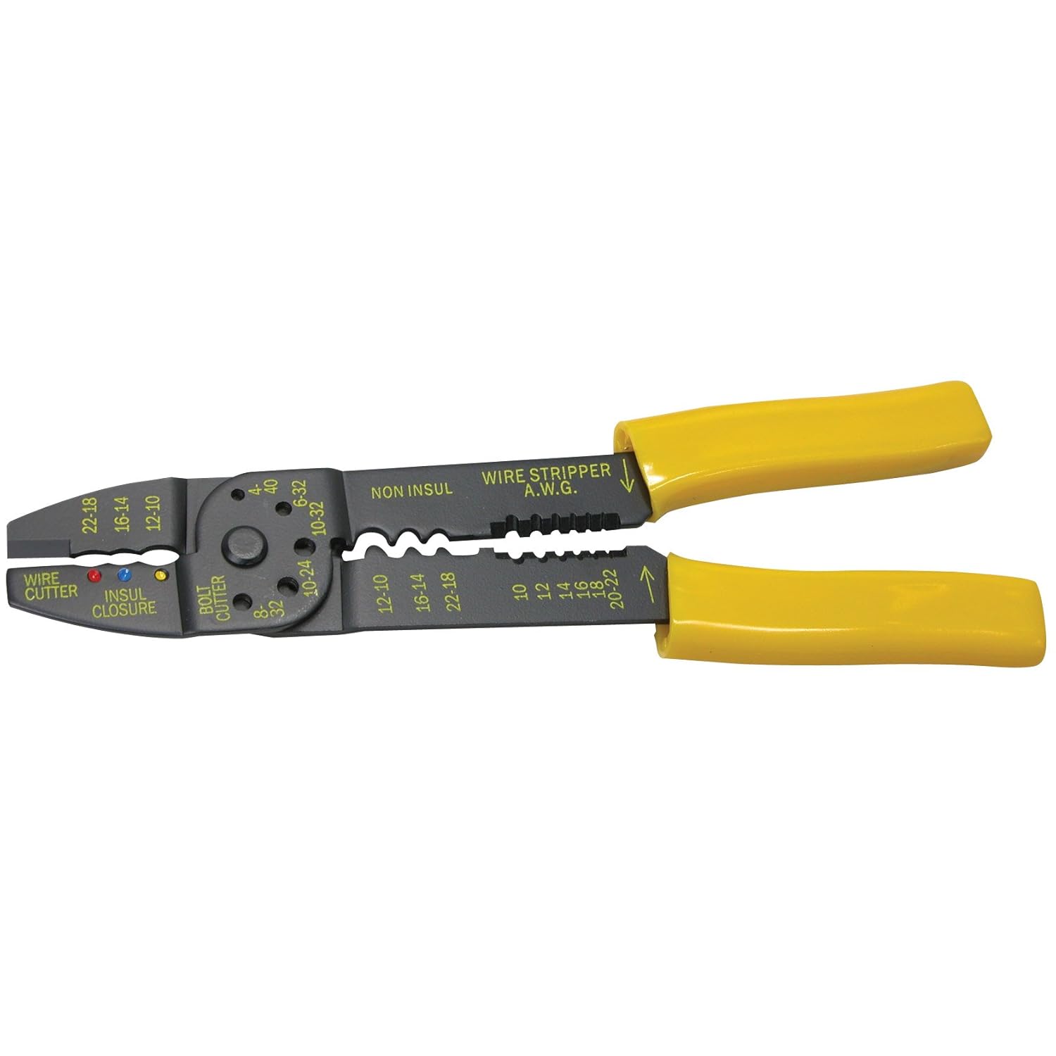

I'm also unsure how you are using a wire crimper to pop the clips. Perhaps a really thin one like this and using it like pliers to clamp on behind it and then lever it out?
