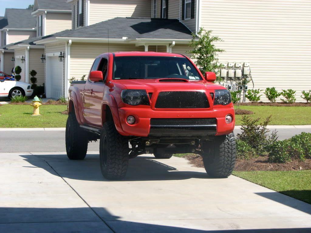

As of 6/19/09
6" stage II procomp lift, with 1/4" top plate spacers
315/70/17 Firestone Destination MT
Moto Metal 957 Black rims 17x9 4.53 BS -12 Offset
Here are some shots of my FX-R OEM Retro, and a few of Yosh's blue/red LED dash lights.
