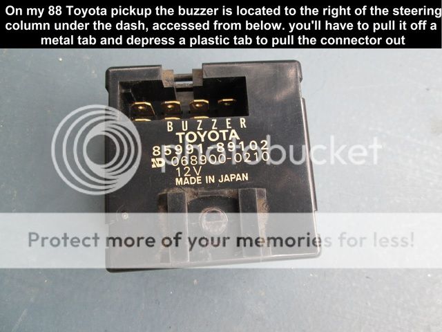

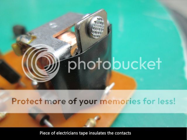

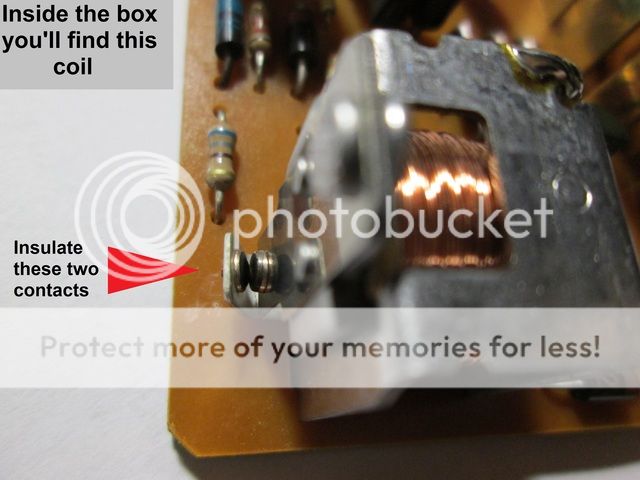

You could just unplug the buzzer and throw it in your toolbox but depending on the year/model
you might lose features you'd like to retain, such as door controlled cab lighting, headlights on
reminder or the ignition key light. here is an easy way of silencing the buzzer while retaining
all the original features
