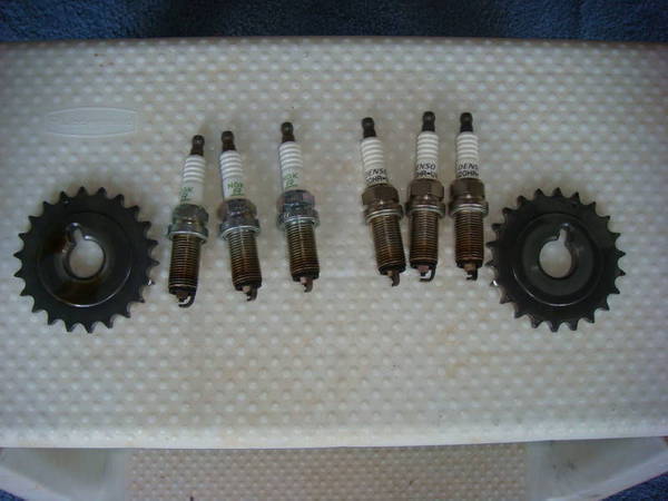

Here is mine just after 10000 miles
Notice that they are two different type plugs. And all the gap sizes were off.
I now run all Denzo copper, gapped @ .40
The Denzo Iridiums are the high milage plus recommended for our taco's. Personally I rather check up on em every 30K or so. 100k is a bit to much IMO Iridiums or not.

you bought this truck new? if you did, why in the hell would toyota/dealer put different plugs in? that's retarded. :confused:

I am not the first to discover this...
But +1 it is very retarded. And yes I speacial ordered my Taco.:D
you will have to ask toyota that question..ive seen on here befor thats the way they come from the factory
i've never heard of that before. i've been wanting to change mine real soon. i guess i'll be doing it quicker than i thought. i wanna see if mine are different.
It is strange,but I read somewhere the reason was to keep the 2 suppliers happy.Makes no sense to me,why not just alternate every other truck instaed of mixing 2 brands in 1 truck.Who knows?

Mine were different brands as well between the left as right banks, as pictured above.
I pulled them out around 50k and the gaps were huge. Made a little difference in the mpg. I bought the pre-gapped Denso Iridiums as well.

I changed my plugs @ 30k and yes Toyota uses two different plugs, Denso and NGK. When I went to the dealer though, he gave me six Denso plugs saying that was the part listed in the system.

FYI on the 2 plug types. When my dad switched to working on toyotas in the early 90's, that was the first thing he noticed about the V6's...that toyota put in 3 of one type on one side and 3 of the other type on the opposite side. He was told by toyota in training that it was to maintain an equal support for its 2 plug suppliers. New to me though that they're now doing it in the 4 cylinders too. I'll have to pass that on to him since he's been retired for many years now.
As for how far the standard 30K plugs will go...well that depends on who you talk to. There's been other threads in here about that topic. I changed mine at 48K miles and they could have gone to 60K easily. I've seen others' pics on here though where they're worn down/burnt really bad at 30K miles. So it just depends on your truck and how you drive it (or possibly the gas or environment)?...rhetorical question.
