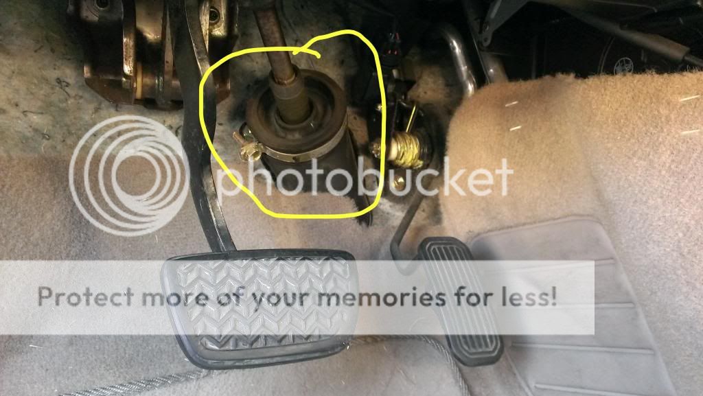

The steering shaft runs through a rubber grommet in the fire wall of the car. you need to lube up that interface, I am 99% sure thats where your squeak is coming from. I've had to do this on more than one car in the past.
Lithium Grease works, but is kinda thick to get down inside it.
a good teflon-loaded spray type lubricant works as well, with the little straw so you can get right down inside it.
this good stuff (made for guns actually) called Rem Oil works really well for me, you can get small cans of it at Wal Mart I believe.
just stick the straw down inside the gap, give it a short squirt at about 4 or 5 points around the shaft then start the car and do some lock to lock turns, should stop squeaking pretty much immediately

repocop is right, there was a post about this at one point. its the dust boot at the bottom of the steering column. almost all toyotas do it after a certain mileage for some stupid reason. but another thing to check out is the clockspring in your column. not as easy to get to as the boot, but i just had the squeak checked out and the guy heard it comin from the clockspring. that's a new one for me. just and FYI for yall.

Correcto ... just lube up the linkage at the boot which meets where the linkage goes through the firewall .. just solved the same issue on my 98 ES300 recently!
