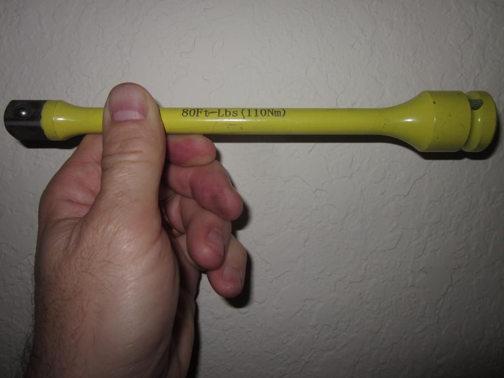

To torque the bolt, I use an impact wrench with an 80 ft lb torque limiter extension. Works great and super fast.
