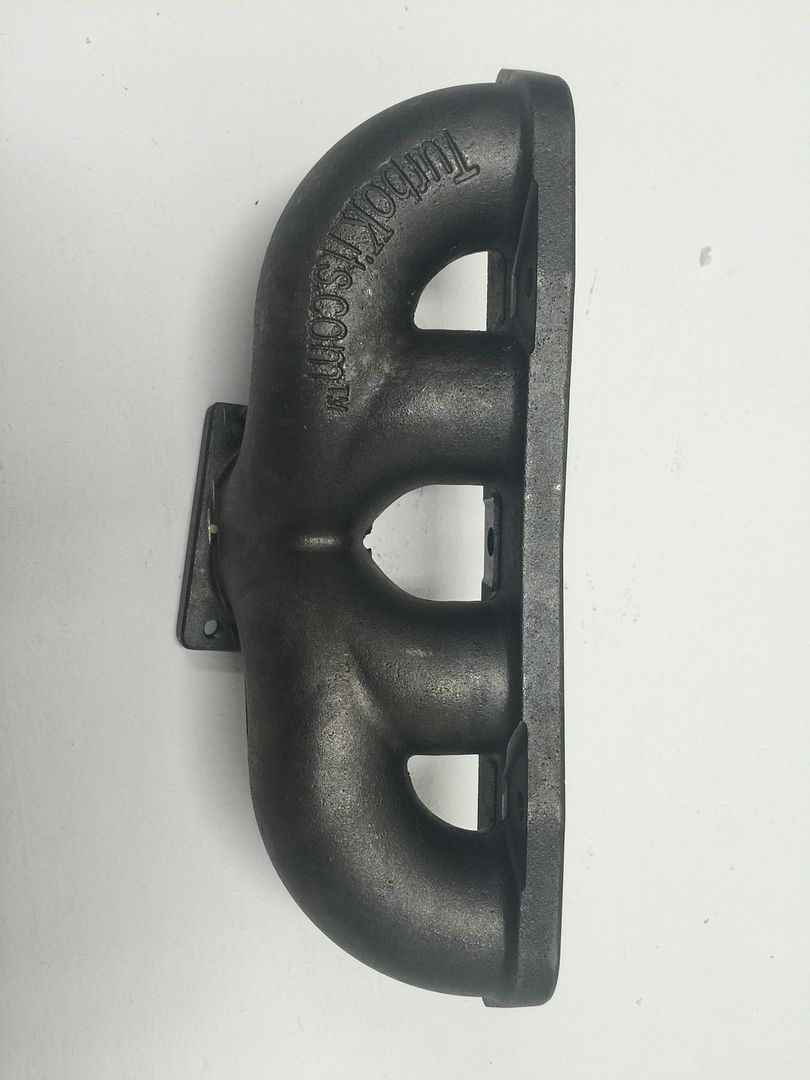

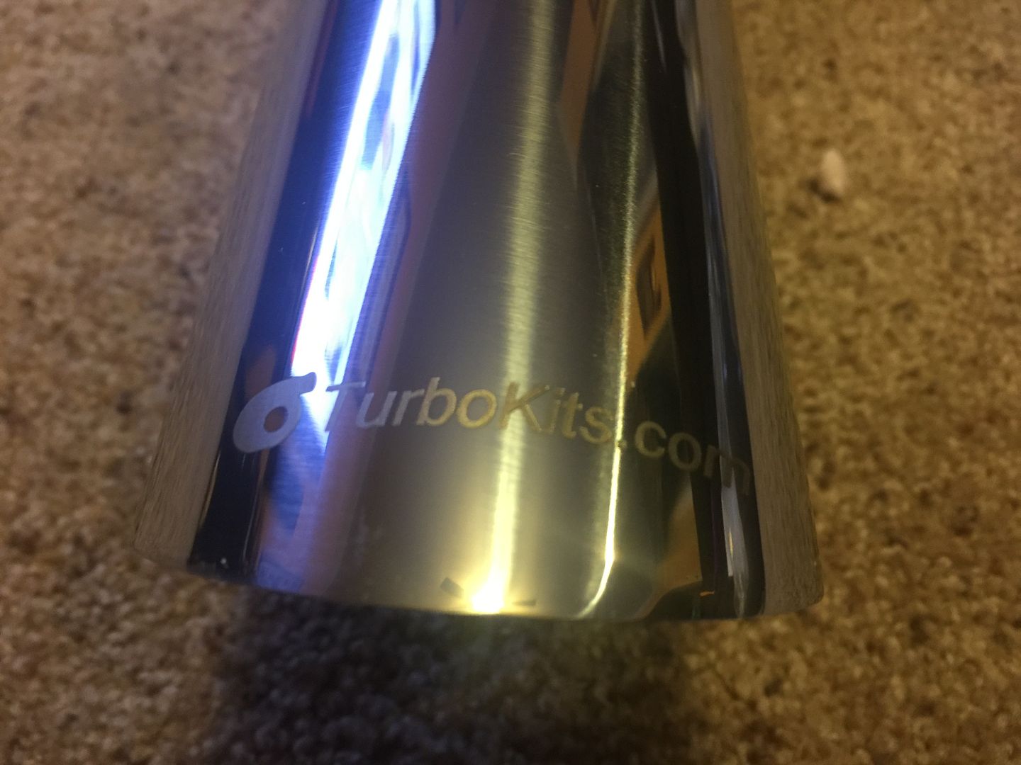

The exhaust manifold is beautiful and stamped with Turbokits in the casting. Take notice that this isn't a cheap e-Bay welded one that crack and fail.
These are all exhaust manifolds just for our Corolla/Matrix 1.8L kits!!

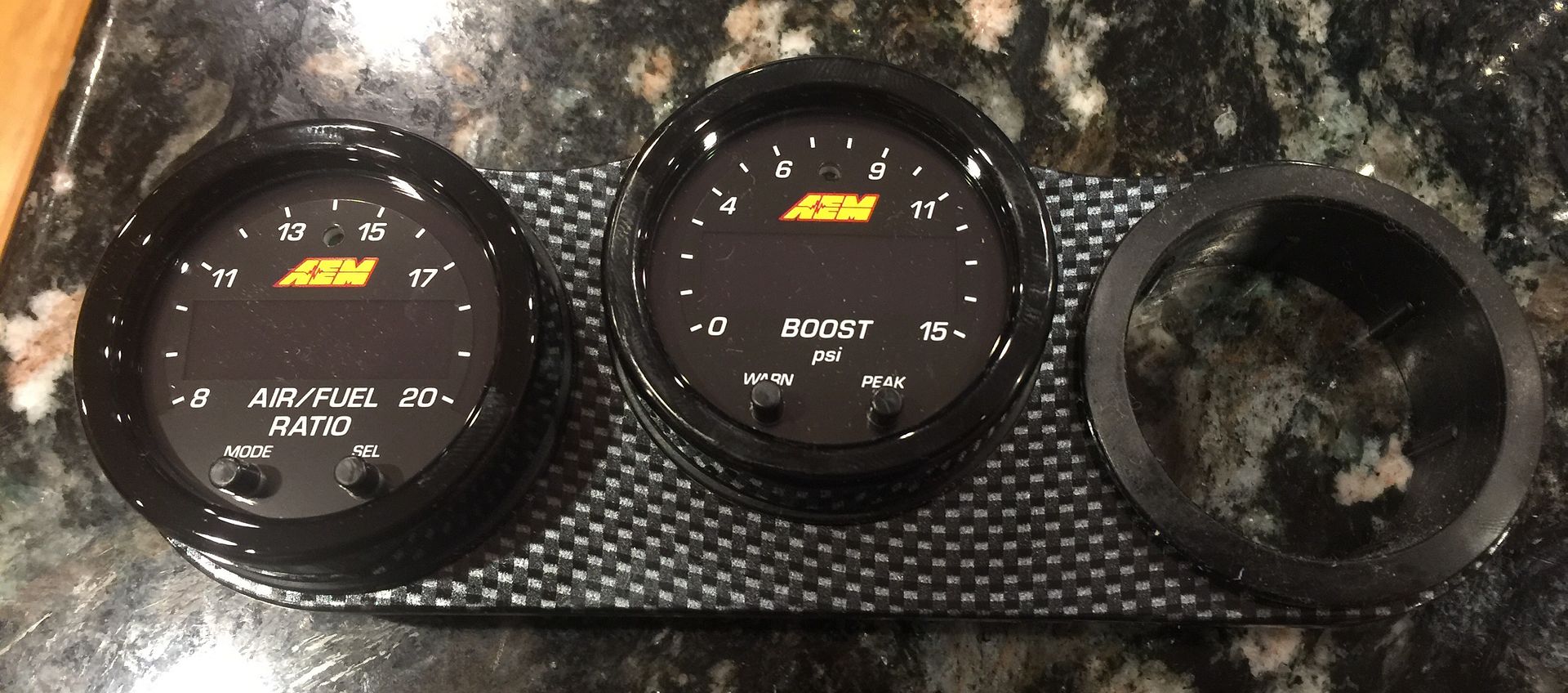

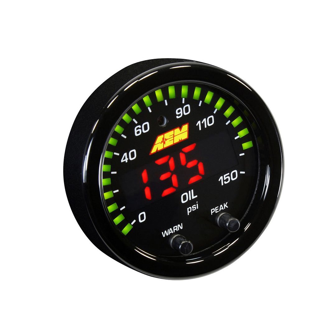

I ordered 3 gauges for my turbo build. A boost gauge, A/F ratio gauge and oil pressure gauge. Here is what they look like.
AEM Boost Gauge
AEM A/F Ratio Gauge
AEM Oil Pressure Gauge

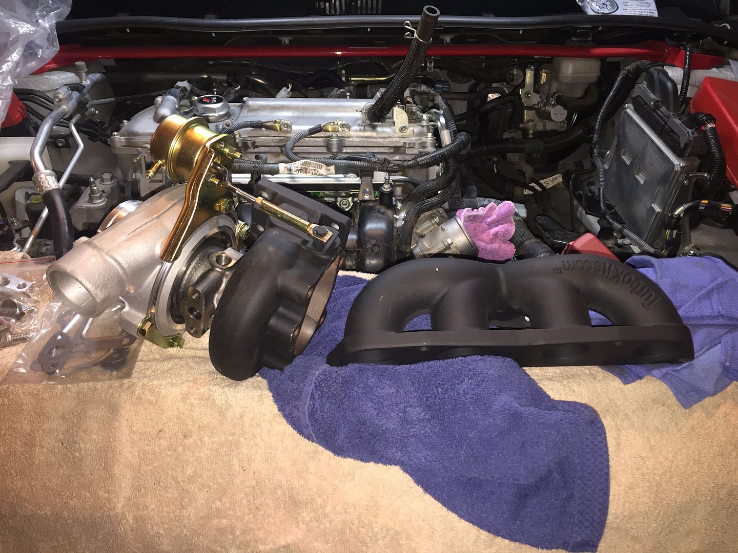

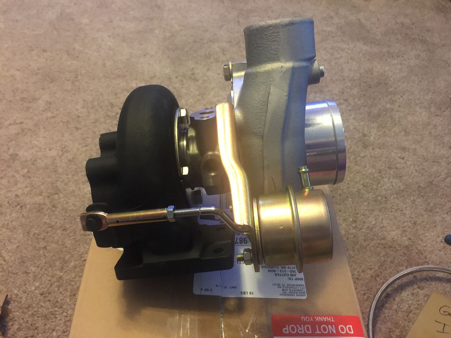

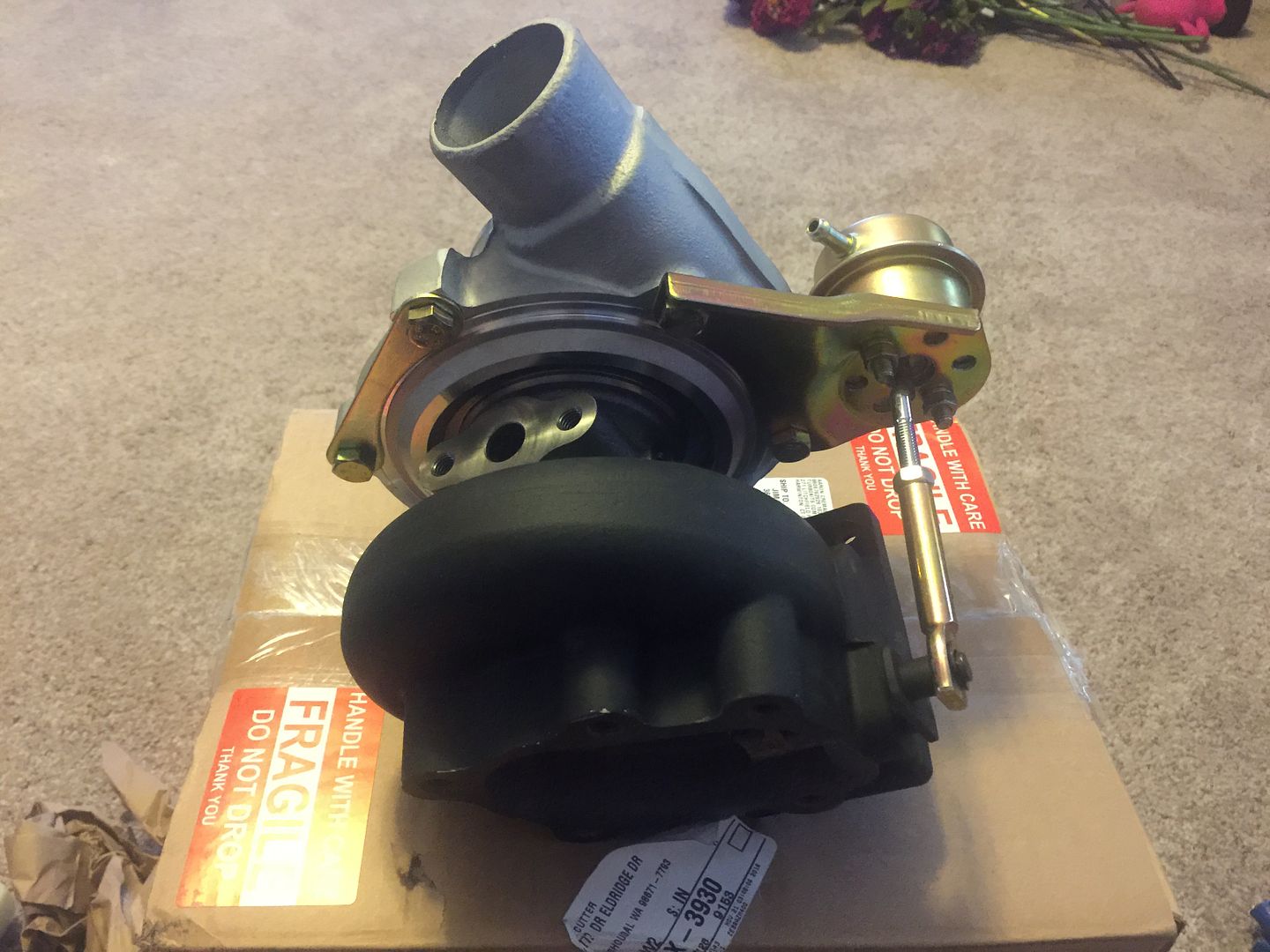

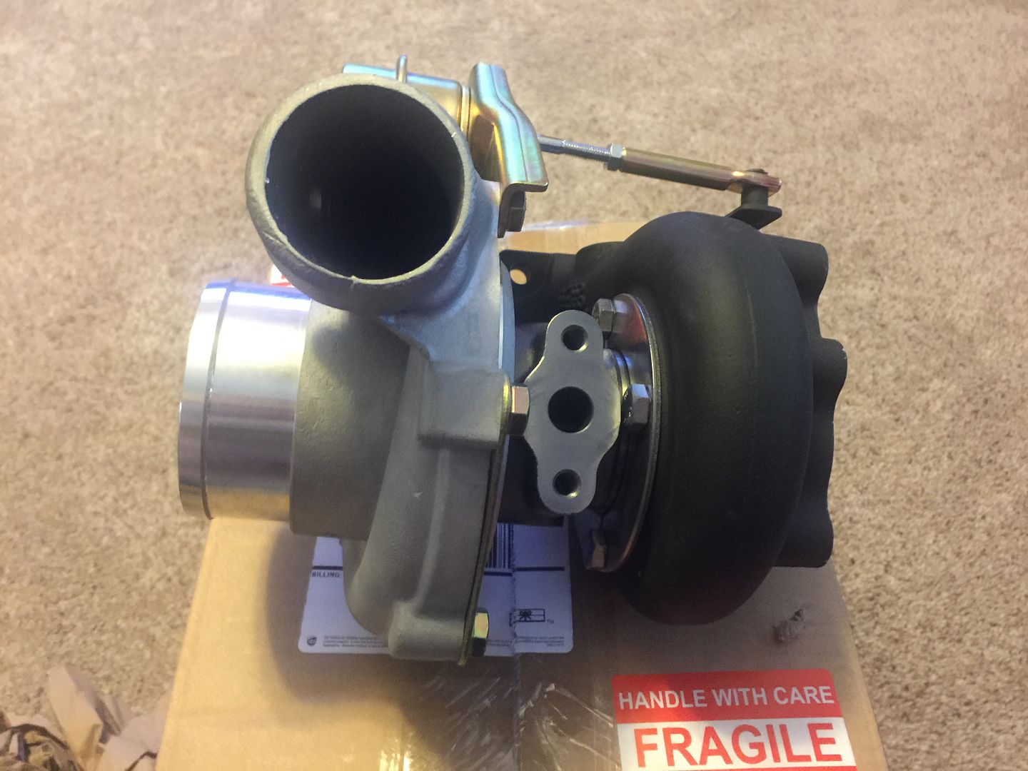

Started to unpack the boxes. Here is the turbo. The dark side is the hot side that was ceramic coated.

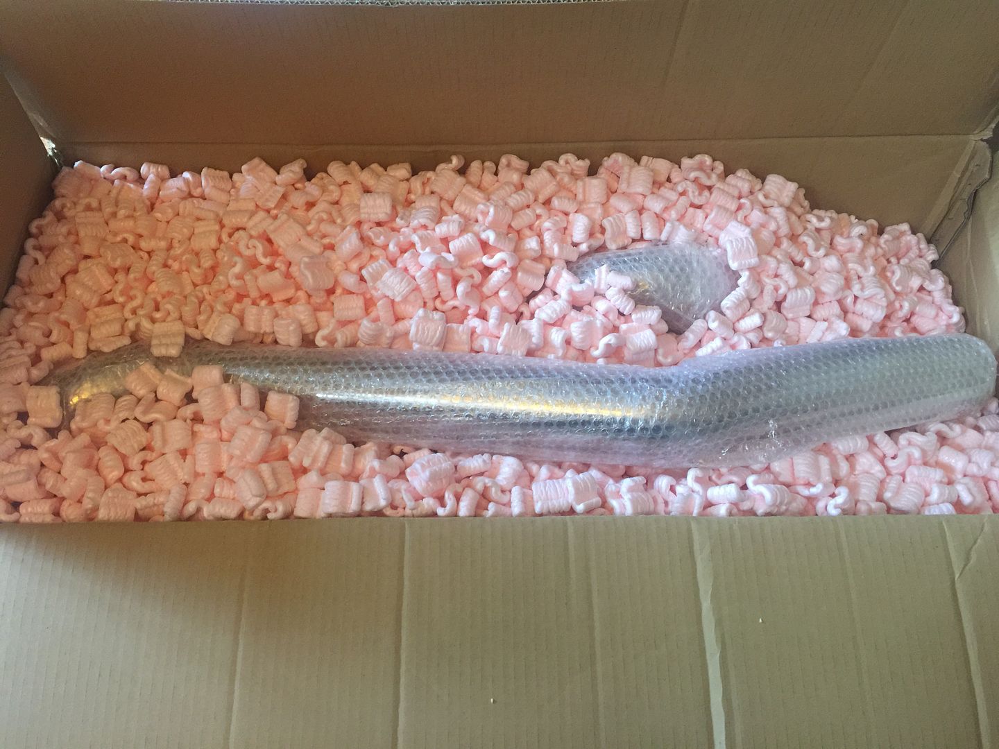

Exhaust system is in this box.
Intercooler pipes!

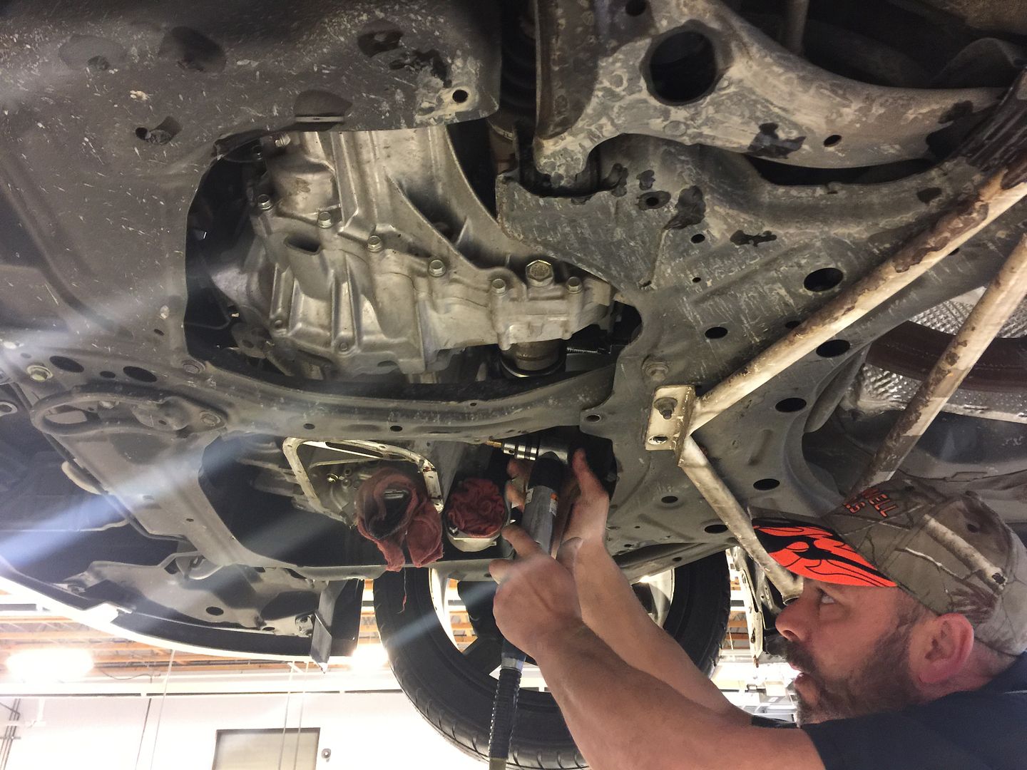

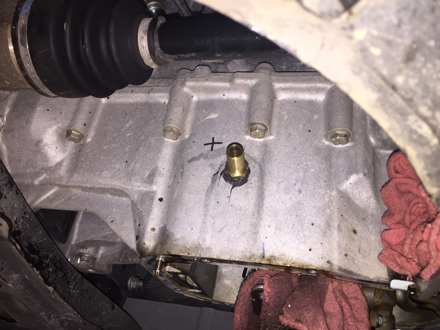

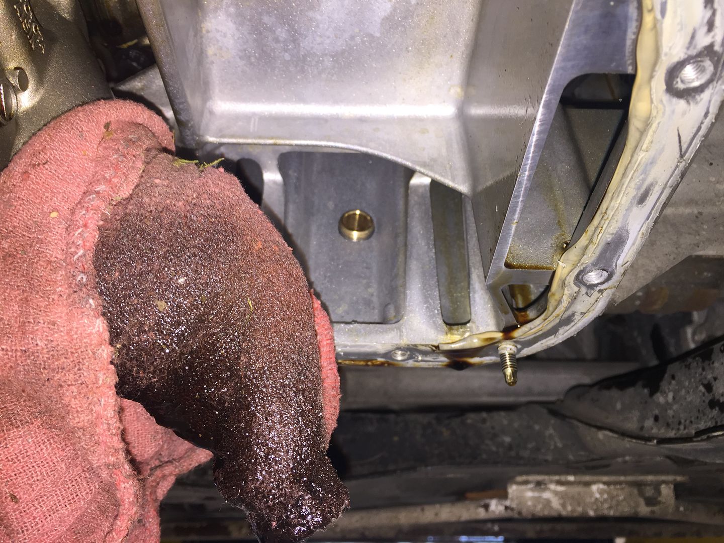

First step will be to get the oil drain drilled and tapped. I need to see if my friend can help me before Thanksgiving so I can work on it as I get time! :grin:

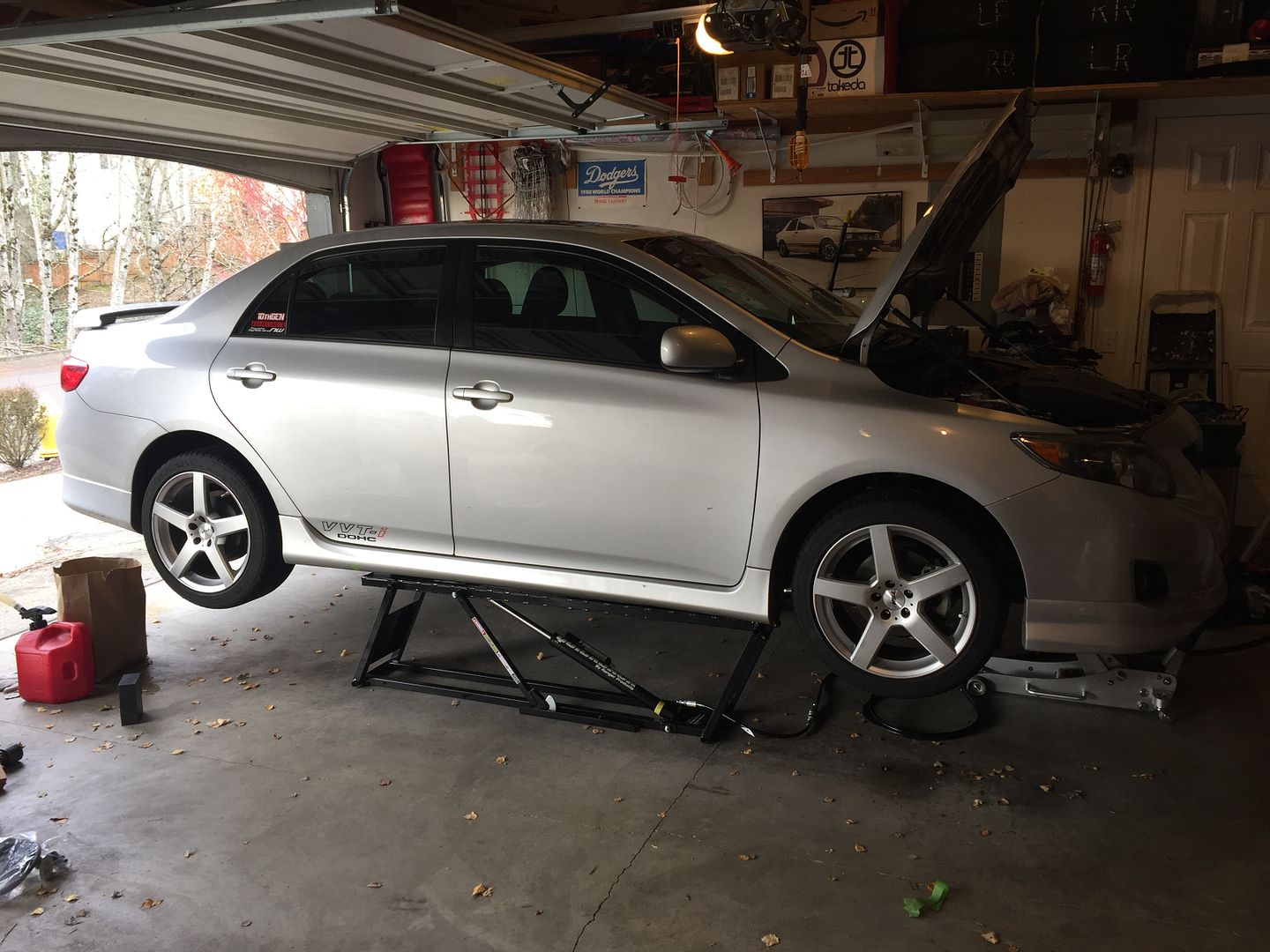

He's got a full size lift which will make that part much easier and allow us to stand up while working. I'll then drive it back to my house and start working on it. I will run regular 5w-20 oil for the first 500 miles for the turbo break-in and then swap back to synthetic.
