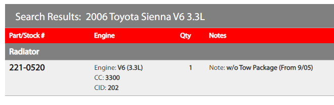

Searching on Denso Auto Parts, I see only one radiator available (w/o towing package). Denso is an OEM maker of Toyota parts.
And then on rockauto.com I see 221-0520 at $176.99. And yes that's nearly twice what smaller cars like Corolla and Camry's radiators cost, yes kinda expensive for a Toyota. I do see TYC with lifetime warranty that share the same Toyota 160410A380 part number for $89.79. No doubt why the heart symbol shows it's a popular item, along with Koyorad at $99.79.
If you can use Denso I'd go with it. TYC is my other go-to.
