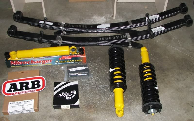

My rear leafs were worn out and sagging badly. My front end had a spongy ride. So, I decided to go the expensive route & get all new suspension. I went with Old Man Emu 881 coils up front, and Wheelers' house-brand 5 leaf rear spring pack.
I found that the 881's ride rougher than what I want, but I'm not shelling out another grand to change it right now. Maybe they'll soften up after I get a few thousand miles on them (wishful thinking? maybe). I've been thinking about putting a beefy front bumper & winch on anyway, that'll help some with the front suspension.
I also found that the 5 pack in the rear didn't lift as much as the front, so I added an add-a-leaf to the back. This made the back ride incredibly rough as well.
It's a great setup for off-roading, When I get up any speed, it smooths out the tight suspension & gives me really good control. On pavement though, it feels like my axles are welded to the frame, lol.
Here's what they sent me, and a before & after pic. I also put on fender flares when I did the lift.
