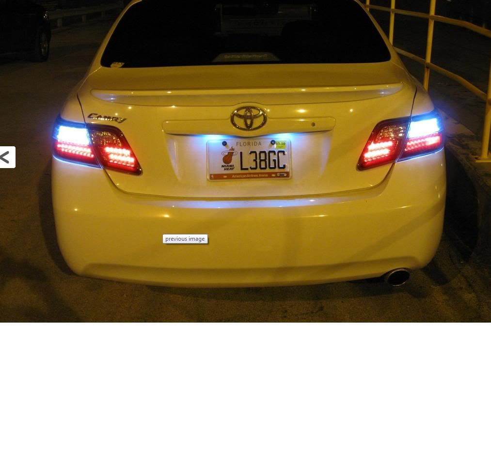

Those are not just LED bulb replacements in the picture you posted. That person replaced his entire tail light fixtures with versions that have LEDs. You can find them on eBay (or at least used to be able to) and there is a DIY guide somewhere in the forum on how to install them.
If you just want to replace the bulbs with LED versions, there are a bunch of places on the forum. Try doing a search. SuperBrightLEDs.com seems to be very popular, but V-LEDs.com and a couple of others seem good also.

I think he knows its the whole fixture that was replaced. He was inquiring about the turn signal and reverse lights.
Reverse light bulbs are 921. They are night bright during the day and not visible. Its good at night. I have reverse bulb lights that I dont use and want to sell.
superbrightleds.com has a kit that lets you splice wires to let you use LEDs in the turn signal. I would do it but I dont like cutting/splicing into factory wirings unless I really have to.

Hey guys, just to tell you, I"ve replaced just about every bulb in my car with LED's. The hardest ones by far are the blinkers because they screw with many things. For example, they will/can A)Blow your relay, B)Cause "hyper flashing," C)Blow the blinker fuse, D) Affect the overall voltage of your chasse, causing interference in other systems like the radio (since your chasse is your antenna). Proceed with caution because I've had all the above problems even after doing careful research. Also, superbrightleds.com sells a special blinker relay for LED blinkers. I will tell you ahead of time, this is a tough(er) install and will not solve all the problems. And watch out if you buy those resistors, they get very, very, VERY hot. They will melt anything they touch besides metal. So just know what you're in for before you spend a couple hundred replacing all your bulbs.

ye i know the tailights are leds ive ordered my set should be coming in next week!
